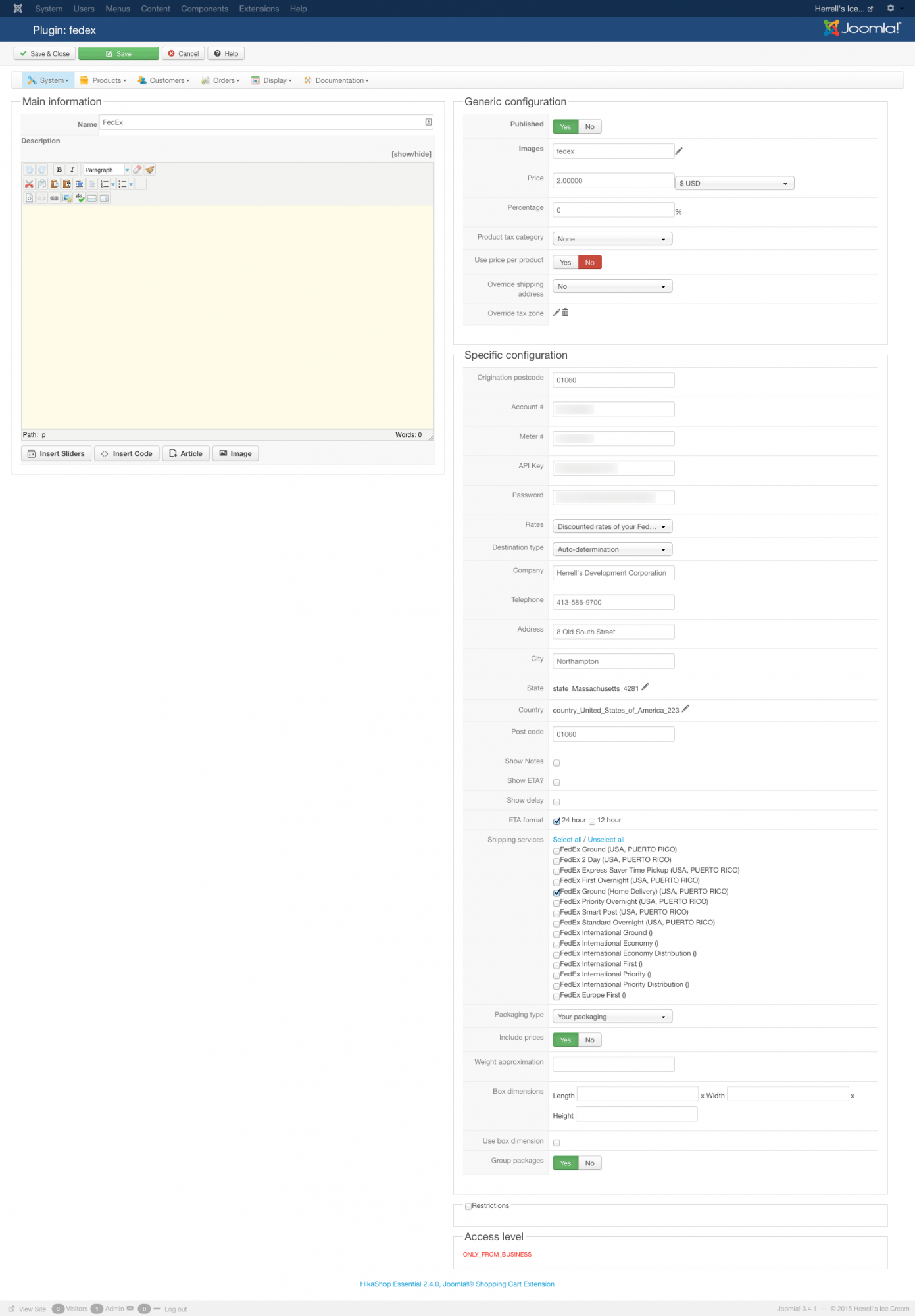

The handling fee is added into the FedEx plugin, as I mentioned. It is a flat fee per order, not per item. I've attached a screenshot showing the configuration. You'll see that the handling fee is $2.00, not $3.00 - that was just my mistake in my original forum post, and the correct amount is $2.00.
Thanks for any advice you can offer! Again, the fee is being calculated correctly, but we just need to display the handling separately from the shipping.
-Anne

Because the price is fixed and you're not using tax ; you can use a custom plugin to add an entry in the order additional.
Here a sample of a custom plugin using order additional (with a conditional value of a custom field).
www.hikashop.com/forum/checkout/872829-w...s-a-gift.html#179177
Thanks to that, you can specify the price you want to add in the order and also the label that you want.
The order additional is display during the checkout, in the email, etc.
So you do not need to override every elements to remove your $2 from the shipping to display it in another row.
