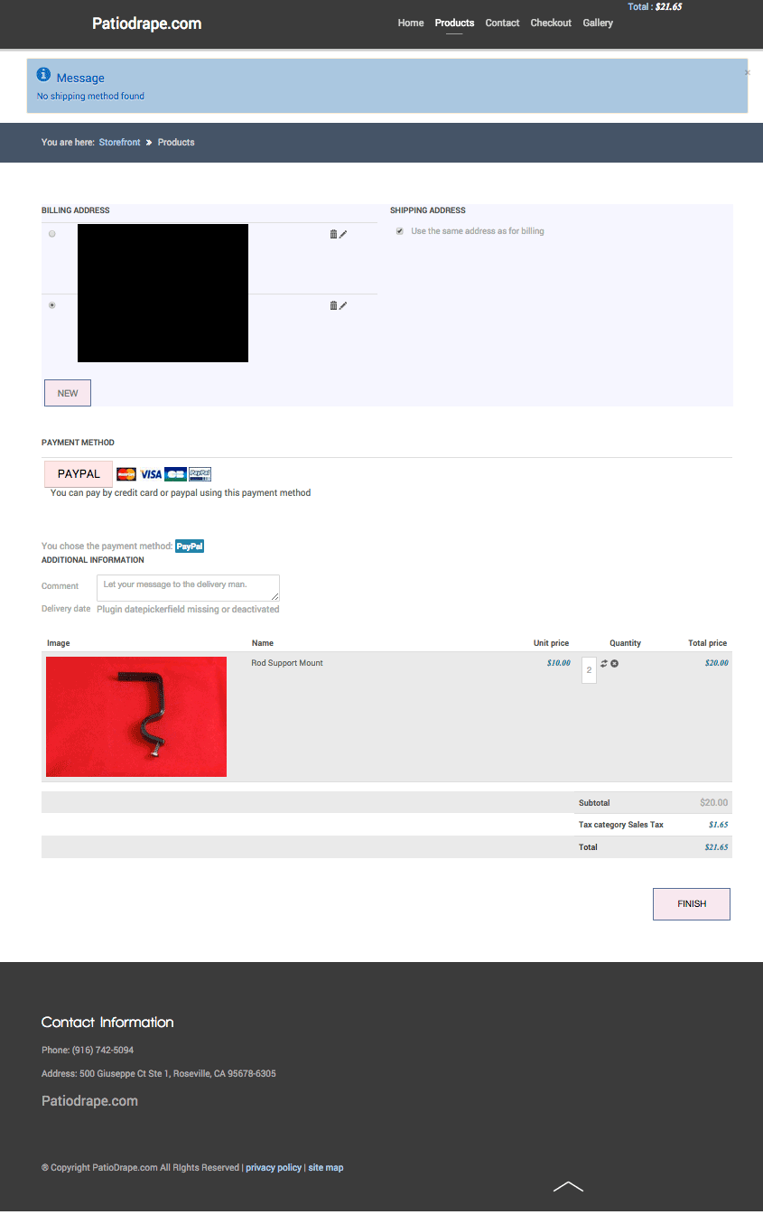

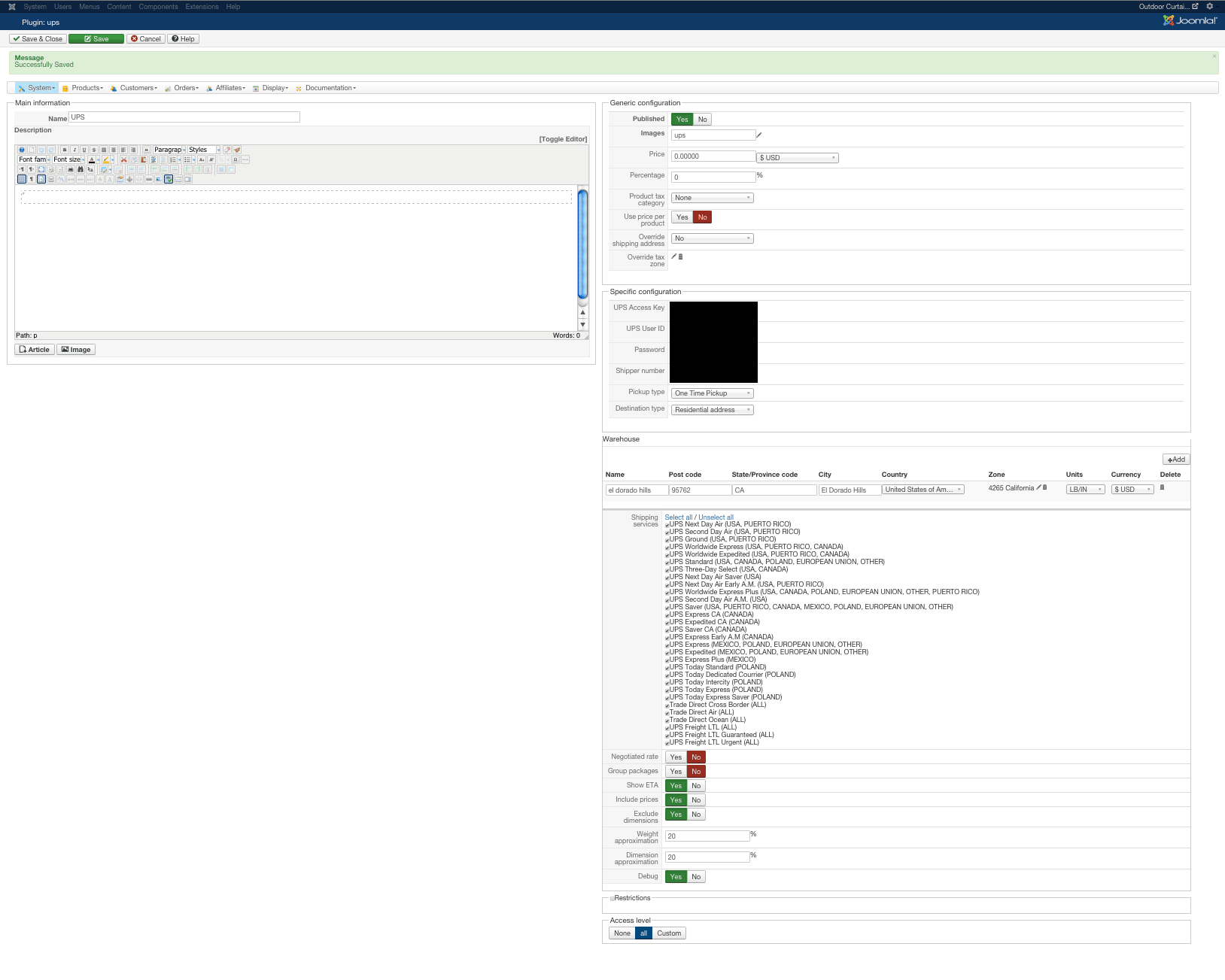

Attached are screen captures that might help. I had shipping working great and then after setting up taxes the shipping stopped working. I want the shipping calculated by the UPS shipping plugin. What did I mess up?

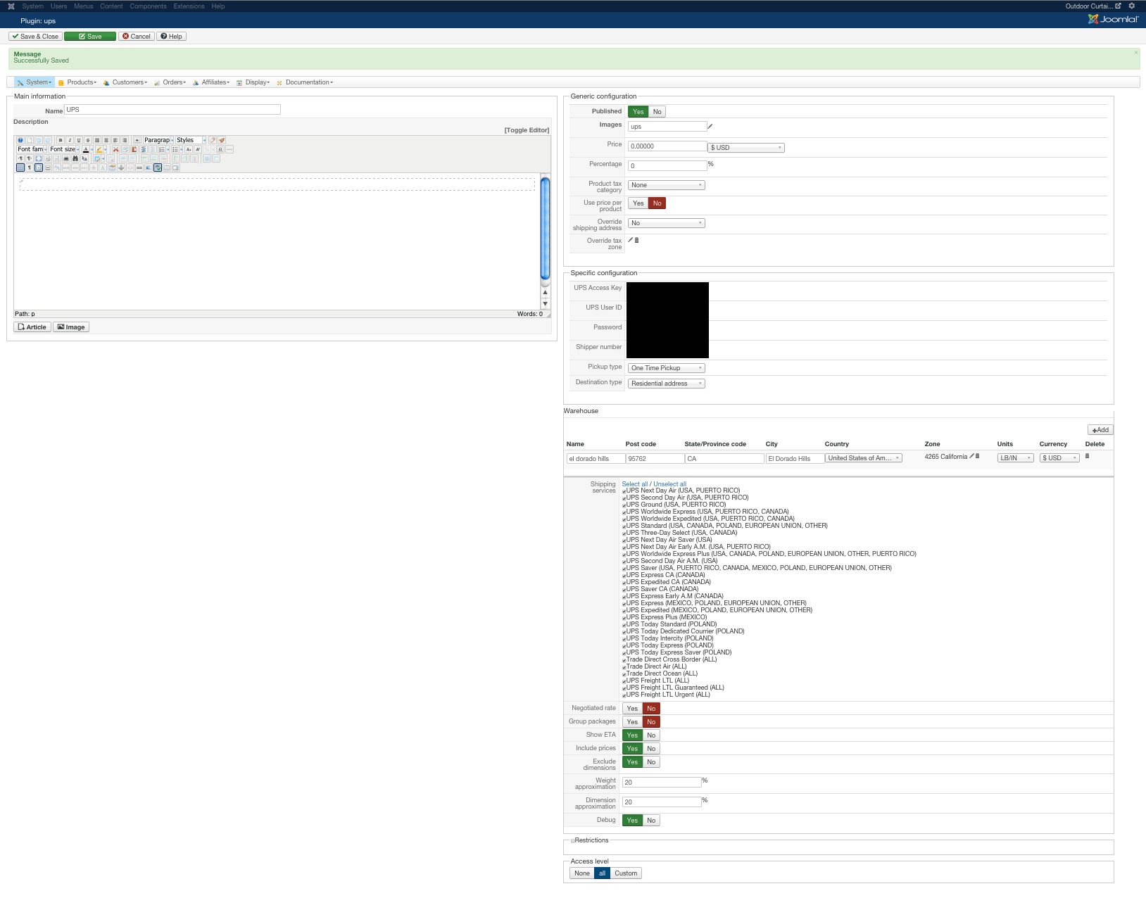

The way you configured your shipping method, it will only display if your address is in California.
I suppose that you want to remove the Zone that you selected in the warehouse area of your shipping method so that the shipping method can be used for addresses outside the zone that is currently selected.
  • Posts: 61
10 years 11 months ago #210420
that error message happens for addresses in california

  • Posts: 85916
  • Thank you received: 14126
10 years 11 months ago #210422
Please remove the Zone that you selected in the warehouse area of your shipping method. You don't want it.

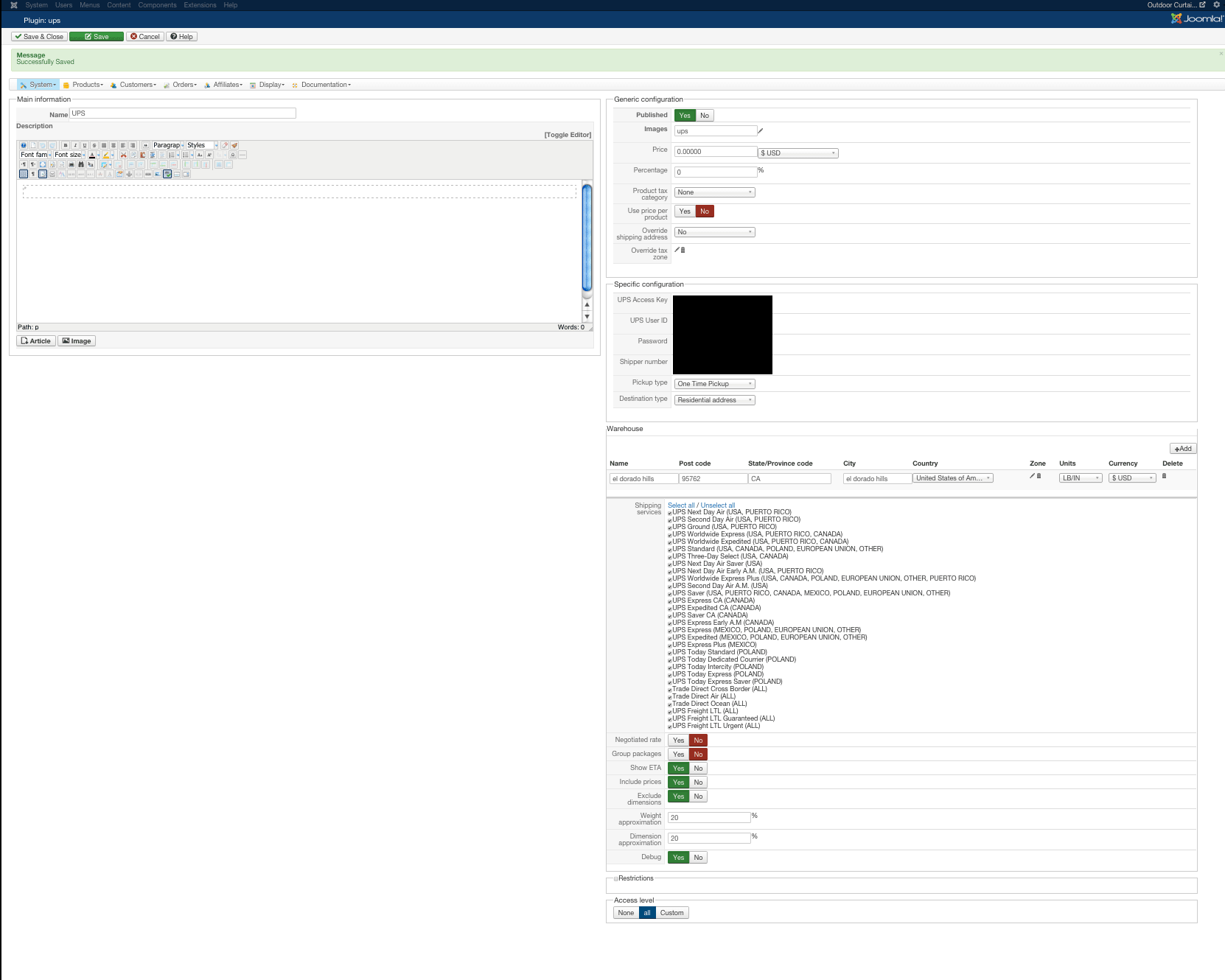

  • Posts: 61
10 years 11 months ago #210442
Still says "No shipping method found"
See the attached for settings verification.
