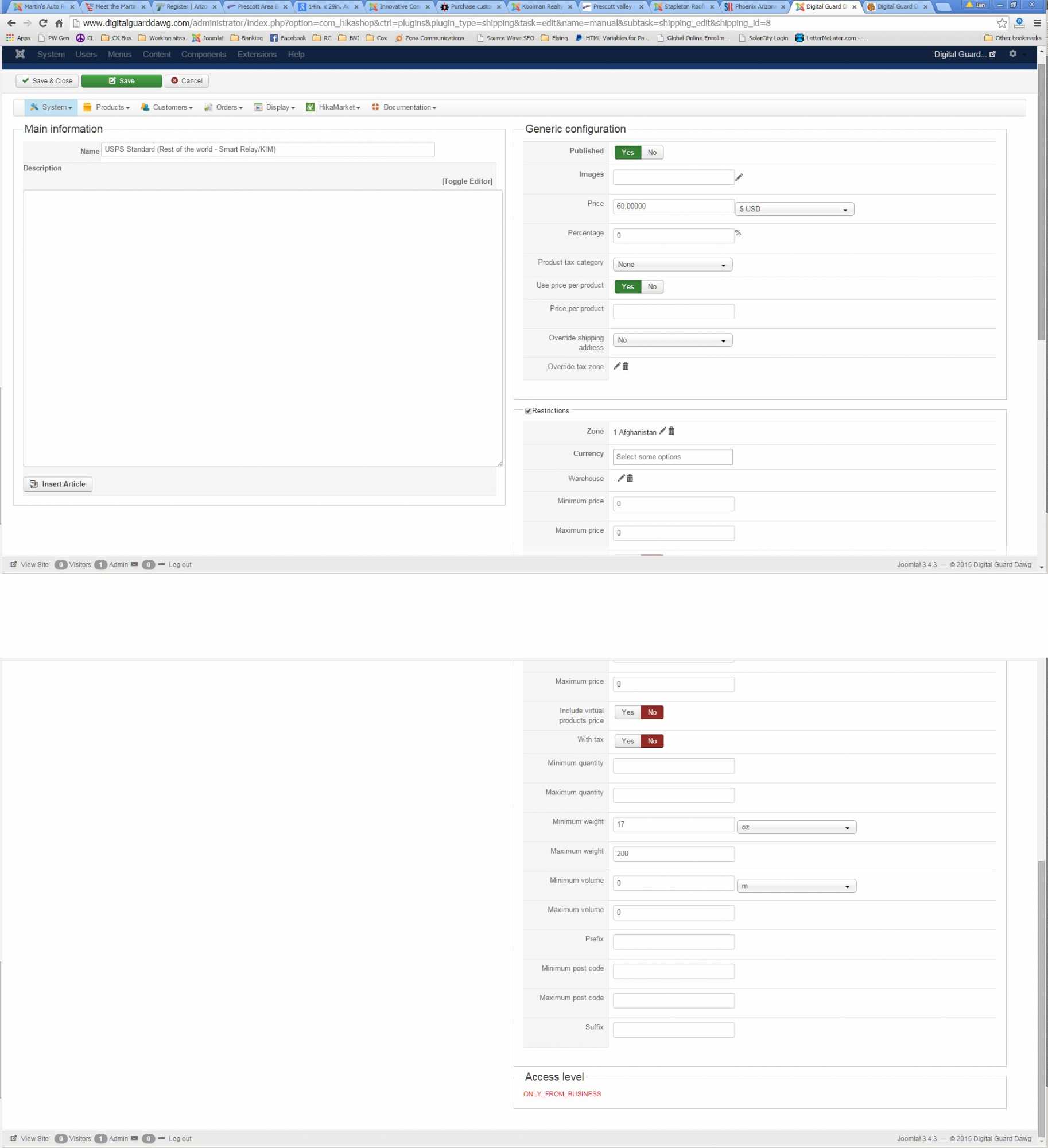

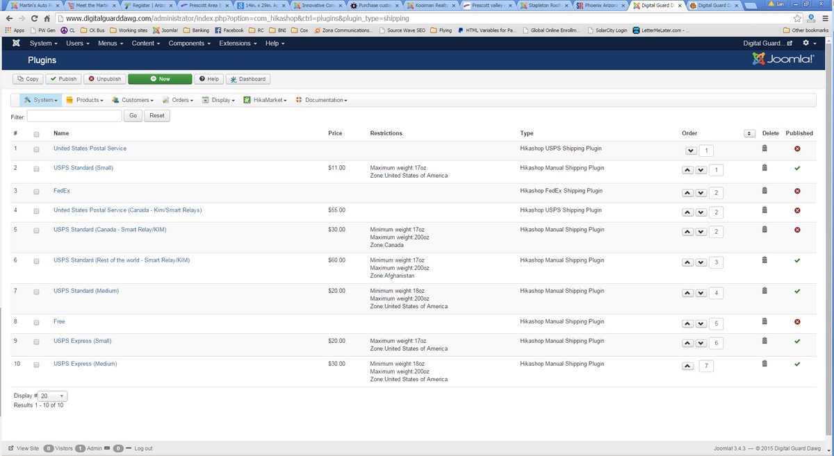

Because USPS and UPS "lookup" facilities just never seemed to work correctly, I added a manual shipping method (with the manual plugin) to "The rest of the world" being everywhere except USA and Canada. I assigned a min weight of 17oz and a max weight of 200oz. It is published.

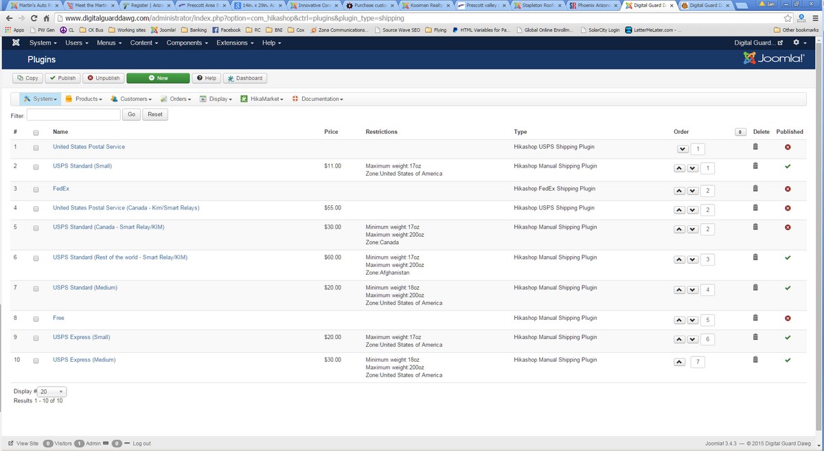

Can you tell me where do you exactly want to ship your products ? Because with your current shipping configuration, you'll only be able to deliver your products to :
- USA
- Canada
- Afghanistan
You didn't configured any shipping method by using the "Zone" option to ship your products to Australia.
