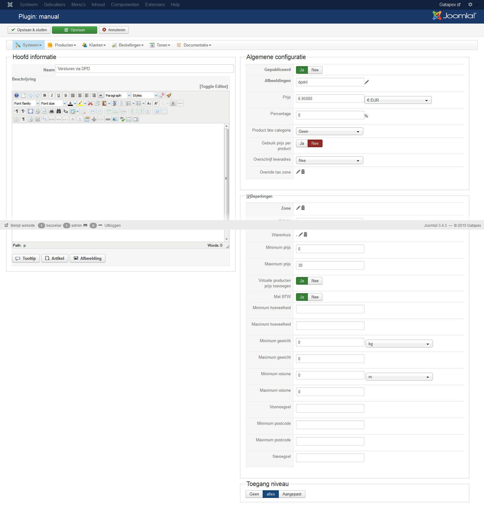

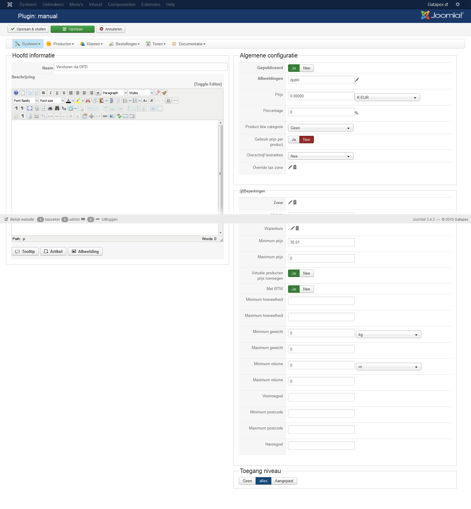

10 years 10 months ago #213096
Hi Jerome,
I am using "force the shipping regardless of the weight" but in the shipping methods I have also activated 'virtual product prices'. Attached you find the set up of both the shipping methods.
I hope you see what I am doing wrong....
regards,
Joost

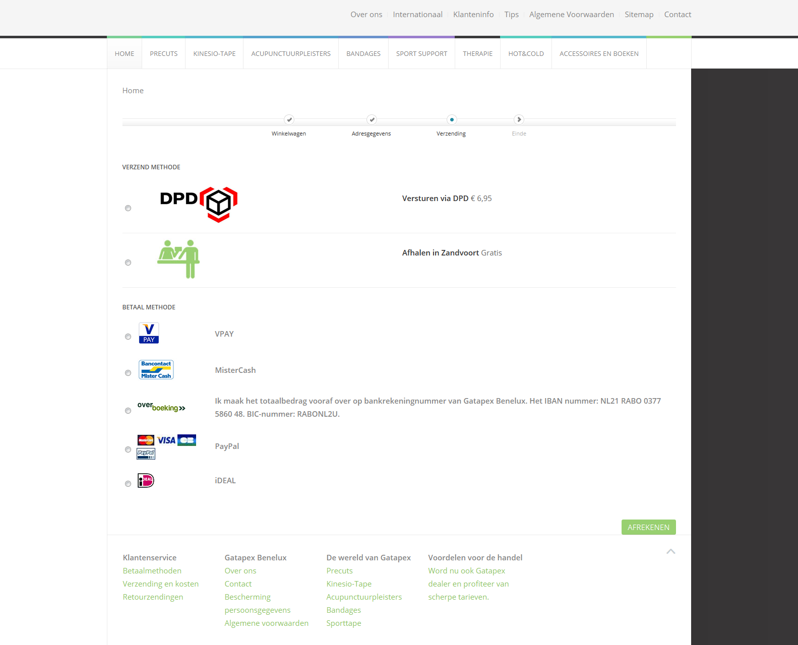

10 years 10 months ago #213125
Hello Joost,
Your free shipping method should actually be displayed for orders with a price above 30.01€, can you show me a screenshots of an example where your free shipping method isn't displayed ?

  • Posts: 62

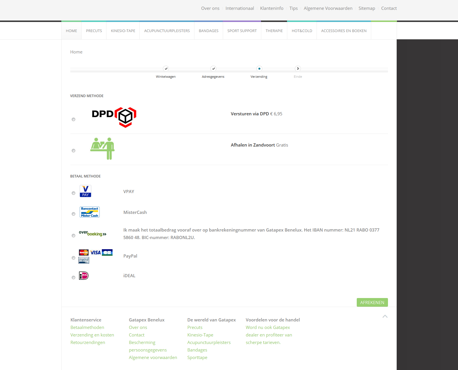

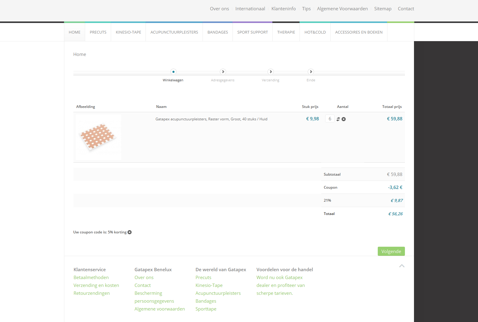

10 years 10 months ago #213194
Attached you find a screenshot of the cart and a screenshot of the shipping methods.
Is it clear to you?
regards,
Joost

10 years 10 months ago #213632
The issue was coming from the minimum / maximum price options of the shipping method configuration page. In fact, a wrong total price was used for these options through the checkout when we also had a percentage coupon on the cart.
I just fixed it on your end, but if someone have a similar issue, you should download the last Hikashop version through our website and install it again.
