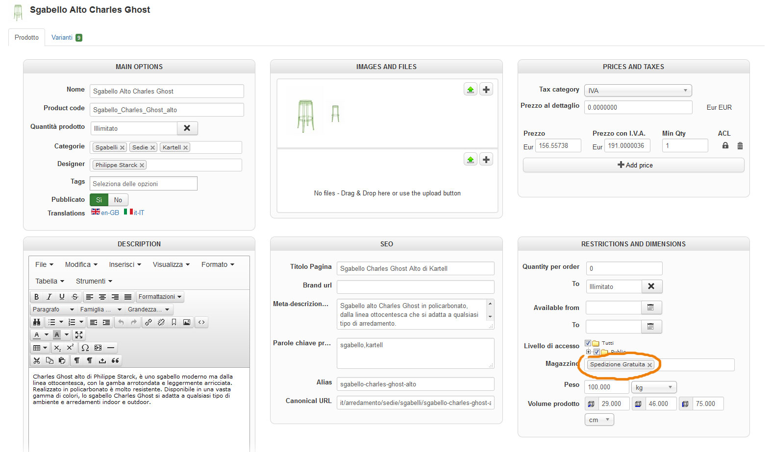

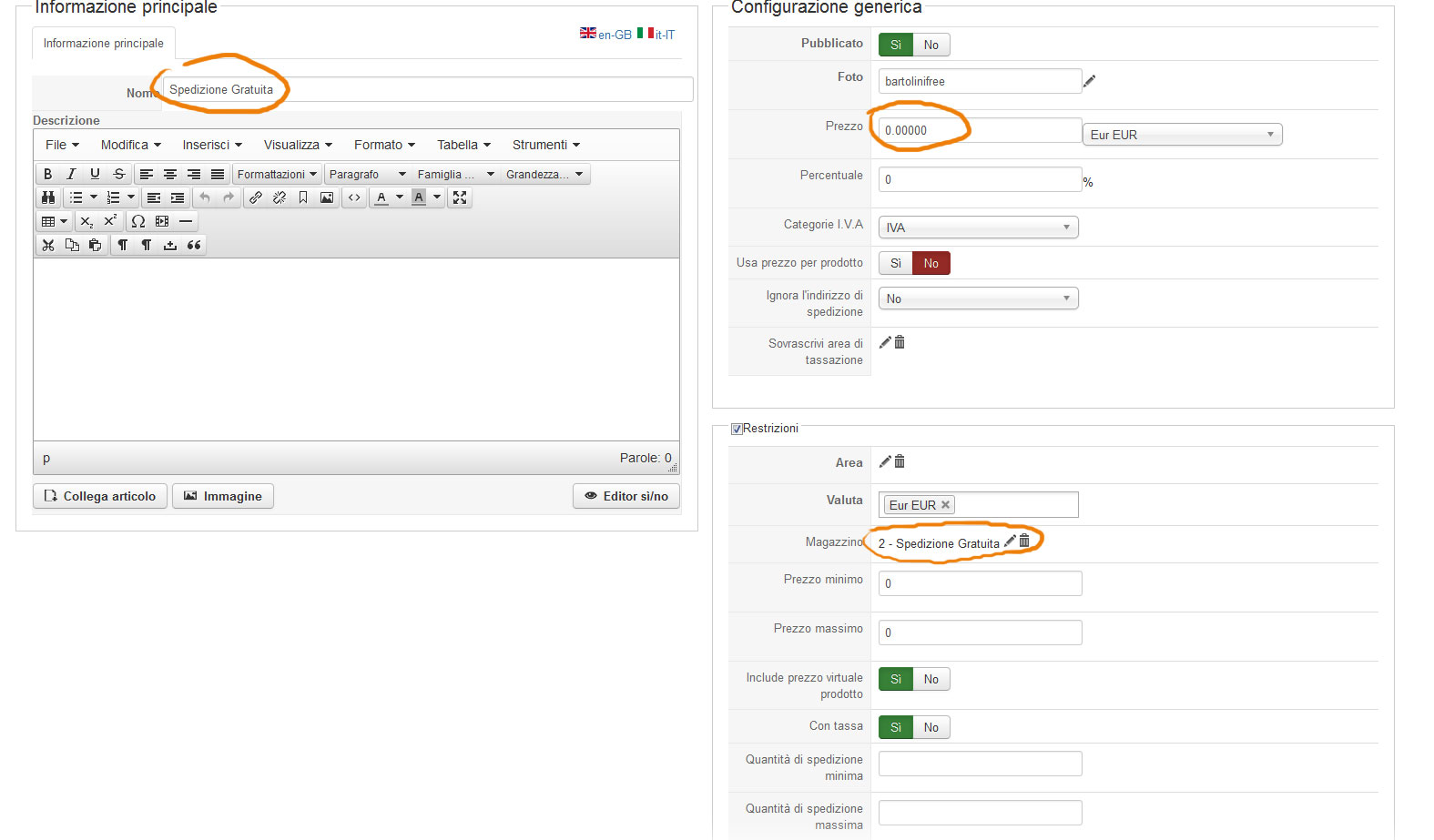

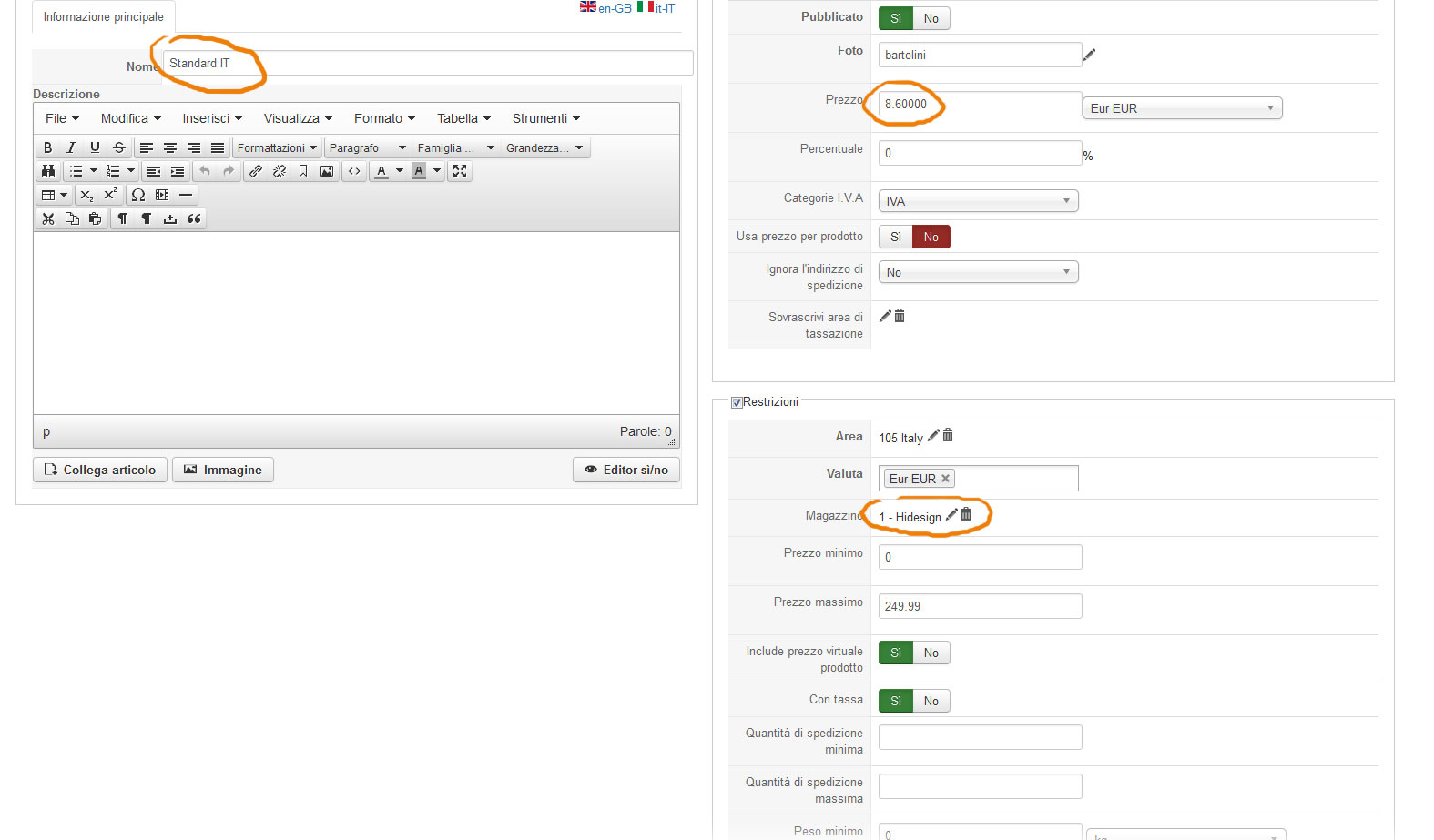

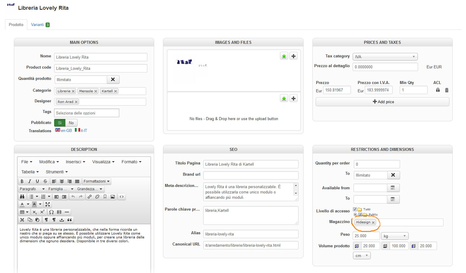

  • Posts: 251
10 years 11 months ago #215577
This setting is for shipping cost restricted to warehouse 1
This setting is for shipping cost restricted to warehouse 2
This product is from warehouse-1
ams20.siteground.eu/~hidesign/en/furnish...ria-lovely-rita.html
This product is from warehouse-2
ams20.siteground.eu/~hidesign/en/furnish...host-high-stool.html
If you try to buy the product from the warehouse-2 you should have free shipping, but is not so.

  • Posts: 251
10 years 11 months ago #215622
I have more than one shipping methods associated with warehuose-1(hidesign). PROMO 250 IT is one of these, Standard IT is also one of these.
But the shipping method associated with warehouse-2 (Spedizione Gratuita) is only one, and it is Spedizione Gratuita.
So purchasing the second product "Sgabello Alto Charles Ghost" you should have the shipping cost "Spedizione Gratuita", instead you get PROMO 250 IT or other shipping cost associated with warehouse-1(hidesign).

10 years 11 months ago #215630
I just tested it with the "Sgabello Alto Charles Ghost" product and the only available shipping method was "Standard IT". Can you give me a temporary access to your back-end so that I can directly test it ?
Note that you can send it through the contact form : www.hikashop.com/support/contact-us.html
Thanks.
Last edit: 10 years 11 months ago by Mohamed Thelji.
10 years 11 months ago #215756
I just tested it on my end with the SAME configuration and it worked fine. Your issue seems to be coming from the fact that the variant of your "Sgabello Alto Charles Ghost" product aren't correctly analysed, in fact, when I manually create another product with variants, it's working fine.
Can you also test it with another product that you'll manually create ?
  • Posts: 251
10 years 11 months ago #215815
Ok, I tested different products and I noted that it doesn't works with all the products with variants. Instead works perfectly with the products that don't have variants. That's a big problema, because the most part of my products have variants.
It's possible to fix that issue?
Thank you so much.
I don't know if it's important but I want to say you that I have assigned the warehouse using a mass action, to all products.
