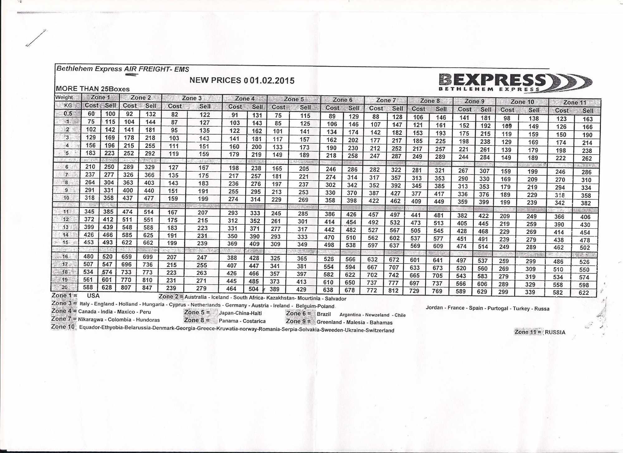

I have added manual shipments up to 10 kilos: Example:
0 - 1 = 10 USD
1 - 2 = 12 USD
9 - 10 = 30 USD
So when I use 11 Kilos, I want the following to happen:
1 Box: 10 Kilo = 30 USD + 1 Box: 1 Kilo = 10 USD
So it should be total of 40 USD
Because shipping price list reaches 10, then you need to increments. (Maximum box is 10 Kilos). I can't find anyway to do this.

The problem is I have 13 Zones, and 21 different weights (500 grams increments) that covers weights from 0 - 20 kilos (these are around 270 entries).... The way it works is that after you reach 20 kilos, this means you will start filling a new box and start again.
Of course this can be solved the way you are suggesting but that means I will have to add another 279 entries to cover up to 40 kilos, and I need to reach up to 100 Kilos, so that means I will need to enter thousands of records, and the issue is that even if I add them, and teh rates change I will have to edit these thousands of records.
Please see attachment to understand:
Last edit: 10 years 10 months ago by bahakh.
