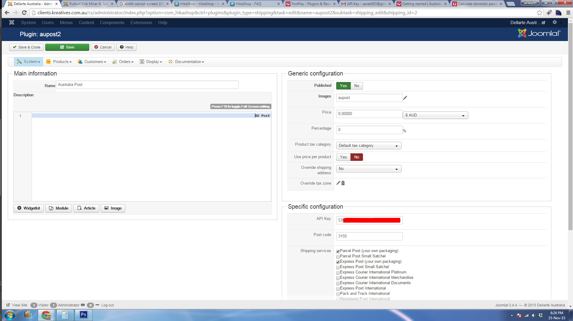

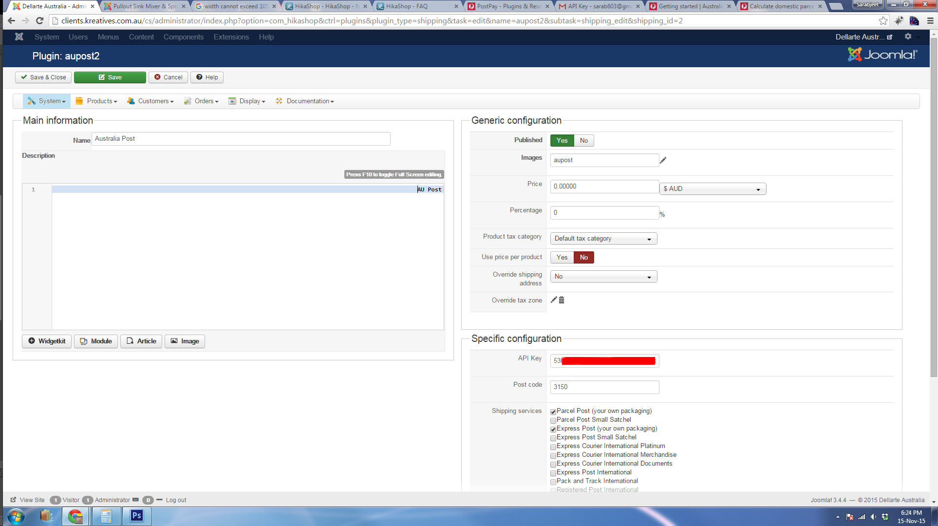

-- Joomla version -- : 3

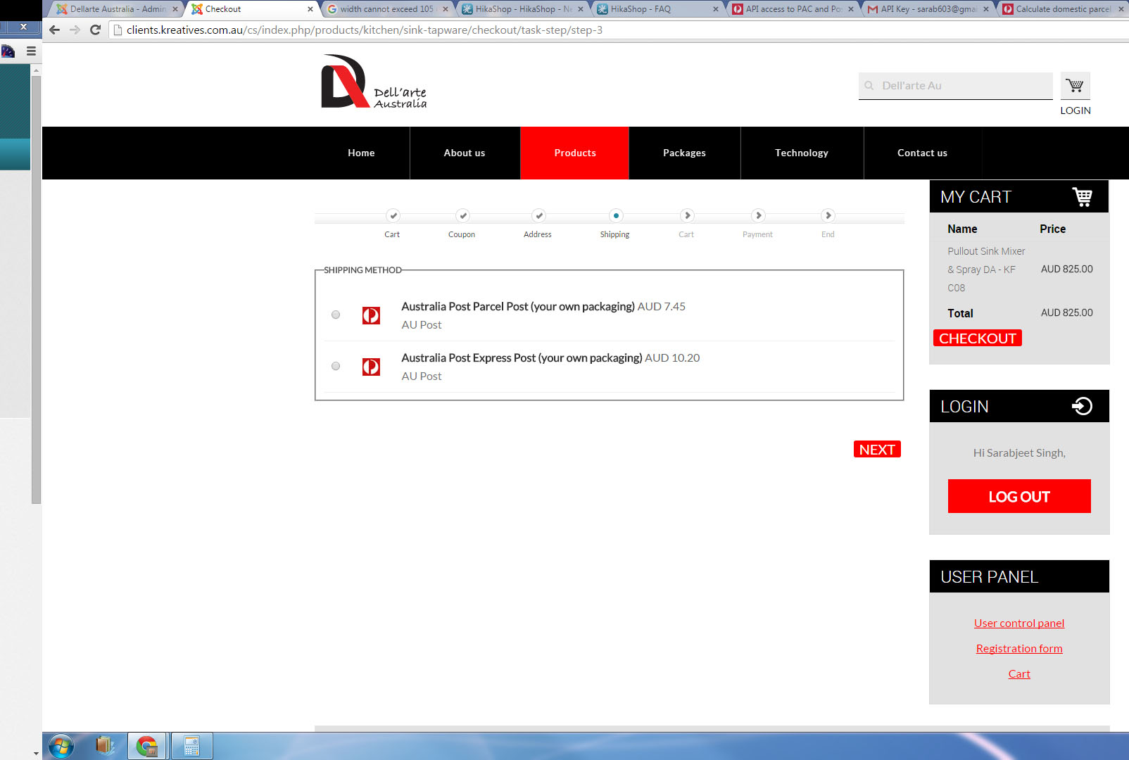

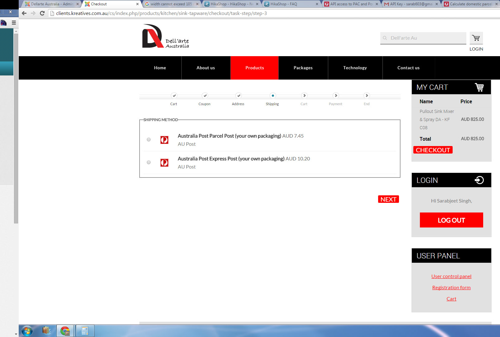

I am using Aupost V2 Plugin and the plugin is calculating the price as $7.45. the prie calculated by au post is 30.45.
I wish to group the products together
I got my api using: developers.auspost.com.au/apis/pacpcs-registration
Can you please help me, I have attached snapshots

It is not just grouped products that have the problem. If we add just one product to the cart, under V1 the freight returned is $18. The Aus Post website returns $18. But the V2 plugin returns $7.45.
