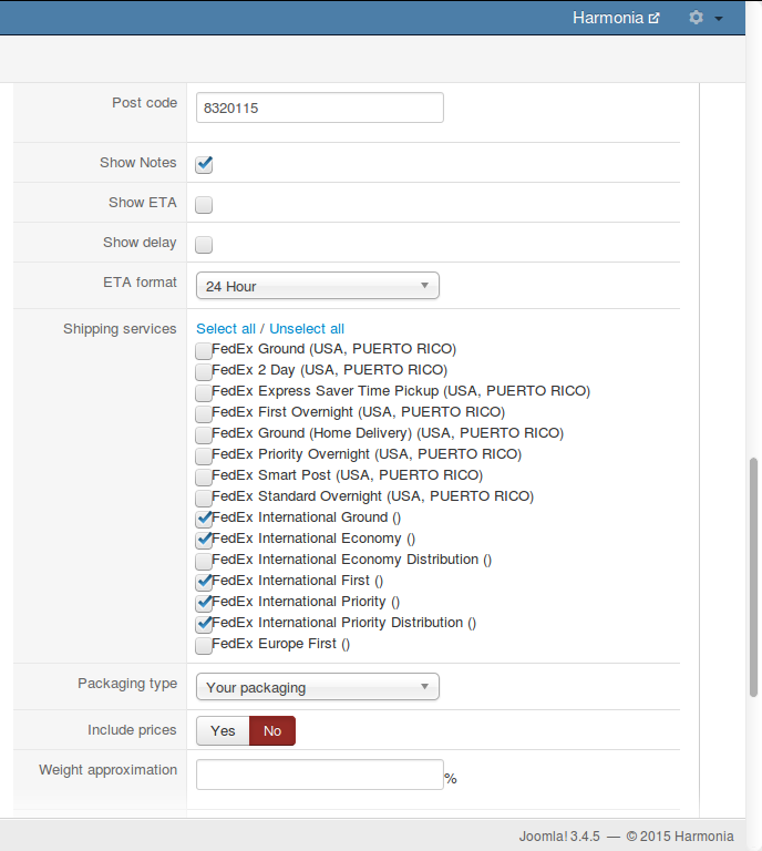

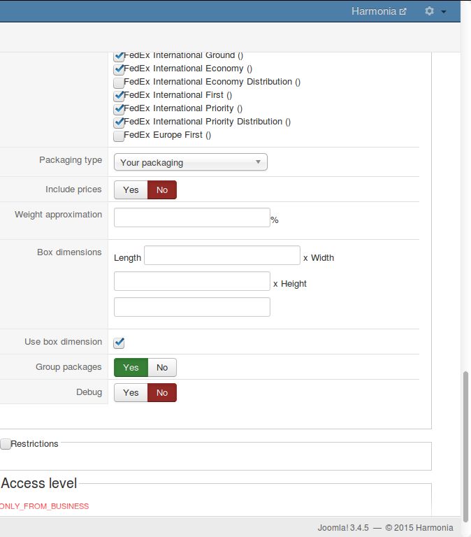

Hello to everyone,

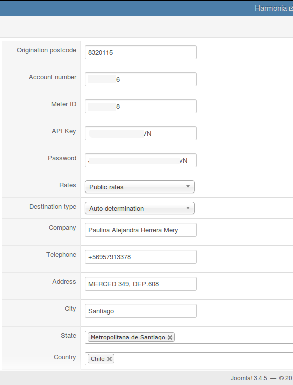

i am trying to implement Hikashop en Chile (starting with a starter version),
but i can not solve one problem with Fedex plugin by my self so i am kindly asking
for help from more experience fellows.

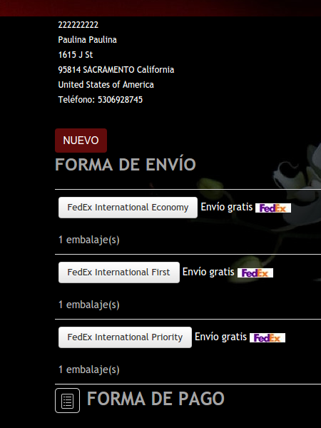

When i send from US address to US address everything is fine !
But when i send from Chilean address the prices are not showing at the Checkout, only number of packages,
maybe because Chile doesn't have any STATE with 2 digits code like California (CA) or other states ?
How to fix this ?
Best regards

  • Posts: 6
10 years 9 months ago #221495
Thank you for your fast response Nicolas,
if i leave State code empty it is not working, it gives me an error:
'StateOrProvinceCode' => '',
'Code' => '825',
'Message' => 'The routing code was derived from the city for the origin. ',
:dry:
