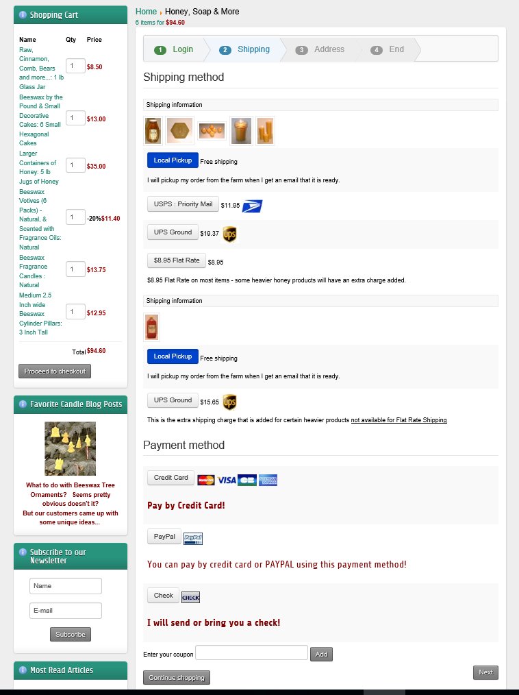

10 years 8 months ago #225014
Thank you for your assistance - I think I have it set up mostly the way I wanted using 2 warehouses - a "standard flat flat rate (which most every product is in and a "heavier" warehouse for the few heavy products.
One question - attached is a screenshot of a checkout. Local Pickup seems to be the default for both shipping warehouses. Can I make something else default like ($8.95 Flat Rate for the top one) and (UPS Ground for the bottom one)
Just for info - I have the "local pickup: shipping set to no warehouse - is that ok? But I need it for both. - do I need 2 of them?
NICE PROGRAM - BY THE WAY
BILL
10 years 8 months ago #225060
Yes, to do that you'll just have to change the ordering of your shipping methods via "Hikashop->System->Shipping methods" to :
1 - Flat Rate
2 - UPS
3 - Local Pickup
Also, if you didn't set any warehouse for the "Local Pickup" shipping method it will be available for both warehouses, which is what you want.

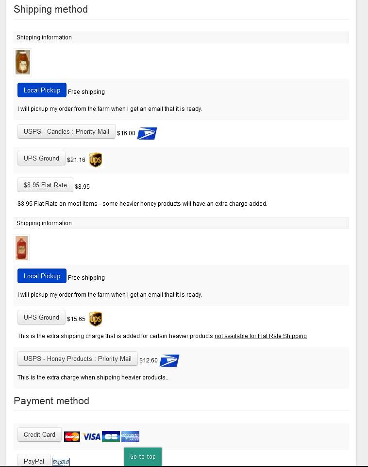

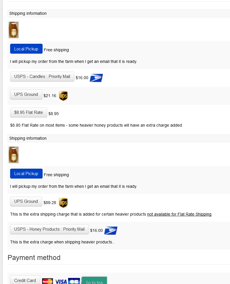

Now I am working on another problem with shipping. It involves a problem product file and UPS shipping.
The image above shows a checkout with two warehouses. The top part is a 12lb product with my Flat Rate Warehouse (A). It shows a UPS shipping of $21.16.
The shipping below is a similar 12lb product from by "heavier" warehouse (B) - It shows a much higher, not accurate shipping rate of $89.28.
Below is the same checkout but a different product (still about 12lb) from a different page but still in my "heavier" warehouse (B) - The UPS charge looks normal at $15.65.

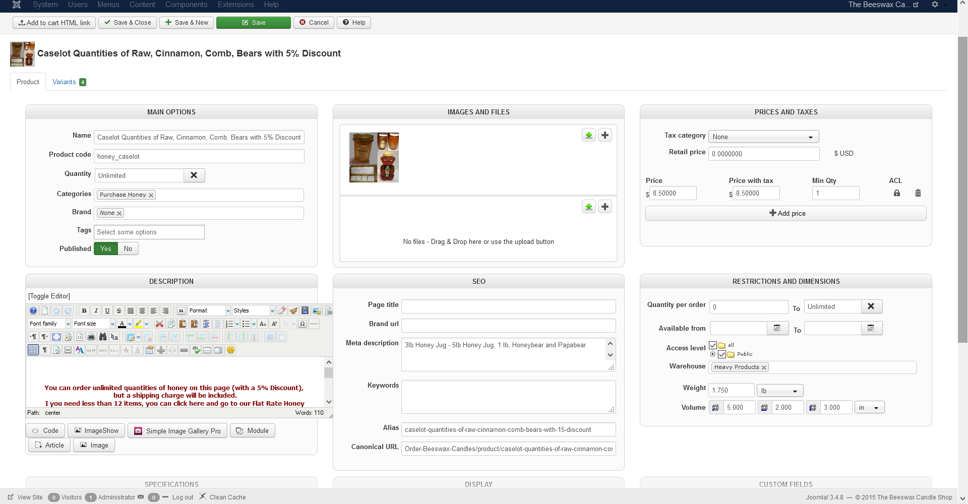

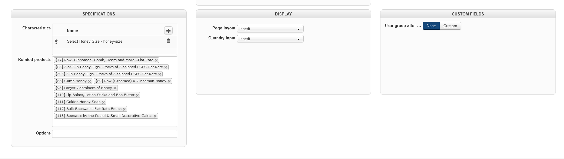

I must have some problem with this page: beeswaxcandleshop.com/Order-Beeswax-Cand...ith-15-discount.html - This is basically a copy of another page with a few modifications.
Below screenshots of the backend of the page:
I am baffled :( - I even created a new item - with nothing there except price, weight and put it in "heavy" warehouse and then tried orderd 10 of them (about18lb) and the UPS charge was about 5 times normal. I could see no difference from the one that is working properly in the same warehouse.
Last edit: 10 years 8 months ago by bigfoot. Reason: more info
  • Posts: 86178
  • Thank you received: 14214
10 years 8 months ago #225168
Would the problem come from the dimensions or the weight of the product ? Or maybe of the variants of the product ? Trying editing them in the Variants tab when you edit the product in ordrer to check on that.
