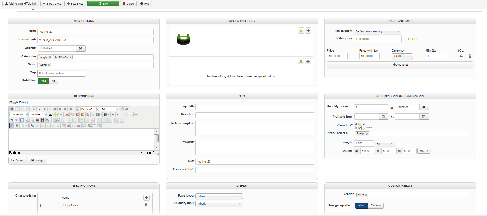

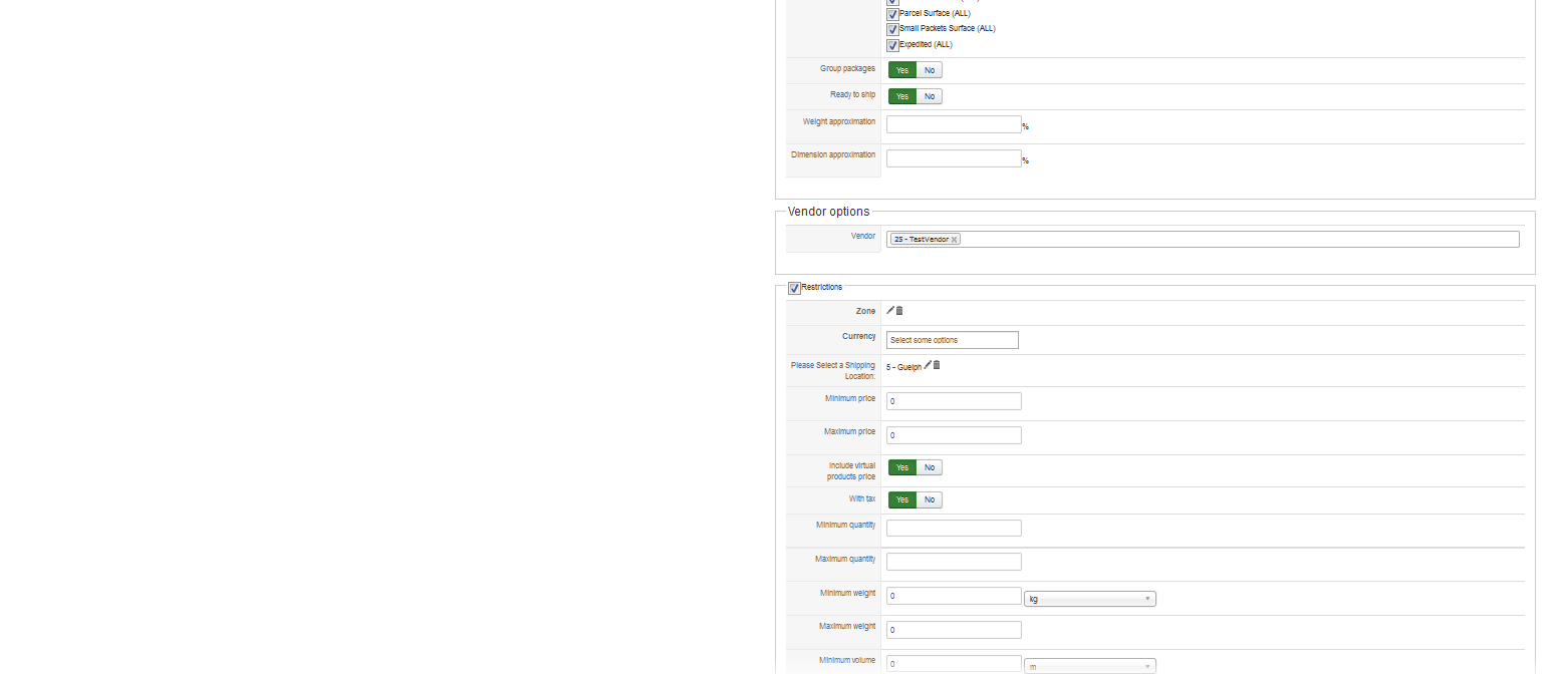

I Know there have been many posts for this already but i have read through all the documentation and every other posts and cant for the life of me figure out why I am getting this error.
Pictures attached to show the settings i have.
Thank-you for the help in advance

Your product isn't assigned to a vendor but your shipping method is only for the products of the vendor "TestVendor".
So it's normal that this shipping method isn't used when you try to purchase that product.
