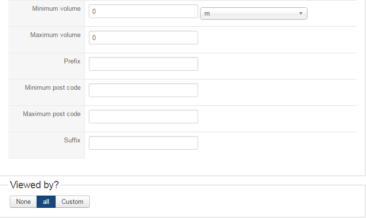

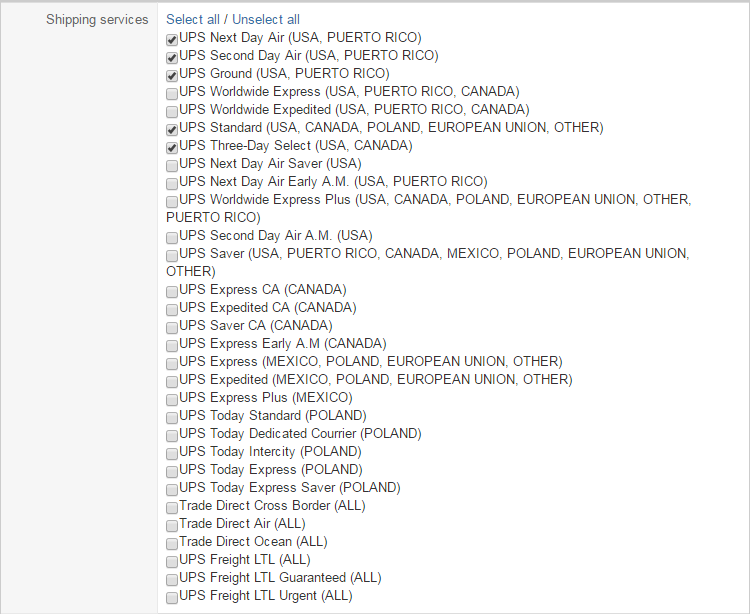

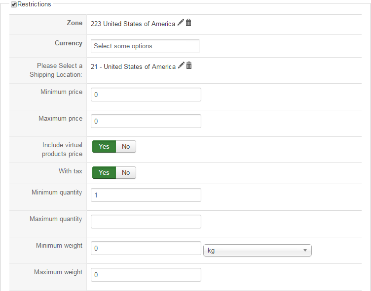

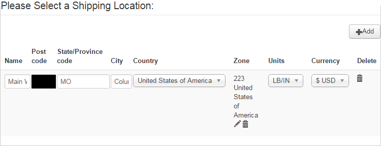

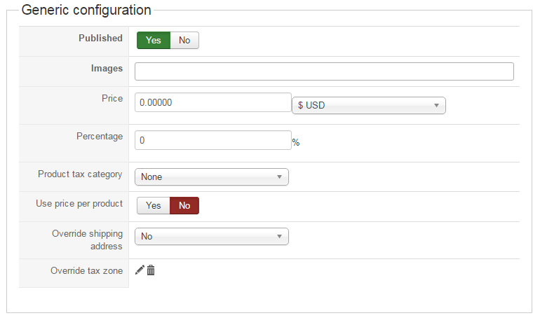

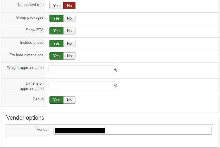

  • Posts: 15
10 years 4 months ago #239941

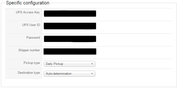

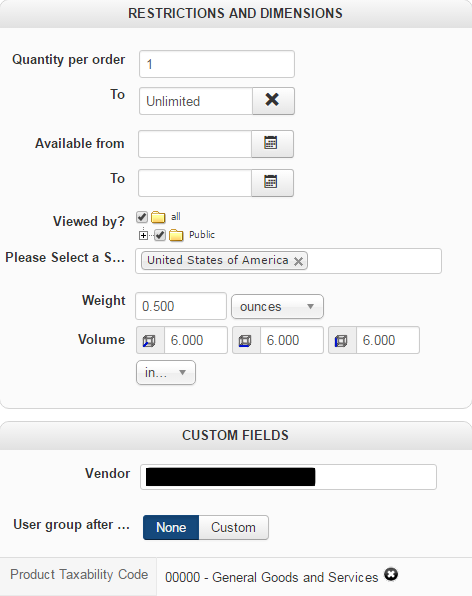

Yes, there is weight and dimensions on all the products. The products also have the vendor linked to them, as well as the shipping location. I have provided the screenshots of both the UPS shipping method as well as one of the products sold by the vendor (using the respective shipping method).

10 years 4 months ago #239942
I would first recommend to remove the several restrictions on the zone and warehouse in the shipping method and the warehouse in the product and see if that helps.
Also, even after removing these restrictions, the shipping method won't be found if the address of the customer in not in the USA so please check that it is the case.
