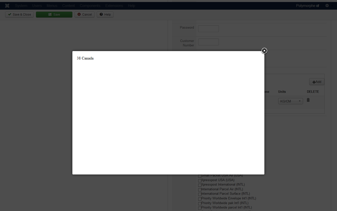

Basically when trying to choose a Warehouse zone, I click the pencil icon, choose the country or state, click the OK button and instead of putting the country I chose in the Warehouse zone params , the popup just stays open and displays the ID and the countries name, and that it (see attachment) . The value doesn't get registered , even if I close the window (obviously).

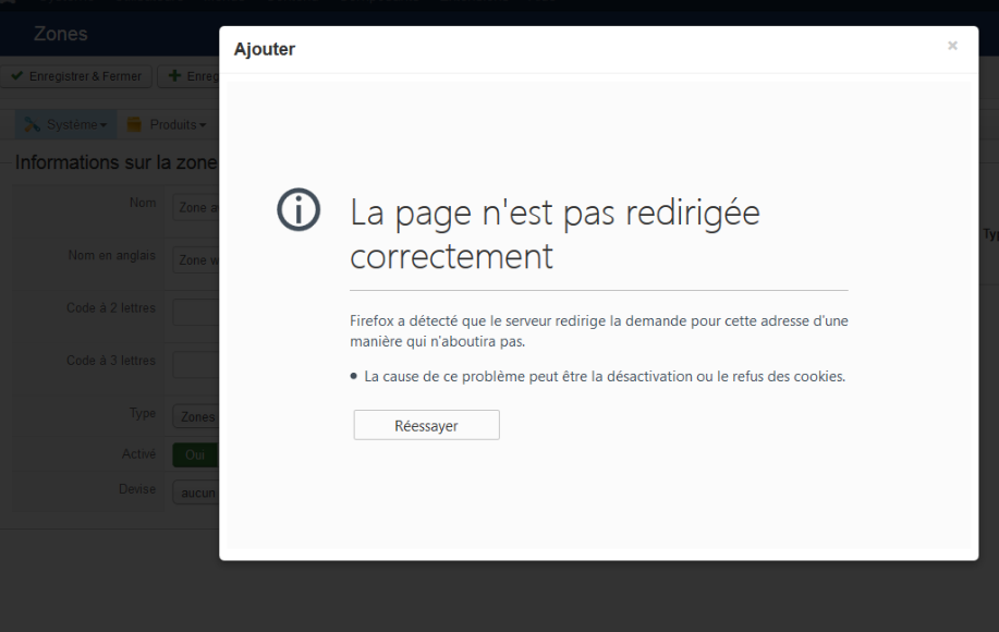

i have the same pb
When i try to ad a new contry in a new zone...

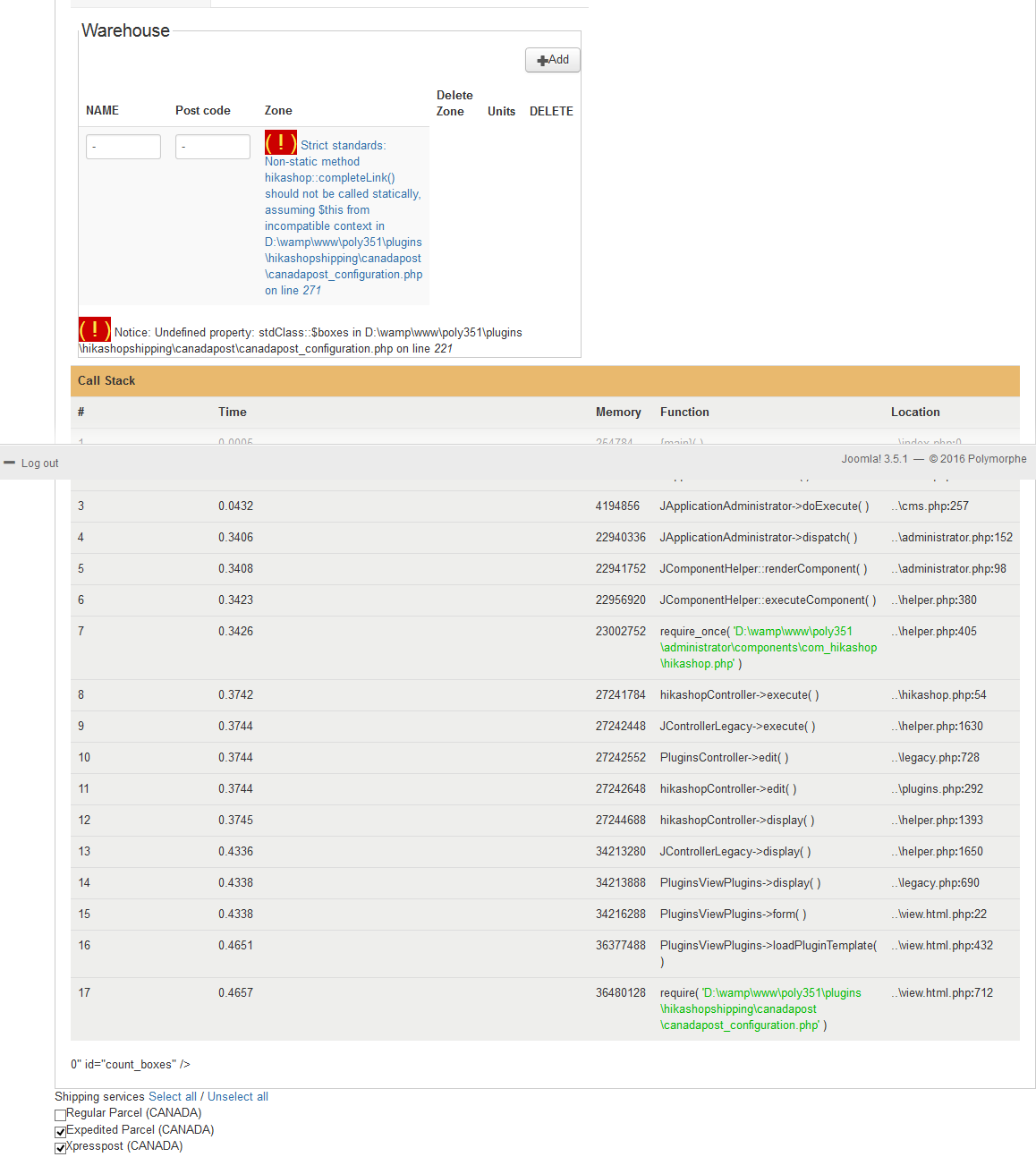

Ok I tried what you suggested , but none of the popup worked - in fact it seemed like the modal never changed style either ( same gui : close button) but I'm not sure. All I am sure is that I get the same result no matter what I set it at.
BUT, the error reporting has proven useful. (Please see attachment)
Now I already have contacted the dev for that plugin and upon testing, we realized it wasn't just a problem with this plugin, as I tested the UPS plugin's warehouse zone and I get the same result. ( Just to eliminate that possibility).

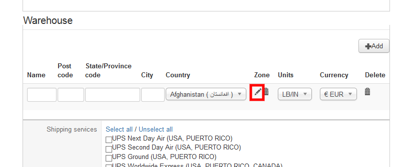

The plugin where you have Warehouse section params is the UPS one. (see attached)
I've noticed in the code Squeezebox is hard coded into the onClick event of the EDIT anchor tag.
I tried simply removing it, but, of course, that didn't work.
So i guess my question is:
How can I get it to use VEX popup, please?

You see, the UPS plugin > Warehouse section > Zone edit,

But did try and select a country and press OK ?
I never said the popup doesn't appear,
but the value you select in the popup doesn't get submitted after you press OK.
