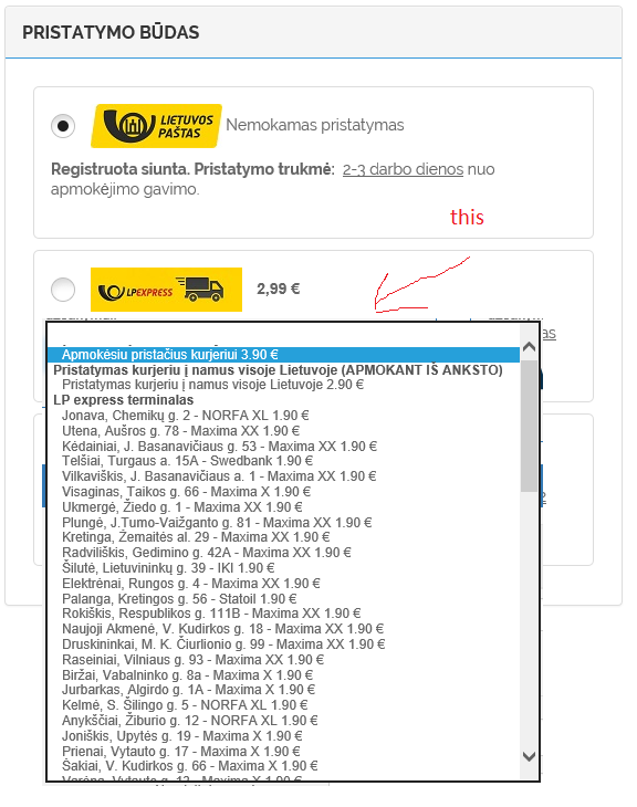

I have looked to shipping plugins and couldn't find anything what I need.
In our country we have very popular shipping method via terminals...and a lot buyers are asking for it. So I need shipping method where should be dropdown list with addresses/terminals selection. I should see this selection in back-end after order created as well.
How can I achieve this?

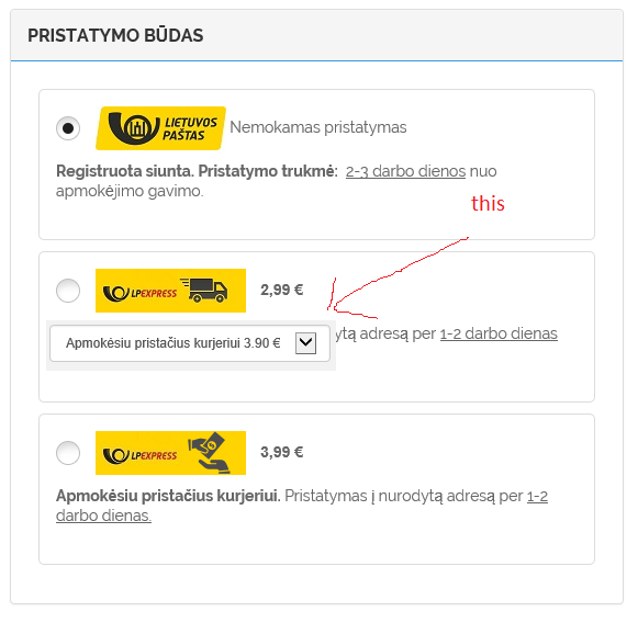

I have added some screenshots to be more clear. Basically it is same as per this thread, but I need only single selection. I also think this should be added to hikashop shipping plugin itself.
I could take one of hikashop shipping plugins and customize it to my needs but problem is that I don't know how to add it that these options/terminal addresses could be added in plugin so buyer could choose and after order, it should be shown in back-end order view so I would know which terminal buyer has chosen. Is there a easy way to do it?
www.hikashop.com/forum/shipping-methods/...st/reply/242202.html

What I am looking to is this:
Inside plugin to have some inputs where I could write addresses or it can be checkboxes as most shipping plugins have... Then these should be displayed on checkout in that shipping method. Dropdown or whatever.... After selection and placed order it should be visible in back-end order view. I think this is simple task for someone with better php knowledge then me.
So if it is possible could you please give me some simple example how can I have input label to be displayed in shipping method?
Or another solution to show table->order custom fields in shipping method?

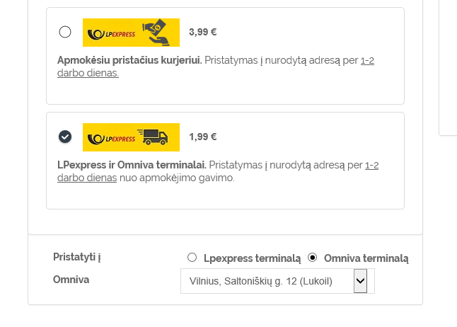

I have created one manual shipping method for terminals shipping.
In our country we have 2 shipping terminals providers. So I would like to use them both.
I am configuring custom fields like this.:
Created custom field with field type radio buttons, named it Terminal, with two values. First name Omniva, second name Lpexpress.
Then created custom field with field type single dropdown and named it Omniva and assigned it to custom field Terminal to value Omniva
Then created custom field with field type single dropdown and named it Lpexpress and assigned it to custom field Terminal to value Lpexpress.
So I would like that then people select terminal shipping they could choose to deliver parcel to Omniva or Lpexpress terminals.
Basically I have created switcher with single dropdown selection....
Now the problem is that this code provided will display field value.
$order = $app->getUserState( HIKASHOP_COMPONENT.'.checkout_fields',null);
echo $order->XXX;
And I will have to echo two custom field names. echo $order->Omniva; echo $order->Lpexpress;
As I don't know which courier buyer will select.
I have attached some screenshot how it looks.
And it will display like this:
Your shipping method is: Omniva terminal >selected Omniva value title here<>default value of Lpexpress<
How can I just display selected value based on custom field radio button selection and get rid of that default second value which is not selected by the buyer...
I know I could just create two shipping methods and it will be much easier to configure but maybe there is a way to have what I want.
Kind Regards

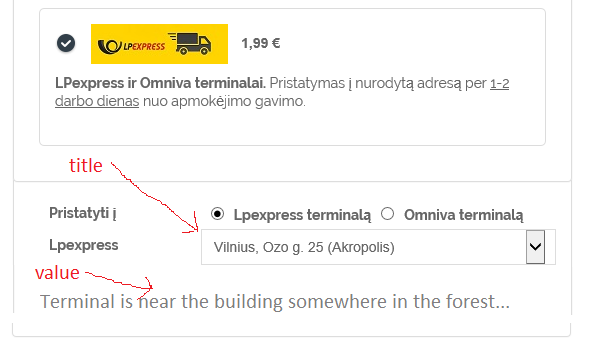

2. Update:
It seems I need another coding help with it.
I would like to split address in two fields as some of them are long enough.
Example of address:
Vilnius, Long way 7 (Central post), Lt-04208, Terminal is near the building somewhere in the forest...
So in custom field I would like to enter like this:
Value: Terminal is near the building somewhere in the forest...
Title: Vilnius, Long way 7 (Central post), Lt-04208
In single dropdown selection we see title as selection. So is there a way to echo value in field view or custom_field view based on that custom field title selection? Attached image to be more clear.
I have seen this feature on some prestashop sites and would like to add it too.

10 years 2 months ago #243150
I think that you need to create new custom fields of the type "custom text" with their "display limited to" setting configured to only display for one of the choice of the Lpexpress field. That way, the system will switch from one custom text to another without even one line of code.
