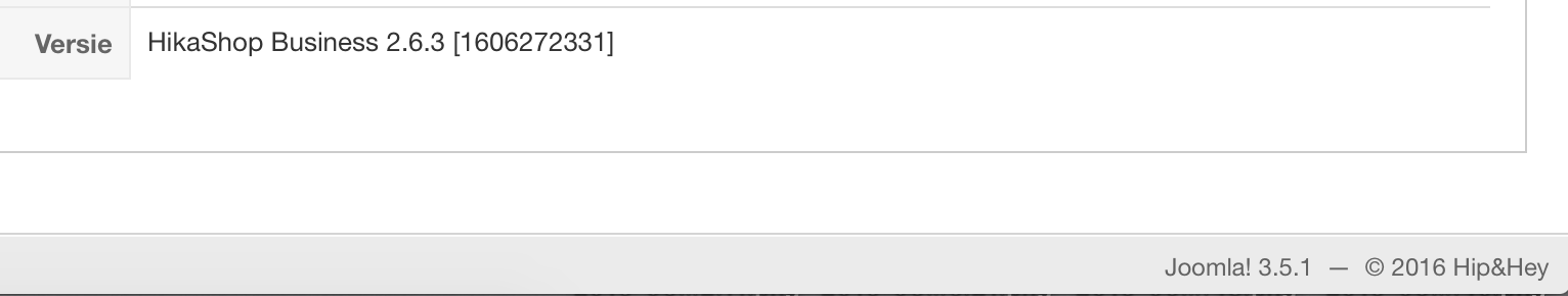

10 years 2 weeks ago #244132
Goodmorning,
I have installed the latest version of hikashop and joomla.
But i still get the same error.

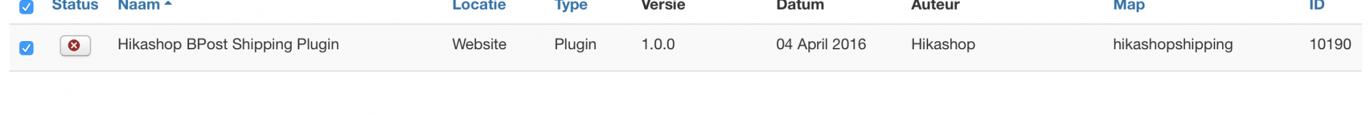

The bpost plugin file that i use is this one:
github.com/HikaShop/hikashopshipping-bpost/releases
Is this the right one?
Kind regards
Bram

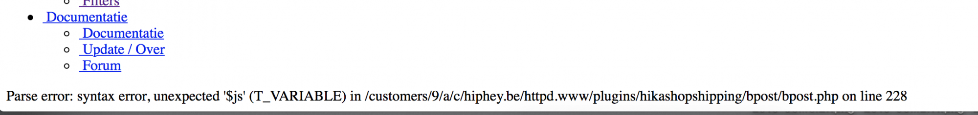

I get some weird error that has to do with the code on line 228 of the .php file
Kind regards
Bram
  • Posts: 26366
  • Thank you received: 4069
10 years 2 weeks ago #244193
Thanks for the report. I fixed that typo.
You can replace the line 227, from
$current_page = hikashop_currentURL
To
$current_page = hikashop_currentURL();
in order to fix that copy/paste mistake.

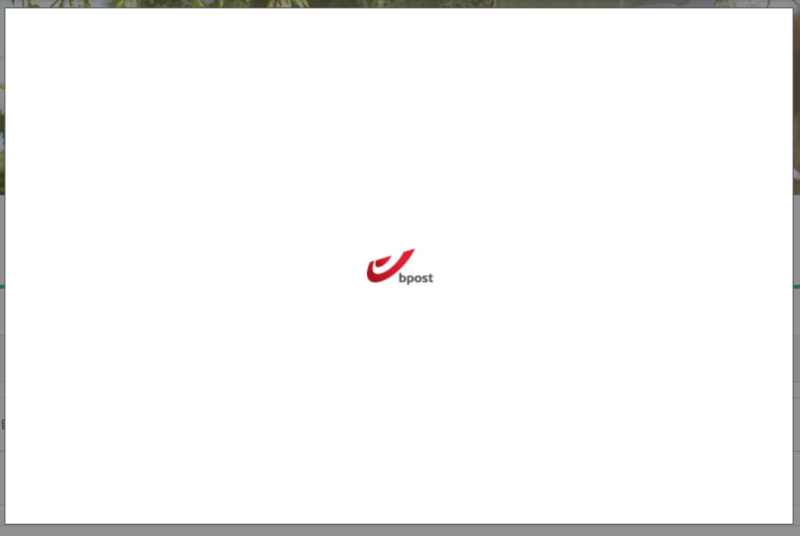

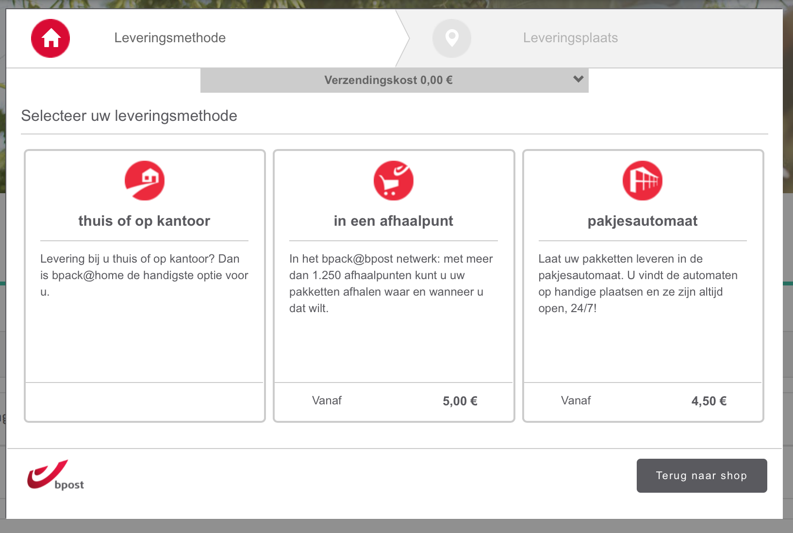

  • Posts: 17
10 years 2 weeks ago #244259
Good morning,
I'm still experiencing problems with the shipping manager.

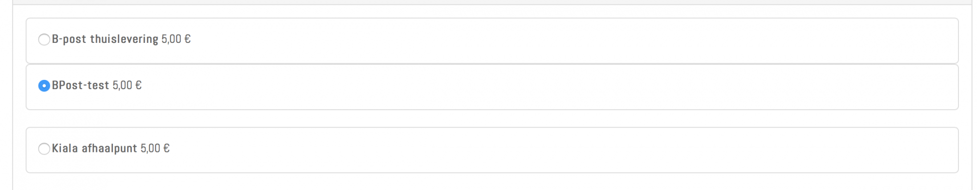

In the old version it went like follow:
Client add product to cart
Client goes to checkout
Client selects shipping method:
Client then would get the following screens:
and then could select from the b-post menu
this was all happening using the old version of the plugin:
Now with the new version, well nothing happens it just send me back to the shipping method selection screen from hikashop. It doesnt show the bpost screen where client can select en order the way of shipping.
I am doing something wrong?
Kind regards
Bram

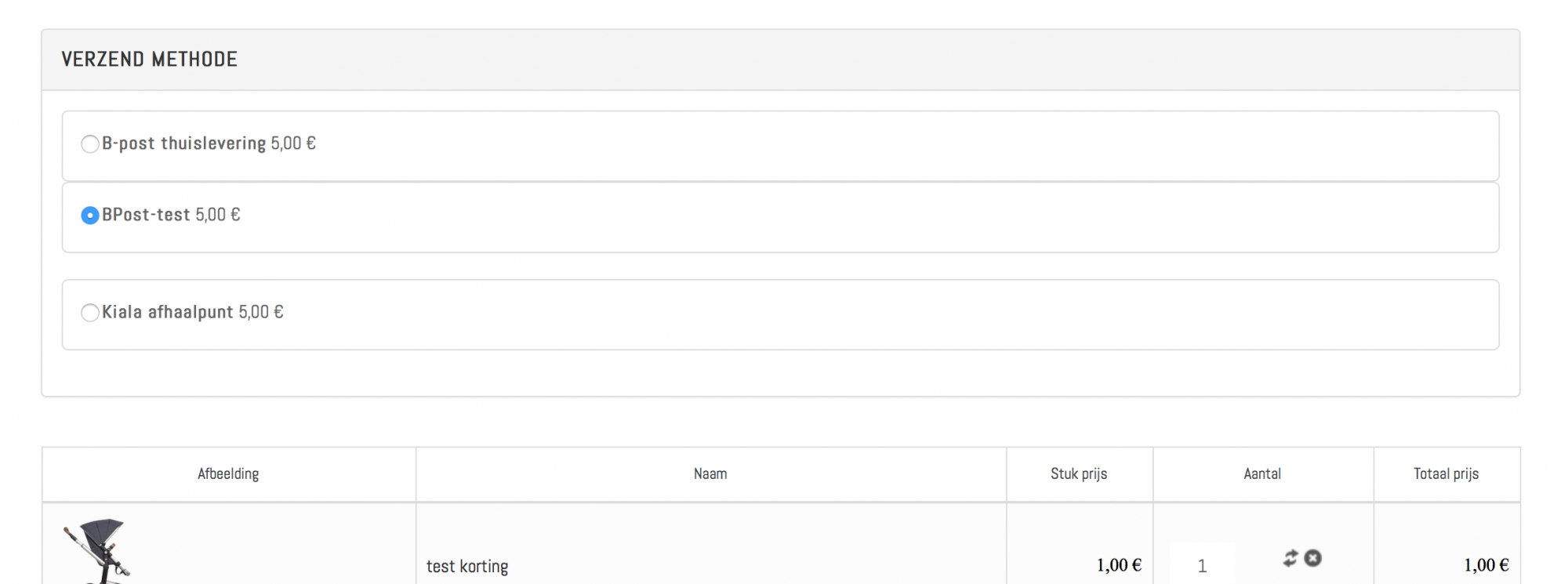

  • Posts: 17
9 years 10 months ago #248851
Ill explain a bit better now.
What i have is that if people buy goods for lets say 50€ they get free shipping. If they have less the 50€ they pay shipping costs.
I have that set in Hikashop and that works great. But when bpost SHM comes in, well it doesnt care what the shipping price is. It just forces the price you have set in the Bpost SHM.
Bpost SHM also doesnt include an option to set if jou buy for certain amount, you get free shipping. And if you buy for less then that amount you pay shipping costs.
Thats the problem i have and some other people might have to.
Kind regards
Bram
9 years 10 months ago #248903
Ok I understand what your needs, so as Jerome told you you have to edit your bpost.php file.
Find your "onShippingDisplay" function and replace this (around line 33) :
if($rate->shipping_type != $this->name)
				continue;
			$usable_rates[$k]->shipping_name .= ' '.$order->cart_params->bpost->deliveryMethod;
			$usable_rates[$k]->shipping_price_with_tax = $order->cart_params->bpost->deliveryMethodPriceDefault;
			$round = $currencyClass->getRounding(@$usable_rates[$k]->shipping_currency_id, true);
By this :
				continue;
			// Custom code start after this :
			if ( (int)($order->full_total->prices[0]->price_value_without_shipping_with_tax * 100) >= 50) {
				$order->cart_params->bpost->deliveryMethodPriceDefault = 0;
			// Custom code ends here :
Important note : I give you this code in order to guide you, because I'm unable to process some test in order to check it.
Hope this will guide you.
Regards.
