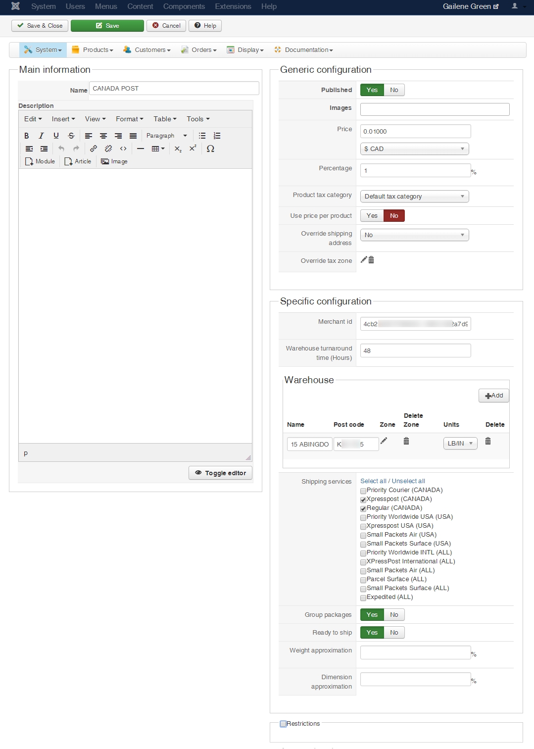

I am having a problem with the Canada Post shipping option displaying in the shopping cart. I have configured it according to the FAQ and the plug-in specific documentation however it doesn't show as an option in the cart.
I published the manual shipping option and it is working fine.
I also turned on Joomla errors but no error is generated.
I have attached the current configuration of the plug in.
Thanks for any assistance,
Penny

9 years 11 months ago #246033
Did you set weight and dimensions in your products ?
Also can you check that you didn't remove the "shipping" view from the "checkout workflow" setting of the HikaShop configuration ?
Also, the CanadaPost shipping plugin asks CanadaPost how much is the fee and provides the weight/dimension of the products, and the customer address, so you need to be already logged in with a user and have already entered your address to see the shipping fees.

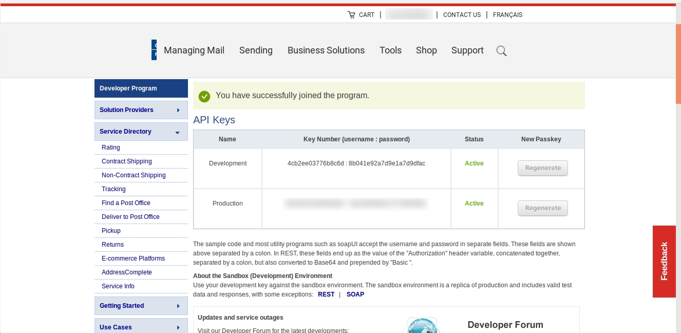

Now I get the following error message.
"Error while sending XML to CANADA POST. Error code: -2001. Message: Merchant CPC Id not found on server."
I've double checked that the number I entered matched what the client provided. I've included a sanitised version of what she sent me.
Does look like the correct form for the ID or has she sent me the wrong number?
Thanks!
9 years 11 months ago #246066
I think that you're using a wrong ID, you should ask her for her CPC ID, and if she doesn't have it then she should directly ask it to the Canada Post shipping platform.

  • Posts: 4
9 years 11 months ago #246719
We followed up with Canada Post and below is the reply we received. You may want to make note of the contact information for anyone else experiencing this problem.
Thanks!
You are attempting to use a solution powered by Sell Online, an older shipping solution no longer in active development and is not supported on the Developer Program forum. For any Sell Online Inquiries please contact 1 866-511-0546 or email at This email address is being protected from spambots. You need JavaScript enabled to view it.
We highly recommend you to use a solution based on the Developer Program APIs if possible.
Many thanks,
The Developer Program team
9 years 11 months ago #246801
That's weird, I just tested it on my end and with a valid CPC ID and it worked perfectly fine, did you asked them how you can retrieve your own CPC ID ?
