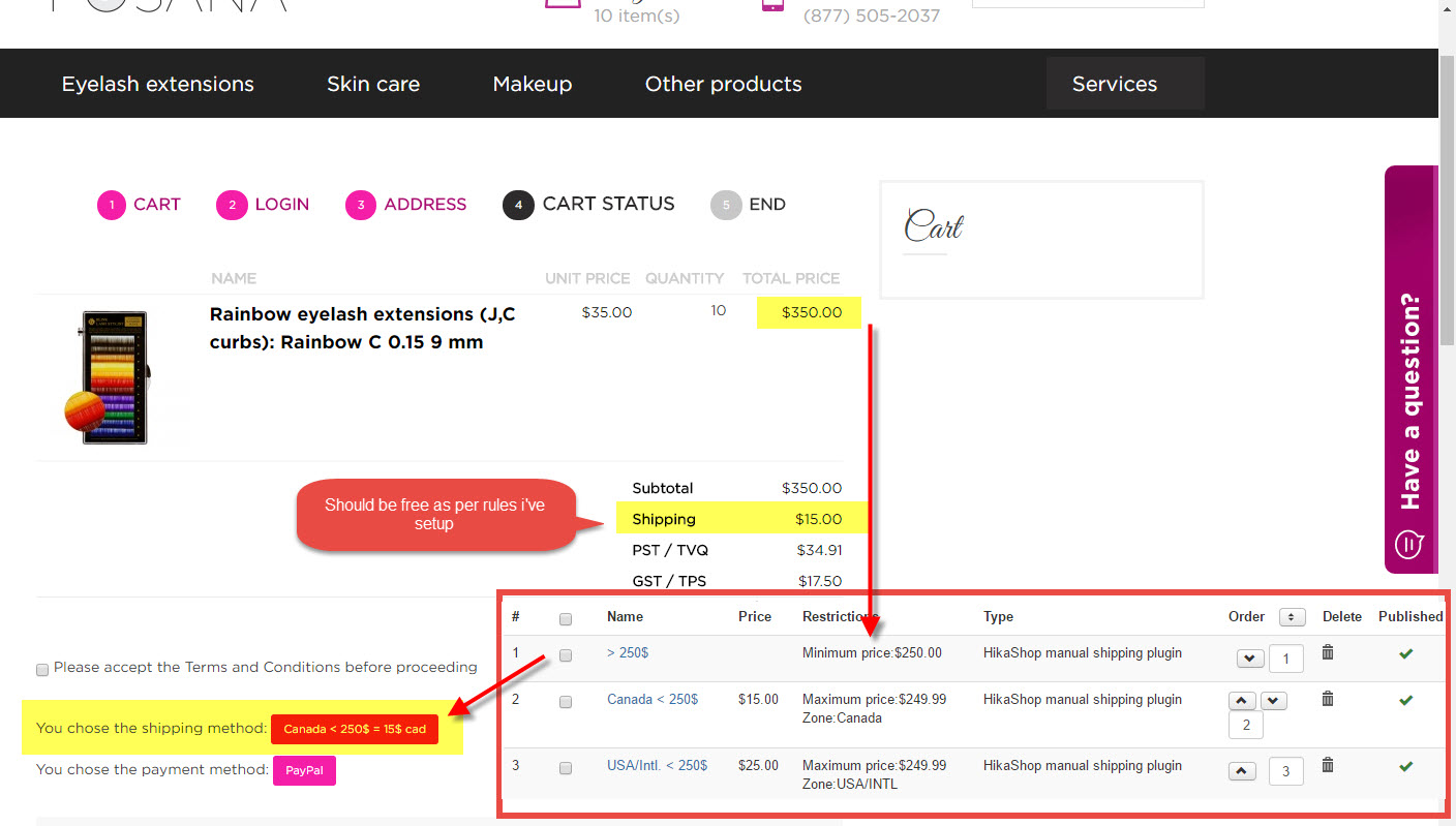

I have 3 manual shipping rules setup up to cost shipping on a cart total and geolocation logic
All order > 250$cad are free
All order < 250$cad are 15$ un CA and 25$ in USA/intl.
I have no other exception rules for this
No matter what the order total, it always triggers the 15$ shipping fee ?
See attached screenshot
Any help here would be greatly appreciated !

If your products don't have a weight and you have the "include virtual products price" setting turned off in your shipping methods, the price of your products won't be taken into account for the price restrictions.
That could explain your situation.

Hello Nicolas!
Woah, thanks!
That was exactly the problem :-)
Just had to set "Included virtual goods" to on for all of them and bingo!
Thanks again ;-)
