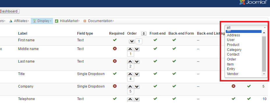

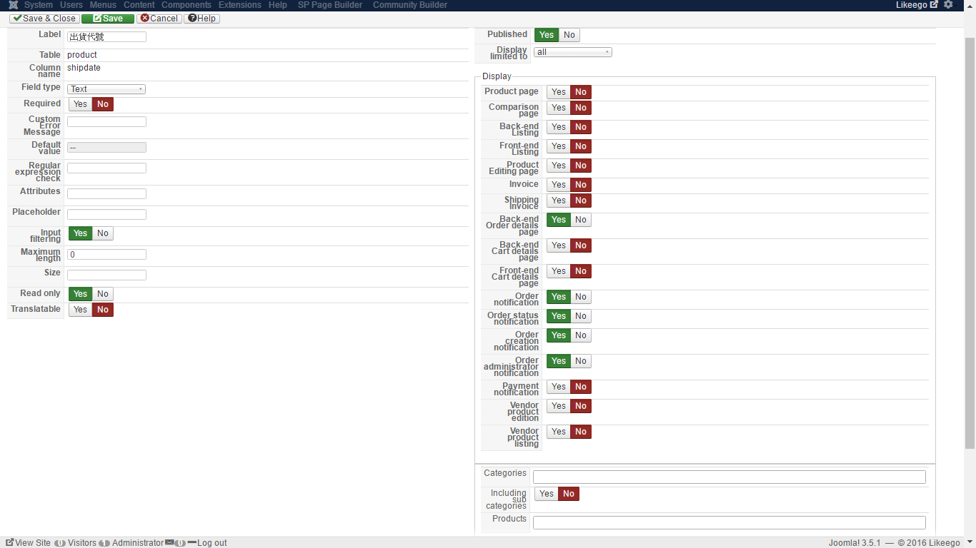

  • Posts: 252
9 years 10 months ago #254286
The custom filed I am adding should be in product_order table, but there is so such option in hikeshop\configuration\display\custom fields as in the attached screenshot.
This custom field is for putting the ship_tracing code for each product, because mostly we ship products in an order by 2 or 3 batch.
My question is, how and where do I put the code by each shipping, so user knows which products was shipped.
I hope this is clear enough.
Best regards

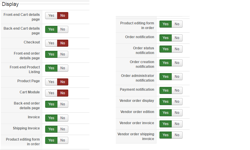

  • Posts: 86178
  • Thank you received: 14214
9 years 10 months ago #254287
The custom fields of the table "item" do store their data in the table order_product. So that's what you want to do.

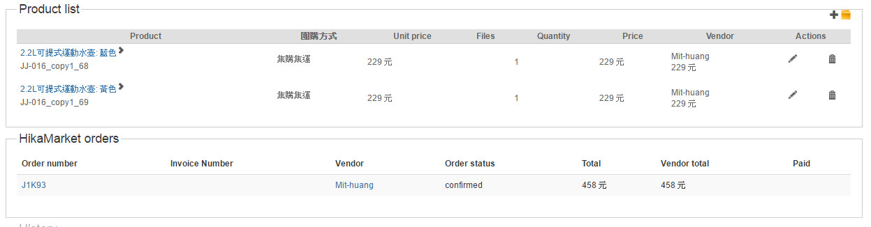

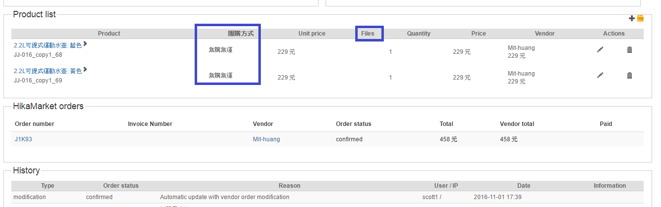

  • Posts: 252
9 years 10 months ago #254393
Thanks Nicolas, it works. The column was added in to Table,
1. I added 2 custom fields one in product and another one in order_product, but only the first one shown in my order detail page, as shown in the screenshot(2.OrderDetail.PNG), the missing column's display setting is as (1.CustomfildSetting.png),
2. How to remove the file column in my order detail ?

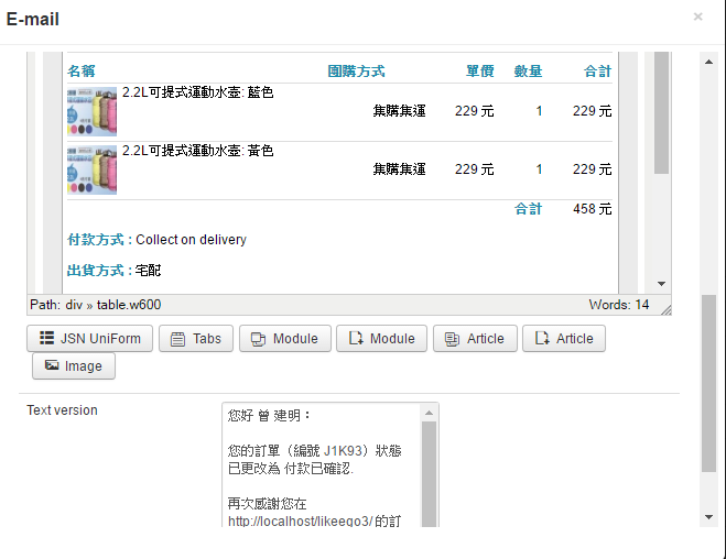

3. The email button in order detail
a. The popup window was too small, how to make it wider?
b. I want to modify the layout and content of the email, which file should open?
c. The column I added into item(Order_products) didn't show in the email product list, please see the attached screenshot.
Thanks again
Best Regards
  • Posts: 86178
9 years 10 months ago #254415
1. The "backend listing" setting of your custom item field is turned off, so it's normal that it doesn't appear on the listing of the products of the order in the backend.
2. You can add custom CSS to the backend CSS of HikaShop via the HikaShop configuration.
3. a In the file administrator/components/com_hikashop/views/order/view.html.php, you'll find that code:
array('name' => 'Popup', 'icon' => 'send', 'id' => 'send', 'alt' => JText::_('HIKA_EMAIL'), 'url' => $url_email, 'width' => 720),
			array('name' => 'Popup', 'icon' => 'invoice', 'id' => 'invoice', 'alt' => JText::_('INVOICE'), 'url' => $url_invoice, 'width' => 720),
			array('name' => 'Popup', 'icon' => 'shipping', 'id' => 'shipping', 'alt' => JText::_('SHIPPING_INVOICE'), 'url' => $url_shipping, 'width' => 720),
Change the width in order to control the size of the popups.
3.b Go in the menu System>Emails, click on the email you want to modify and do the change in the HTML version.
3.c It can come from several things.
First, download the install package of the latest version on our website and install it on your website. Then, save the settings of your custom field. If that still doesn't display the custom item field, check that you don't have any overrides of the emails via the menu System>Emails. If you do, try deleting them.

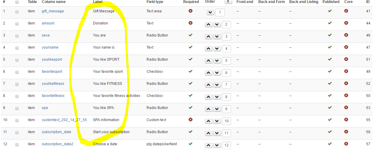

  • Posts: 252
9 years 10 months ago #254526
The custom item field still don't show in my order product list, I don't know what was wrong, I have turned on almost every user display option, the setting screenshot is as below:
and in my order detail page, neither in product list nor hikamarket order, I don't see the item custom field.
There is one thing that is very confusing to me is that, there was may item custom fields in my setting, I am not sure where/when the were from, and these fields never show in my order detail either, since they are all published and was setting to show in the order detail but I never saw them show up, so why the new created item custom field can be shown?
Maybe my understanding of the custom field was wrong, Could you show me how to show the custom information in the product list of the order detail page.
Best regards
  • Posts: 86178
9 years 10 months ago #254614
A custom field value will only be displayed if:
- its display setting for the location you're looking at is activated
- there is actually a value recorded for that custom field.
So if you turned on the display option and you still don't see it, it's probably because there is no value stored for the custom field in the order.
So in that case, try this:
Download the install package of HikaShop on our website, install it on your website, edit the custom item field and save its settings.
Then, do a new order and fill in the custom field value in it on the product page and check the resulting order on the backend after the checkout. It should then display there.
The following user(s) said Thank You: twscott
