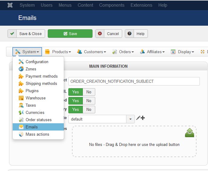

The email I'm trying to change is the one that is send when an order is created. (Configuration > System > Email).
There I select the order created mail and do the change in the Pre-load block.

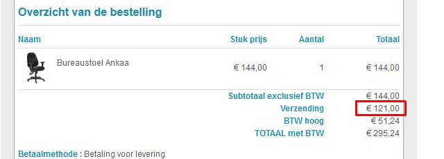

Is just tested again if I'm in the right file and it's the "order creation notification" email I need to edit.
Testing with an extra piece in the HTML part is showing this in the confirmation email.
What I did not get right is the syntax for not showing the tax on the shipping.
Anyone willing to help with this by sending a piece of code that I can try ?

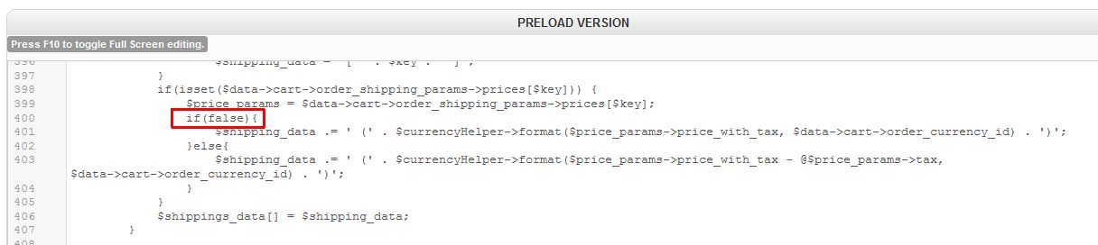

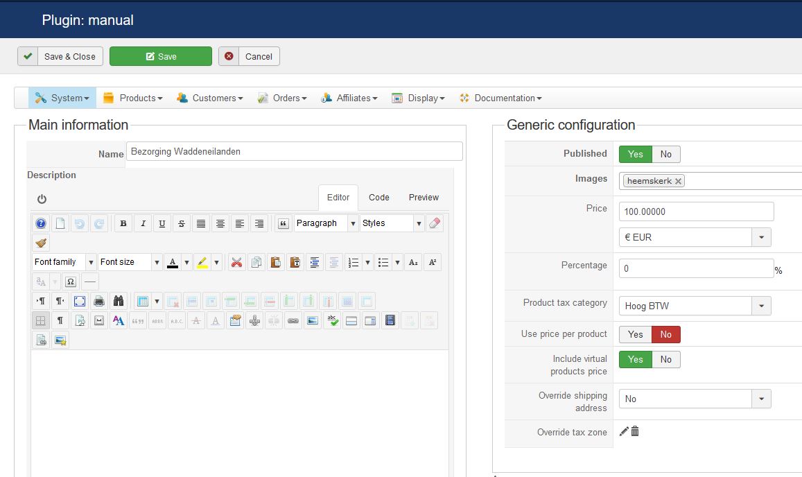

Here are some screenshots of the config and the changes I made.

Ok, we were not talking about the same place.
It's that code that you want to change then:
		if($config->get('price_with_tax')) {
			$t = $currencyHelper->format($data->cart->order_shipping_price,$data->cart->order_currency_id);
		}else{
			$t = $currencyHelper->format($data->cart->order_shipping_price-@$data->cart->order_shipping_tax,$data->cart->order_currency_id);
replace the condition in the if like on the other code and that will do.
