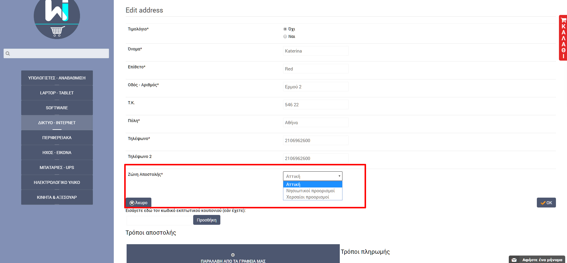

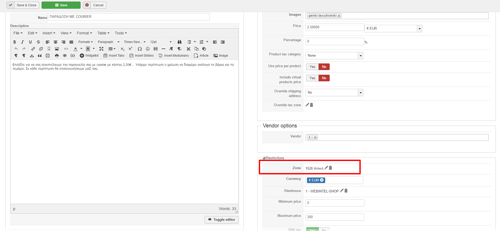

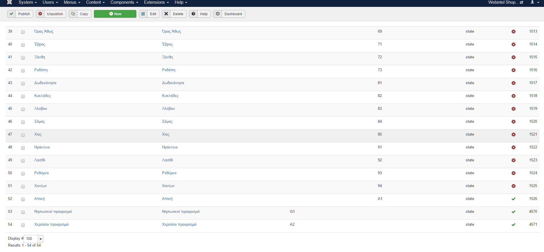

Hello!
i need to have 3 zones for shipping:
1. Athens
2. Islands
3. Rest of Greece
I created the 2rd and 3rd zone (athens is already by hikashop), at first i created them as shipping zones and assigned them to shipping methods at restrictions but it did not work. Then i made them state zones in Greece country, i disabled all the other states of Greece, i assigned each state at each shipping method i needed but still if i choose one of these 3 states at checkout i see no shipping methods.
Please help !
Thank you

HikaShop bases itself on the custom fields "address_state" and "address_country" in order to apply the zone restriction of the shipping methods.
You're you've removed both of these custom fields and created instead your own, HikaShop has no way of knowing the zone of the customer for the shipping methods and thus doesn't display any of them.
Remove your custom field and use instead the "address_state" custom field and it will work like you want.
