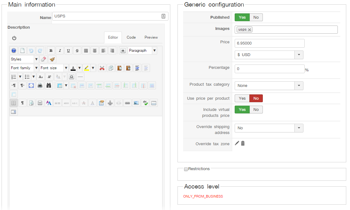

My client uses a flat shipping rate for UPS and USPS. I created 2 shipping methods based on the HikaShop manual shipping plugin:
  • USPS
  • UPS
For the USPS method, it charges a flat $6.95. You can see the configuration below.
When this passes to TaxCloud at checkout, it just passes $6.00.

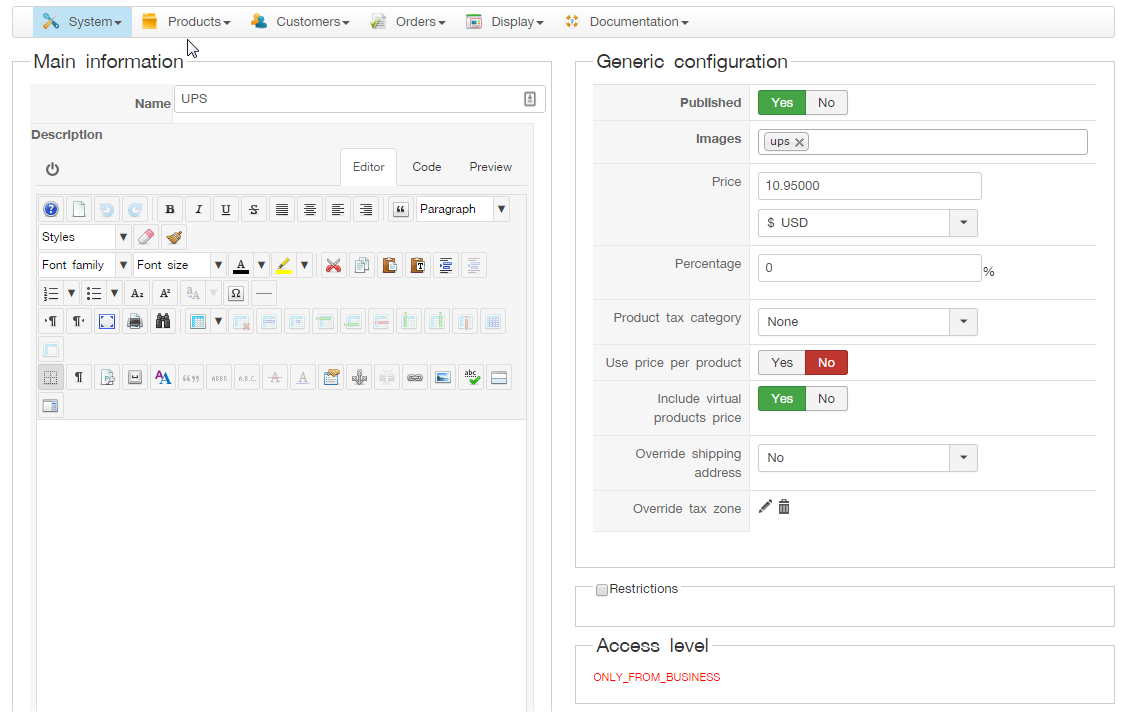

For the UPS method, it charges a flat $10.95. You can see the configuration below.
When this passes to TaxCloud at checkout, it just passes $10.00.
My question is this: Why is HikaShop not passing the full shipping cost to TaxCloud?

9 years 3 months ago #270716
This looks like a bug.
Change the code:
(int)($shipping->price_with_tax - $shipping->tax)
to:
in the both places where you have it in the file plugins/hikashop/taxcloud/taxcloud.php file and that should work properly.
Please let us know how it goes.
  • Posts: 6
9 years 3 months ago #270717
That did it!
Thanks.
