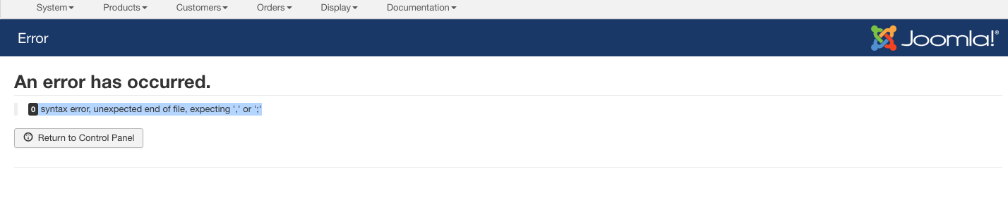

This is the error in Debug Mode :
An error has occurred.
0 syntax error, unexpected end of file, expecting ',' or ';'

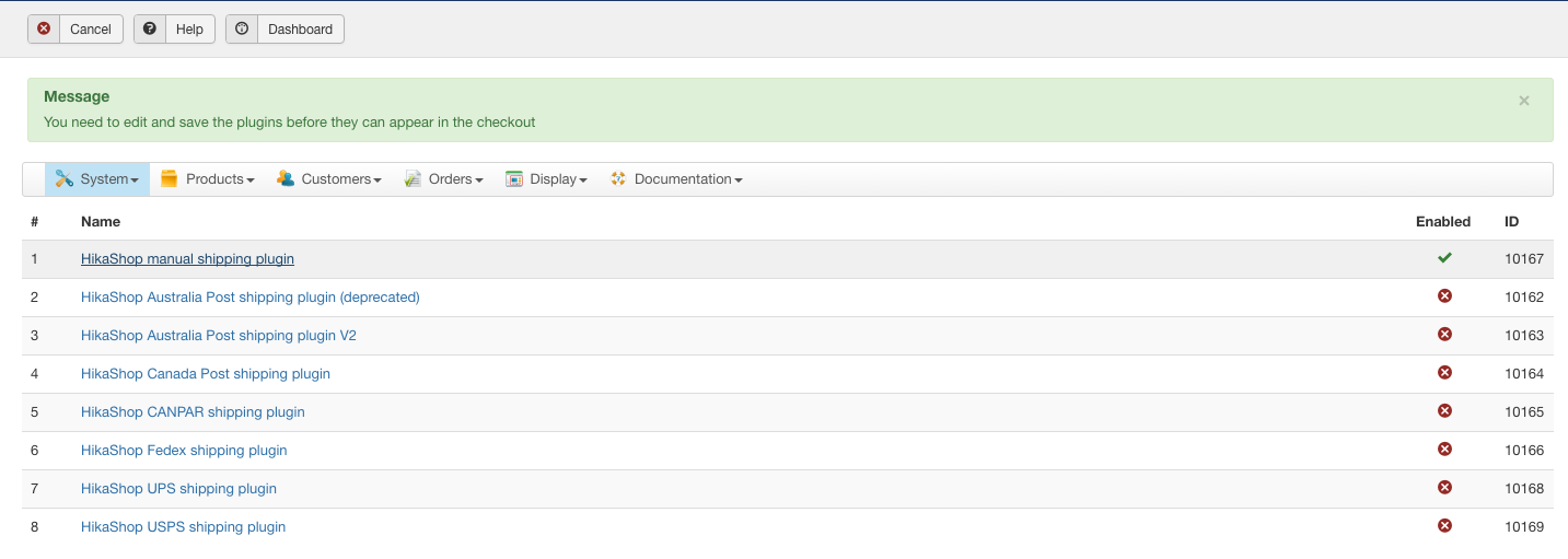

  • Posts: 89
9 years 2 months ago #273188
This is the Errors Log attached.
My Screen before the error is attached and obviously I am not able to reproduce the error as the Demo is Hikashop Business and I have Hikashop Essential.
