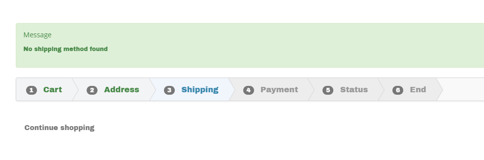

-- url of the page with the problem -- : www.revelationuptotheminute.org/en/cart/...out/task-step/step-0
-- Joomla version -- : 3.7.3
-- PHP version -- : 5.6.29
-- Browser(s) name and version -- : google chrome
I have two shipping methods and neither one of them is working. The UPS plugin was working but not it is not.
