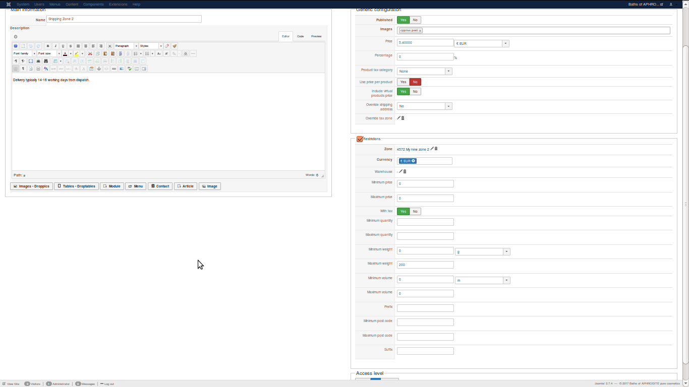

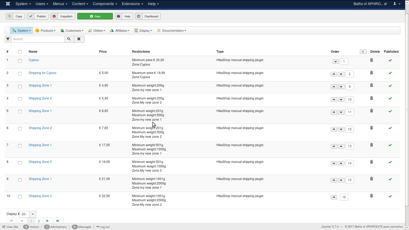

Hikashop "HikaShop manual shipping plugin" is not working as per
weight restrictions

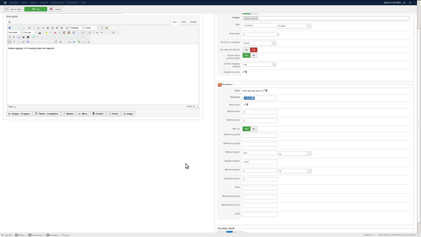

I set below restriction in shipping is
Minimum weight:501g
Maximum weight:1000g
Zone:My new zone 2
and its shipping cost is EUR19,00
For example go to below link
www.bathsofaphrodite.com/our-products/sk...ct/34-cleansing-milk
This product weight is 255 gram in back end
Add product to cart and register and select country bangladesh in
shipping address for zone 2 and update quantity with two so now
cart
weight is 510 gram
So now when you update quantity the shipping cost is not working
and
not showing EUR19,00 and instead of EUR19,00 its showing EUR5,40
And shipping cost of EUR5,40 restriction is
Maximum weight:200g
Zone:My new zone 2

8 years 11 months ago #275631
As we said via email :
Your issue was coming from the fact that you have added the "ml " weight unit as the main weight unit of your shop, so I have modified the "weight symbols" option via "Hikashop->System->Configuration->Advanced" and it's working fine now.
Note that we have also added a fix for the next Hikashop release.
Thank you for your feedback !
