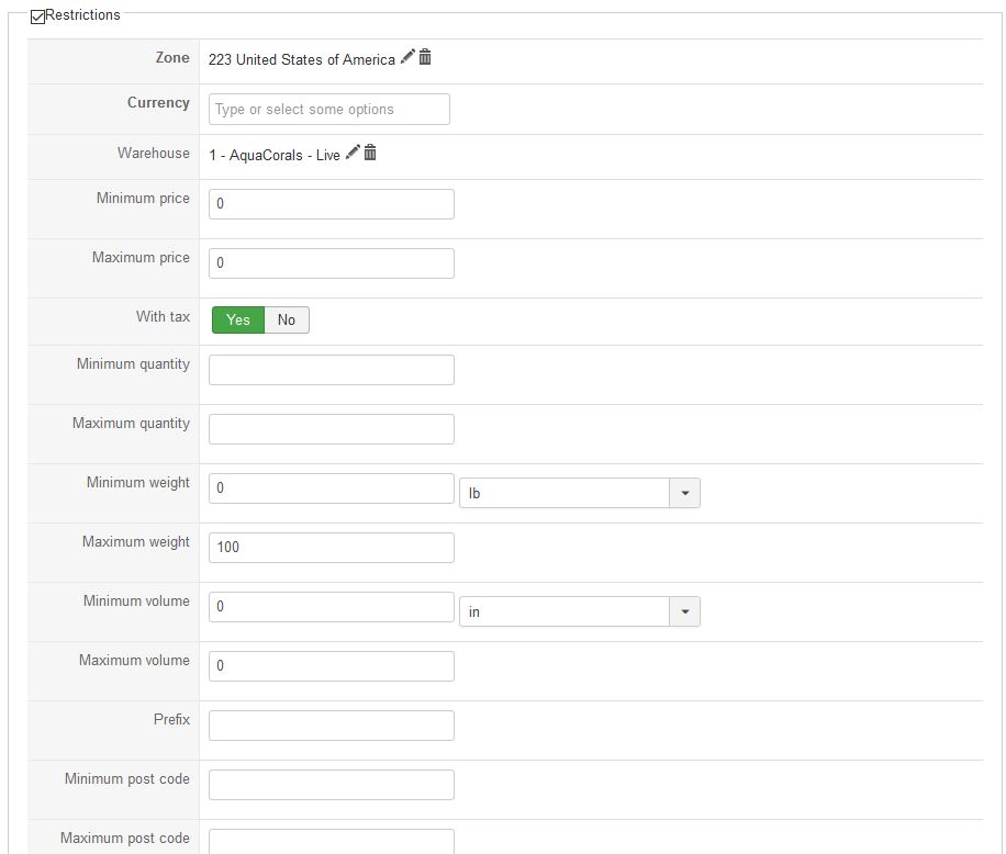

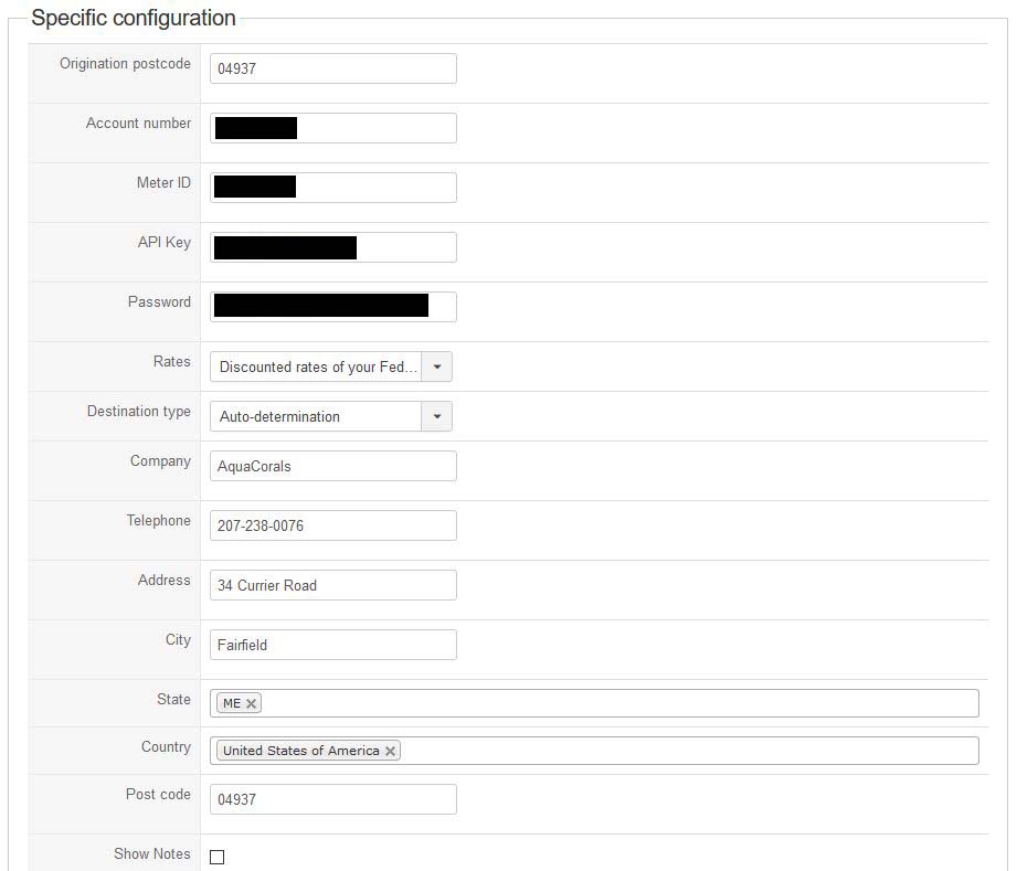

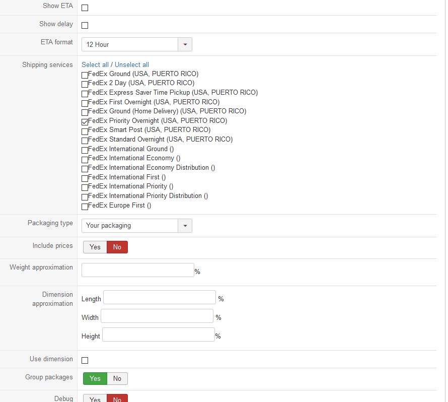

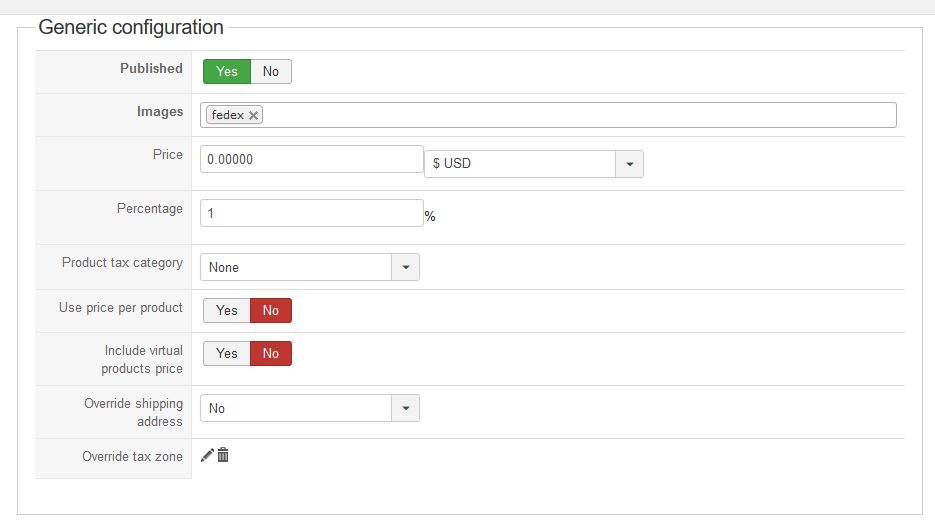

Do you have more information than just "Could not connect to host" in the debug ? How did you configure your Fedex shipping method ? Could you provide a screenshot ?

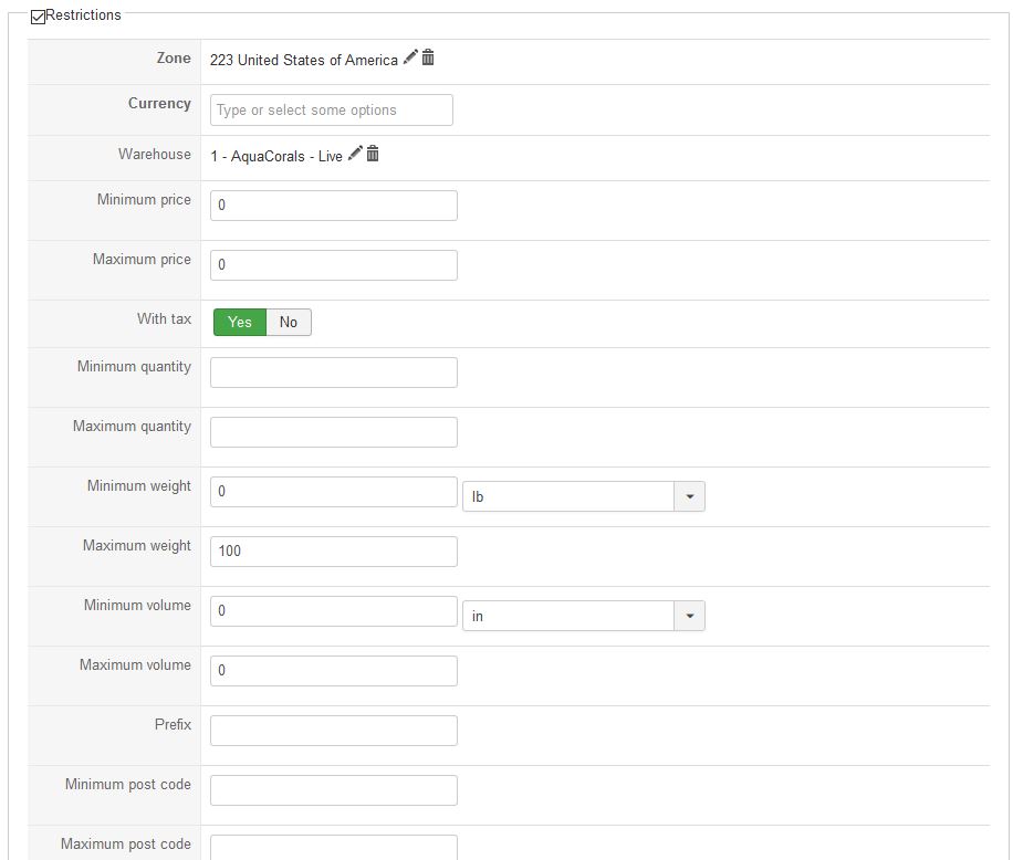

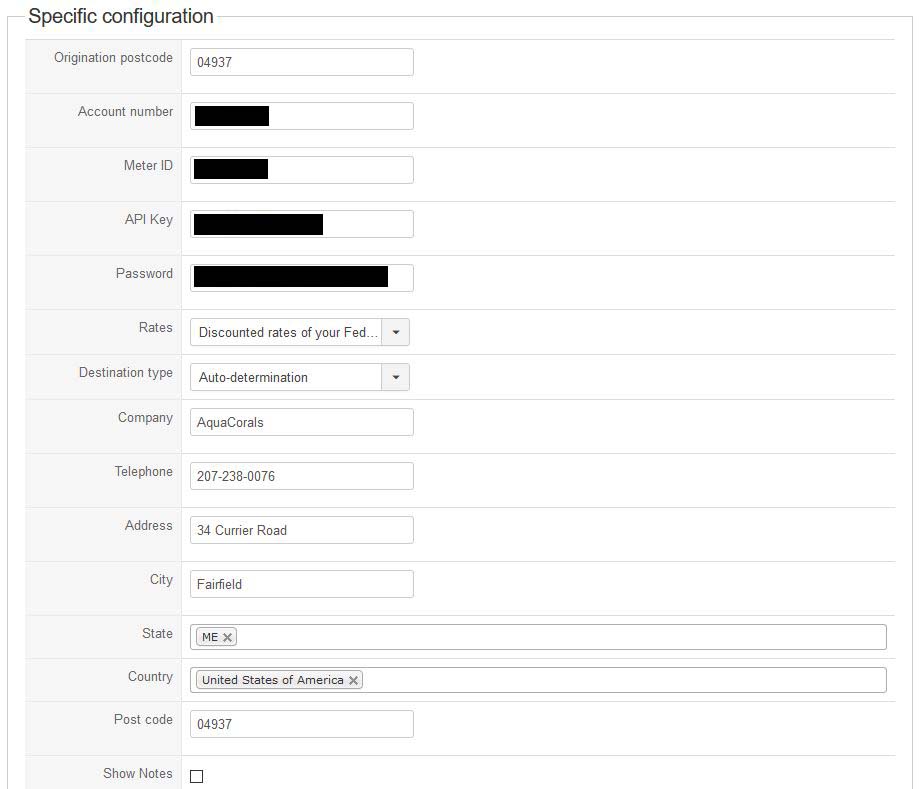

8 years 11 months ago #276006
I can not guarantee that it started immediately after that update dated August 2nd, just that the last successful order was on the 4th. I may have updated the installation on the 5th or after, just don't remember.
The version of Hikashop prior to that would have been dated 7/27 or 6/21
I've attached screenshots of the shipping configuration and the debug report with the account numbers etc removed.
