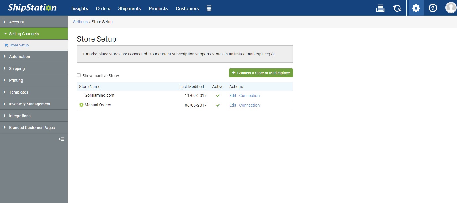

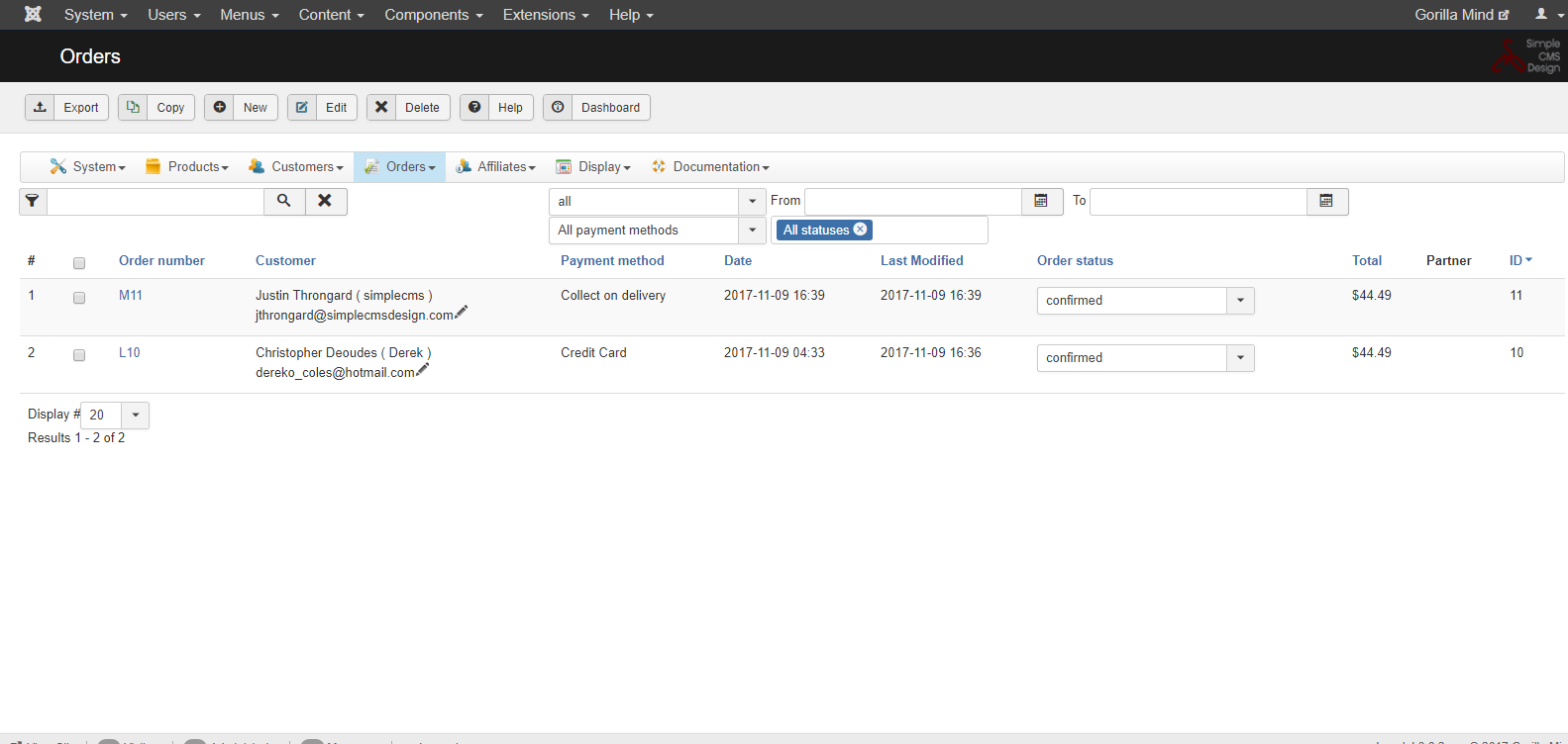

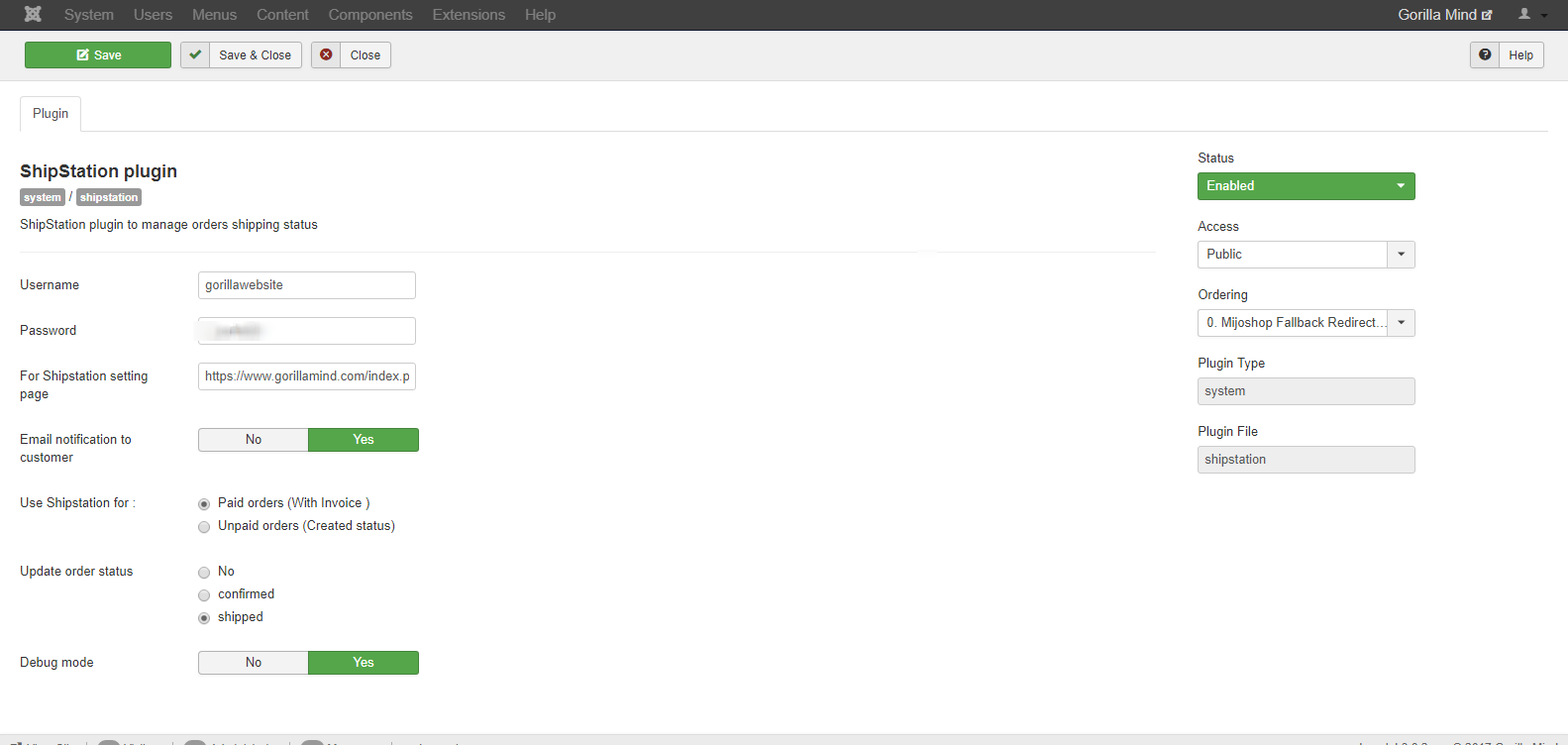

8 years 10 months ago #282386
So what we did was complete a couple orders in hikashop - marked confirmed.
Then clicked Update Orders in Shipstation. Nothing comes through.
Attached are the screenshots that show the setup of the plugin and Hikashop.

But from what we can see, I notice something you set your Shipstation plugin to export only for "shipped" status while on your order listing your order are only in "confirmed", and so that's normal that nothing is exported.

8 years 10 months ago #282454
Ok, I changed that item to confirmed. That language is a little vague, if I may make a suggestion. It implies to me that Hikashop will update the order when Shipstation marks it shipped, not that Shipstation imports those orders that are listed in the Update Order Status check box. Why would you marked shipped if that's the case?
Anyways, I changed that radio to confirmed and still nothing was imported. So this solution did not work. What would you next advise?
  • Posts: 86
  • Thank you received: 11
8 years 10 months ago #282455
Ok. I still don't understand the radio options for Update Order Status, but I turned it to No and the imports started to work.
