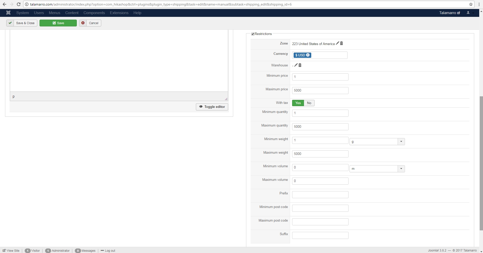

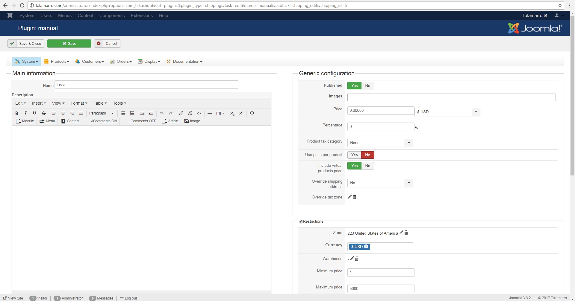

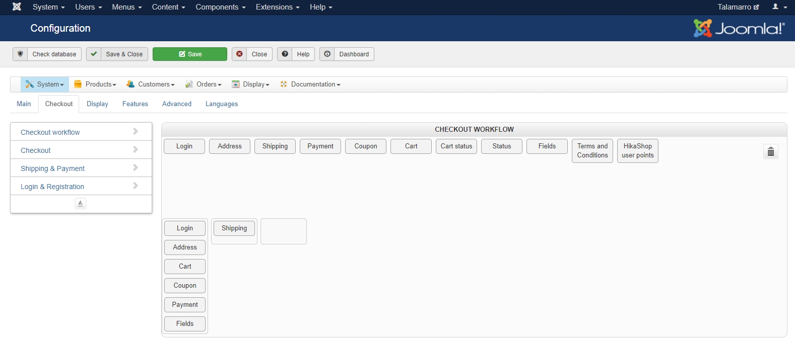

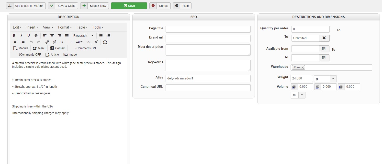

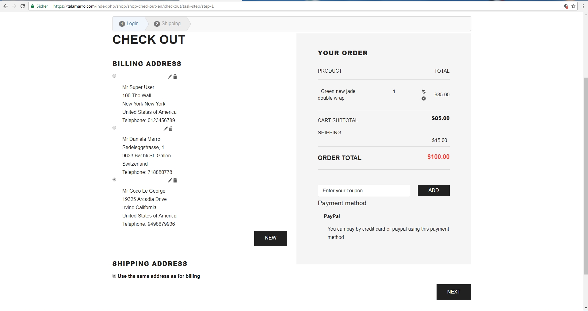

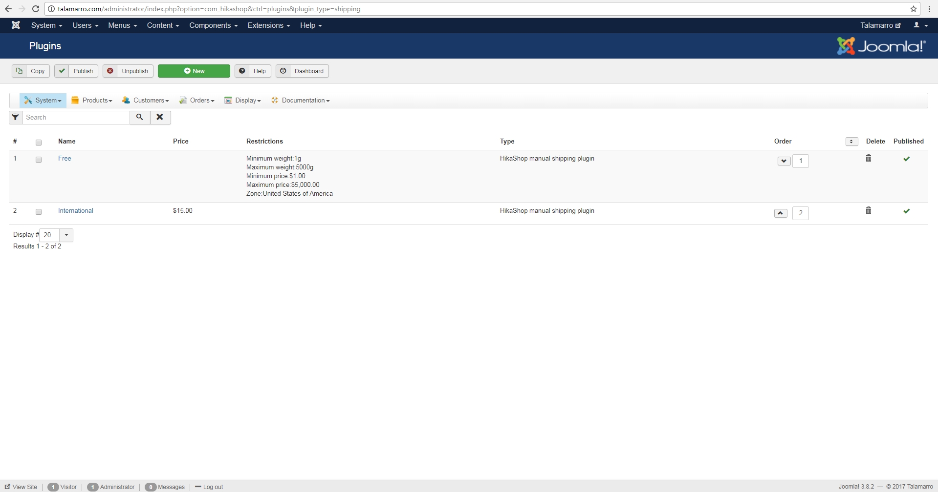

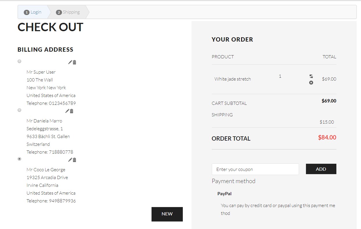

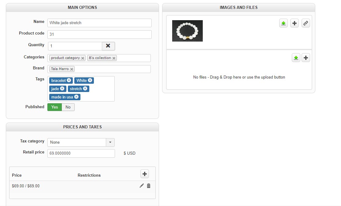

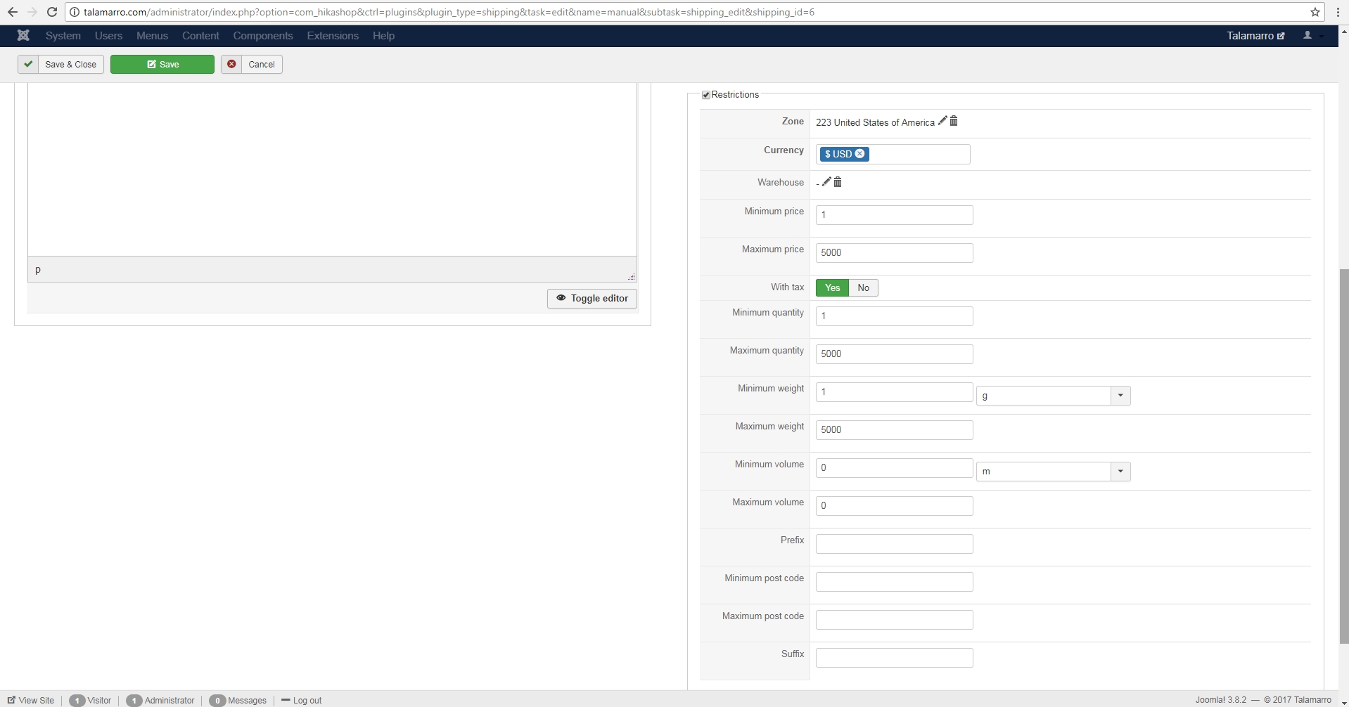

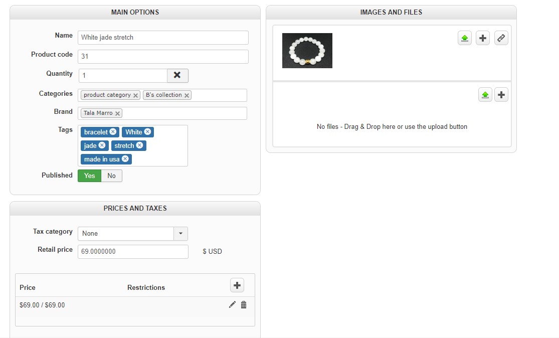

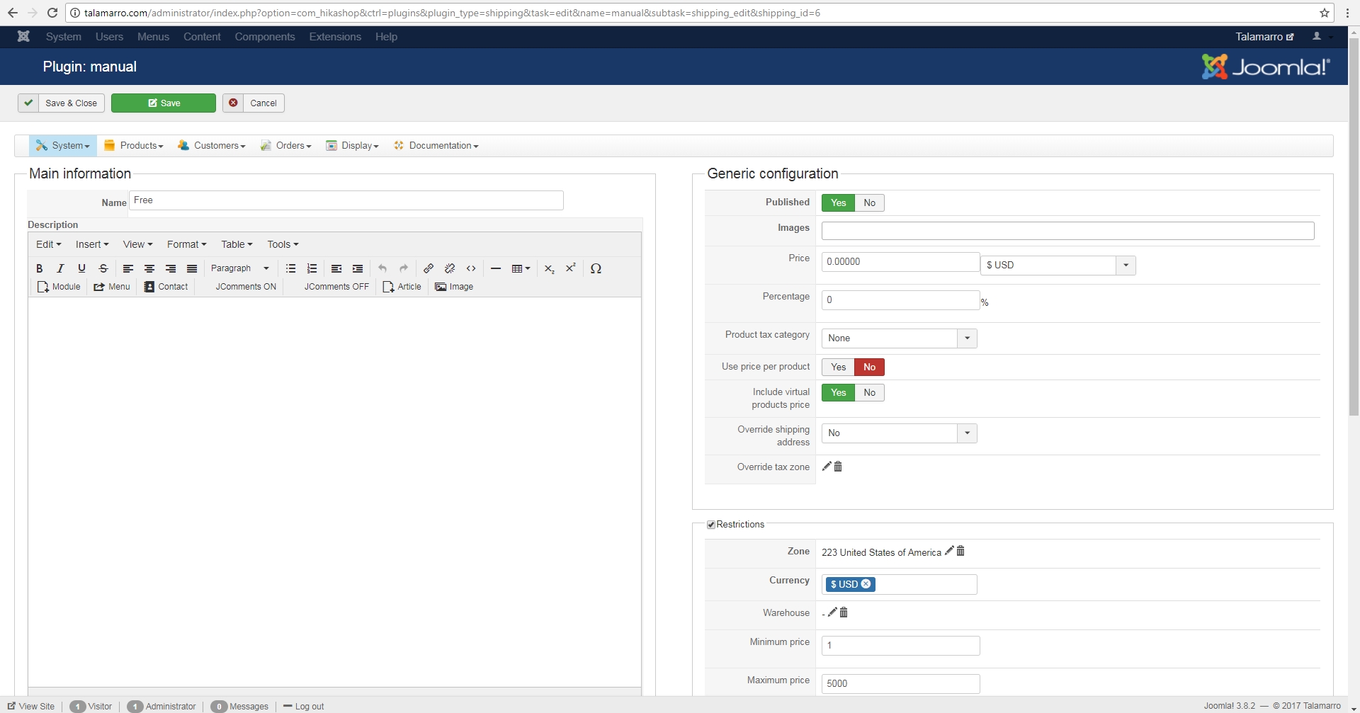

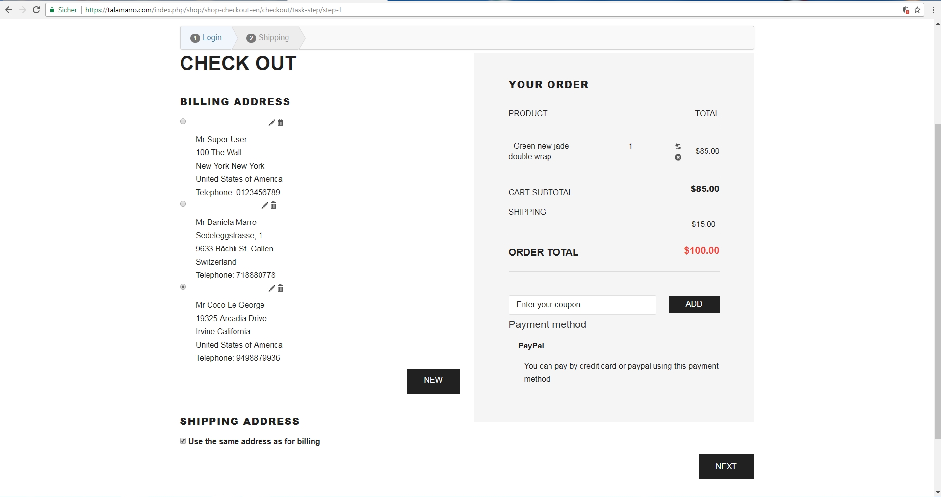

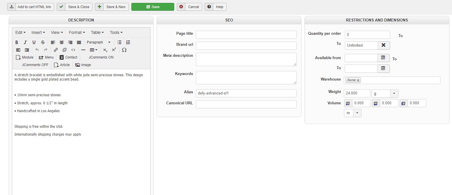

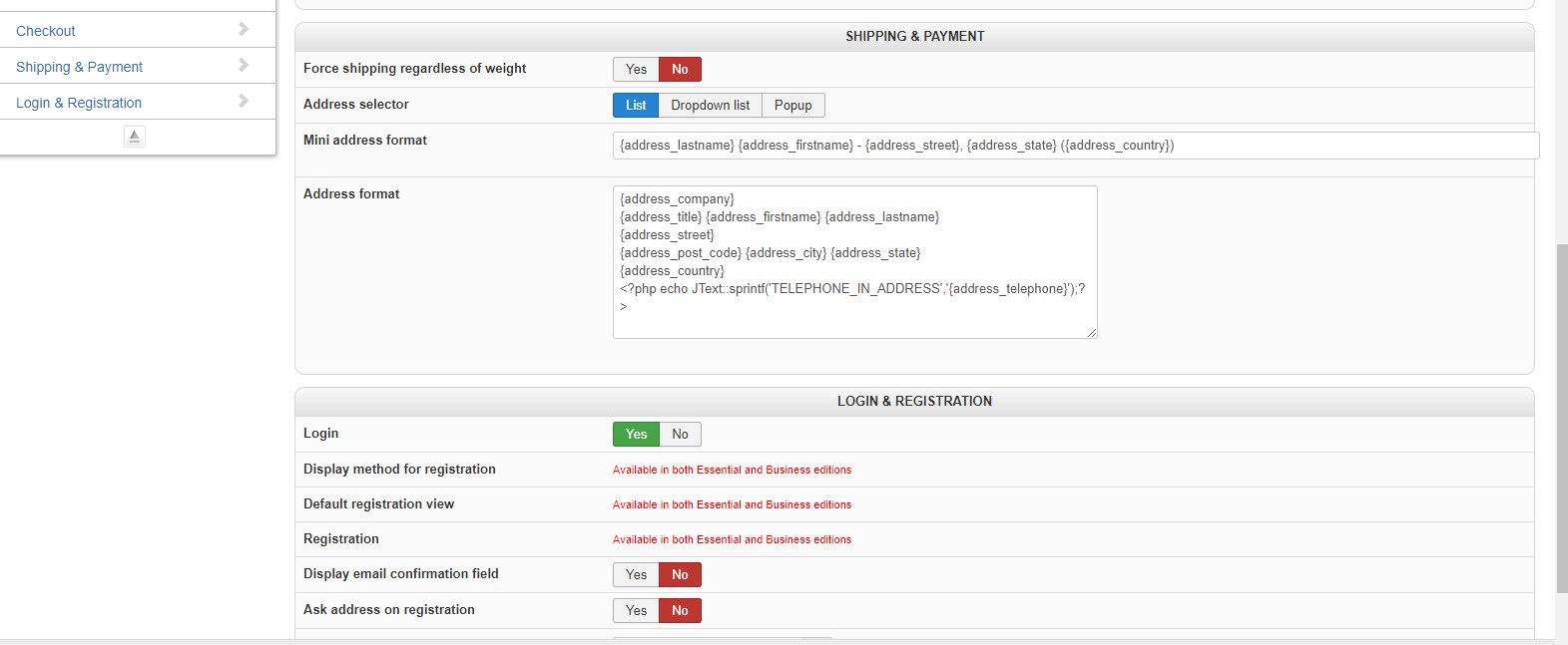

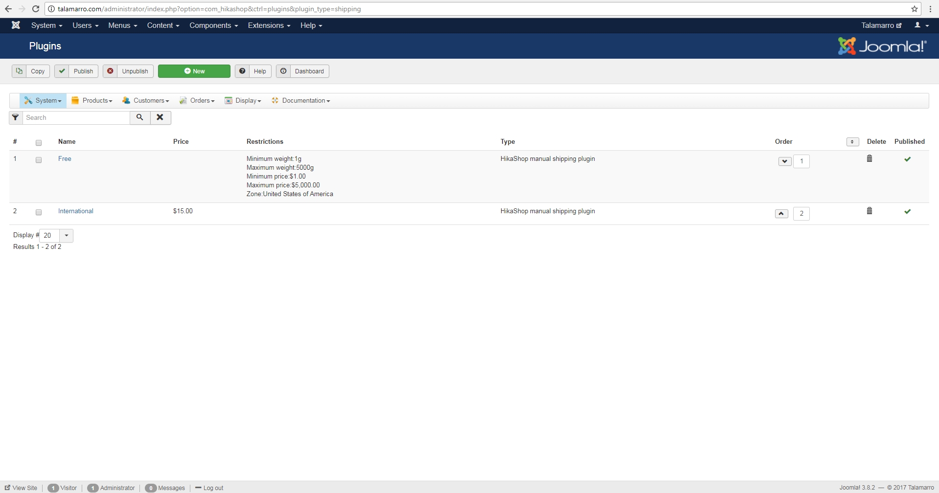

Here are the pictures with the config of the product and the customer adress.

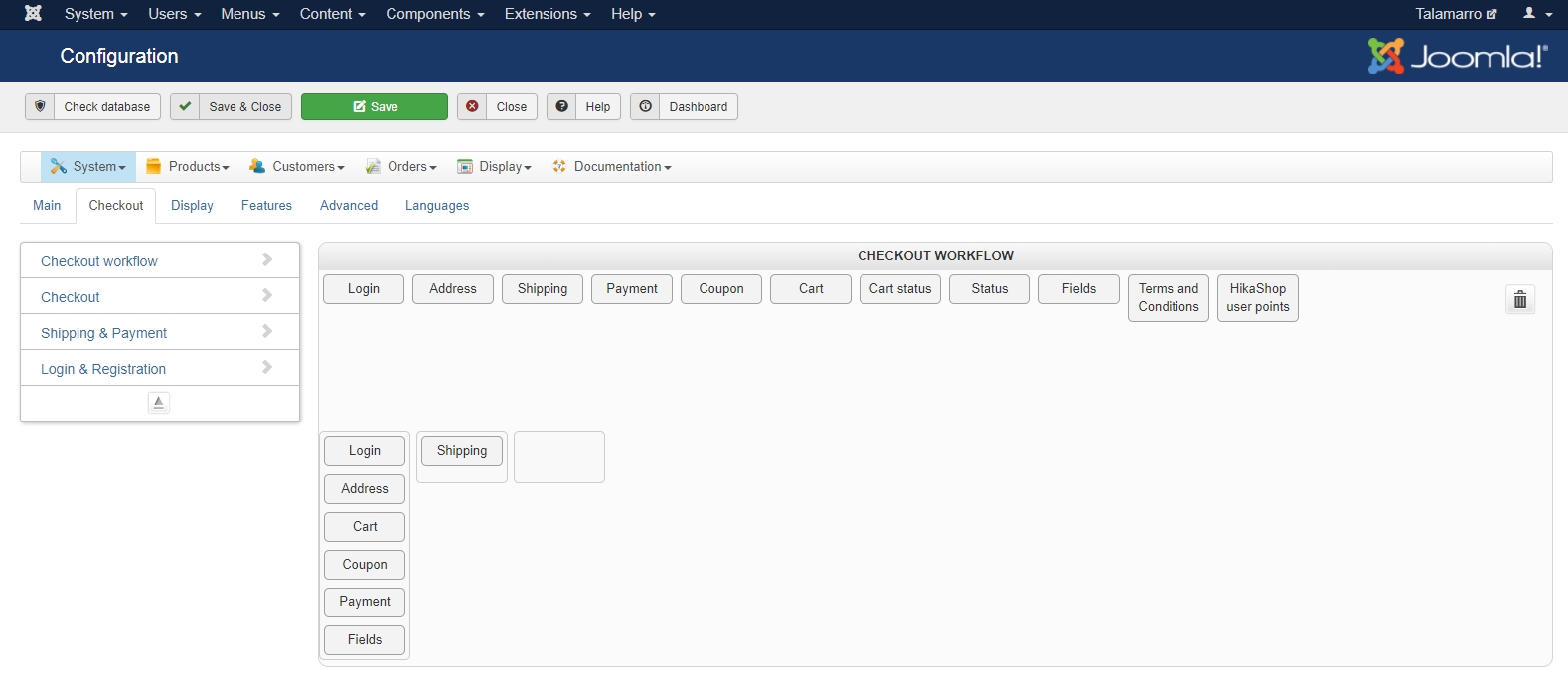

In your screenshots you never displayed the shipping method selection area of the checkout. Did you remove the "shipping" block from your "checkout workflow" in the Hikashop configuration ?
Because the way you configured your shipping methods, it means that if you first have an address outside of the USA on your checkout, only the second shipping method is available on the shipping method selection block and thus it is automatically selected as the one applying to your cart.
If you then switch to an address in the USA, you will have both shipping methods available in the shipping methods select block of the checkout. However, you'll still have the second one selected in your cart as it was already selected before.
If you want HikaShop to automatically switch between one shipping method and the other in your cart without allowing the customer to select between the two shipping methods, you want to add a new zone of the type "shipping" with all the other countries as sub zones and select that shipping zone in the zone setting of your second shipping method.

I want a free shipping for USA and all other country's have to take the 2nd shipping method for 15$

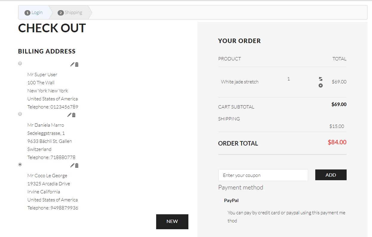

When i put the product in cart, and make the customer login it shows 0$ shipping. But when i change the billing adress (with checked SHIPPING Adress same as billing adress) it always takes the 15$ shipping also for USA. It has to take then the 0$ shipping

If you just want a free shipping price for that country, you can remove a lot of restrictions that you have set-up (almost all, except the country one).
Adding more and more restriction just increase the possibility to not have the shipping method available.
Afterwards, even if the method is available thing that we can't see in your screenshots ; it won't be selected by default.
The first available shipping method will be selected and that value won't change automatically.
And because we can't even know what is the shipping address selected (not visible in your screenshot) ; we can't even tell you if that shipping method can be available.

But i provided a screenshot with the selected Adress.
In my 2nd Post you can see it's selected. And as i told in my last post, the mark is checked ( use same adress as billing)

Funny is, in check out progress, it first takes the right free shipping. But when i change to an international adress it goes to the international shipping. so far so good. But NOW when i change back to USA, the shipping didn't change to free.
What i do....i take a product. Put it in the cart. Then i make the checkout. then i login and then i change the billing adresses. (marked use same adress as billing)

As I said before:
So please do that via the menu System>Zones and add that zone in your shipping method for other countries in the "zone" setting and it will work like you want.
