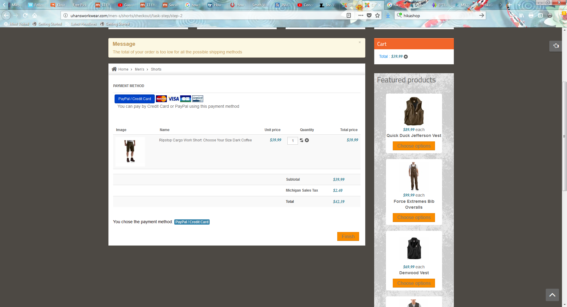

This worked for a couple years now all of a sudden no products can be bought that are less than $99. Anything over $99 uses a manual shipping method and is free shipping and customers can buy products. Anything less than $99 uses the UPS shipping method and all of a sudden doesn't work, people aren't allowed to buy products. Please help. I've tried for hours to figure out....thanks.

  • Posts: 26386
  • Thank you received: 4078
8 years 8 months ago #285871
The message "The total of your order is too low for all the possible shipping methods" means that you have an available shipping method in HikaShop which have a weight restriction and that your current cart is below that weight limitation.

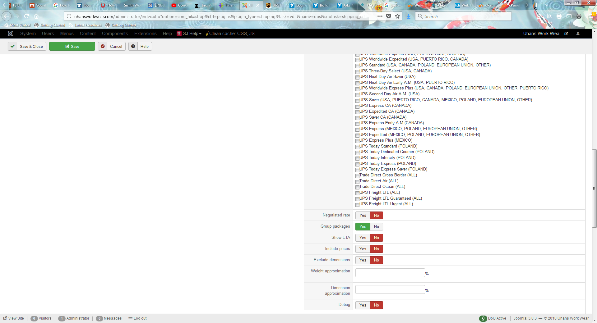

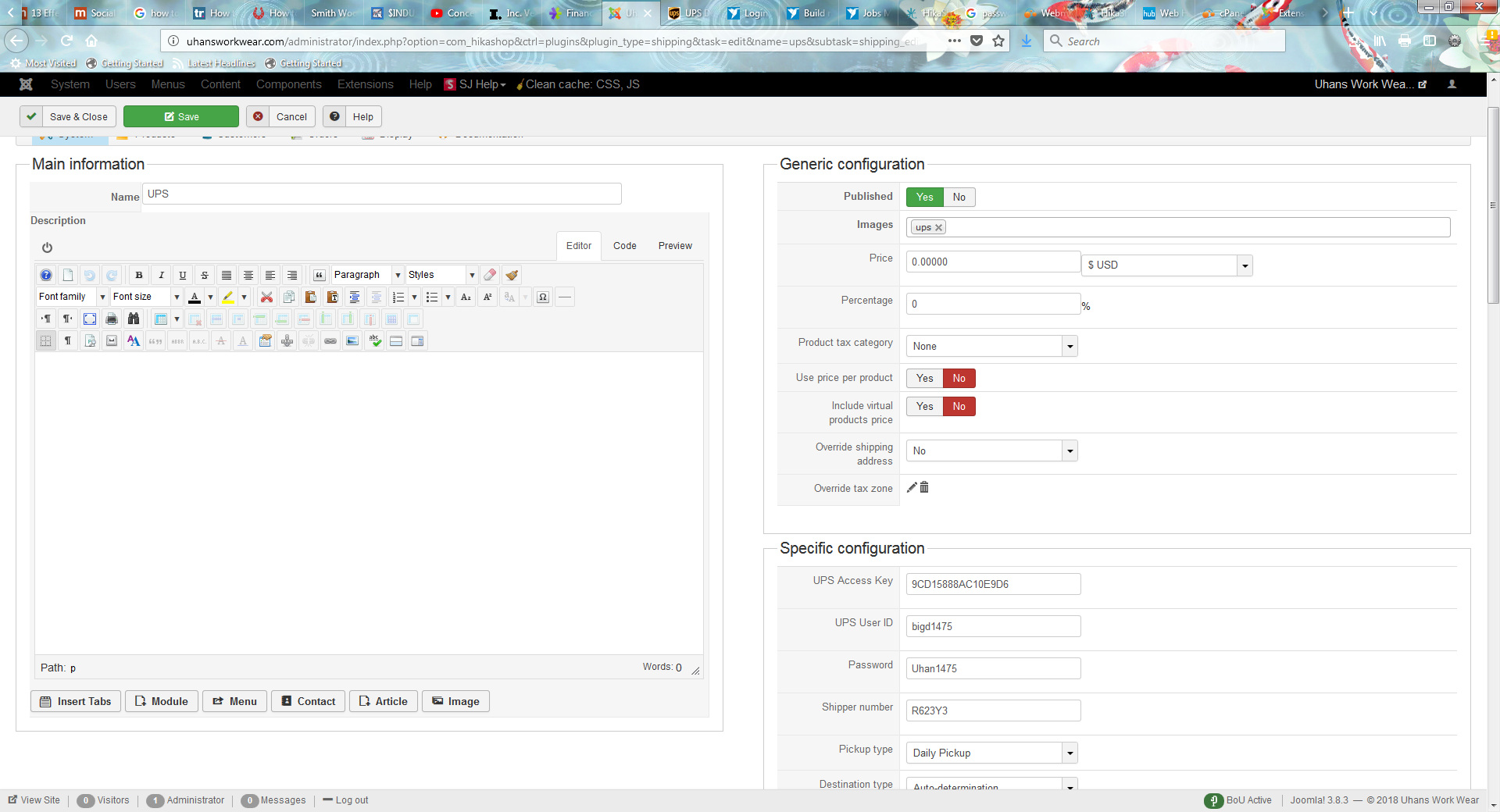

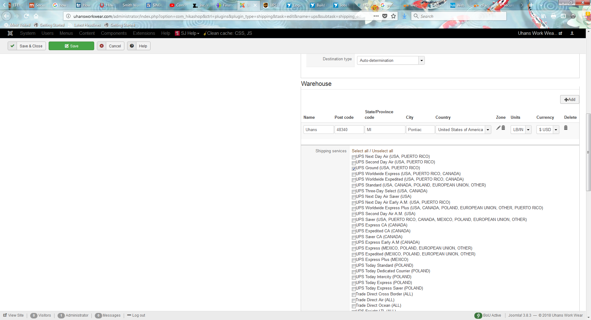

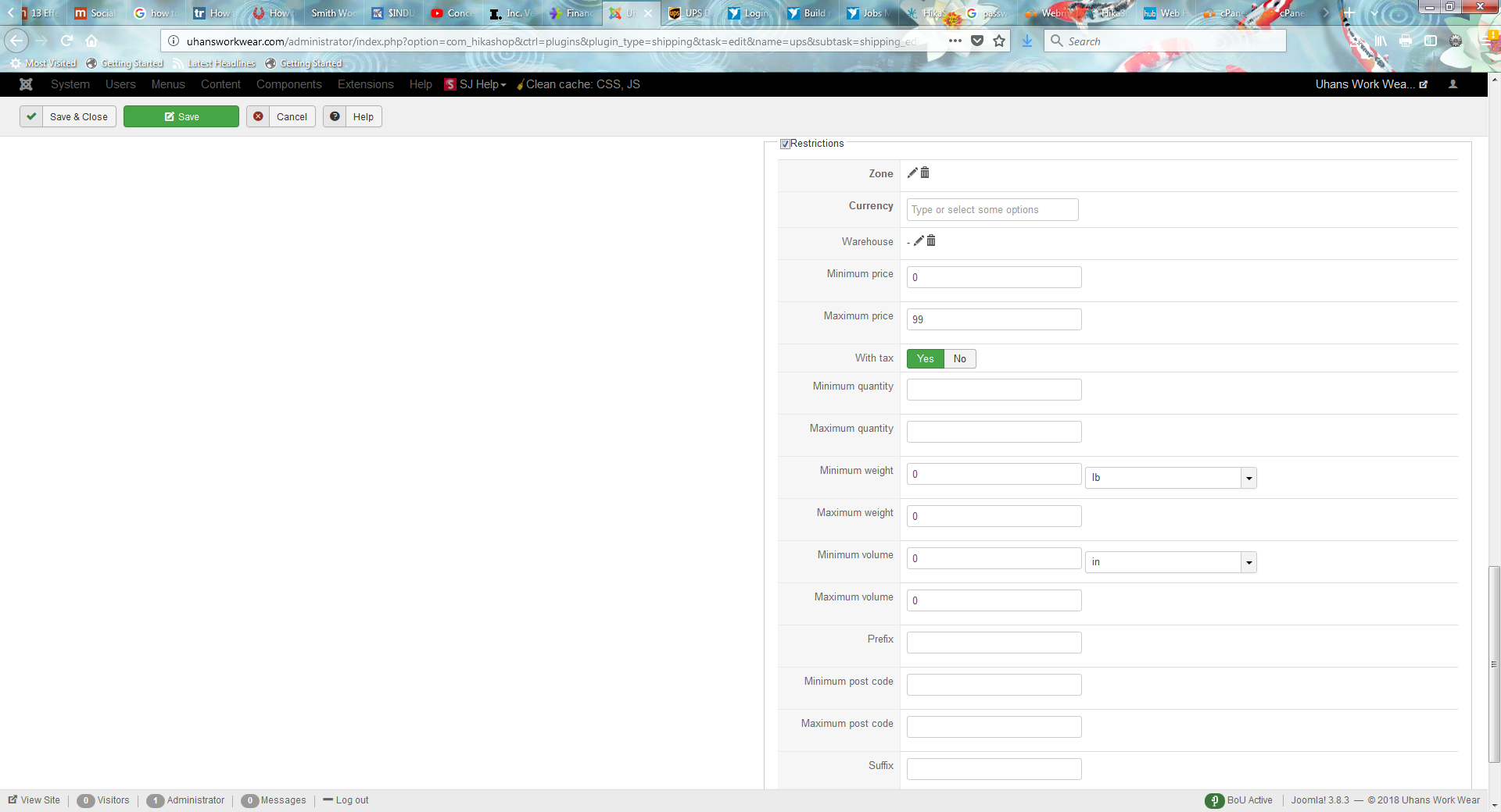

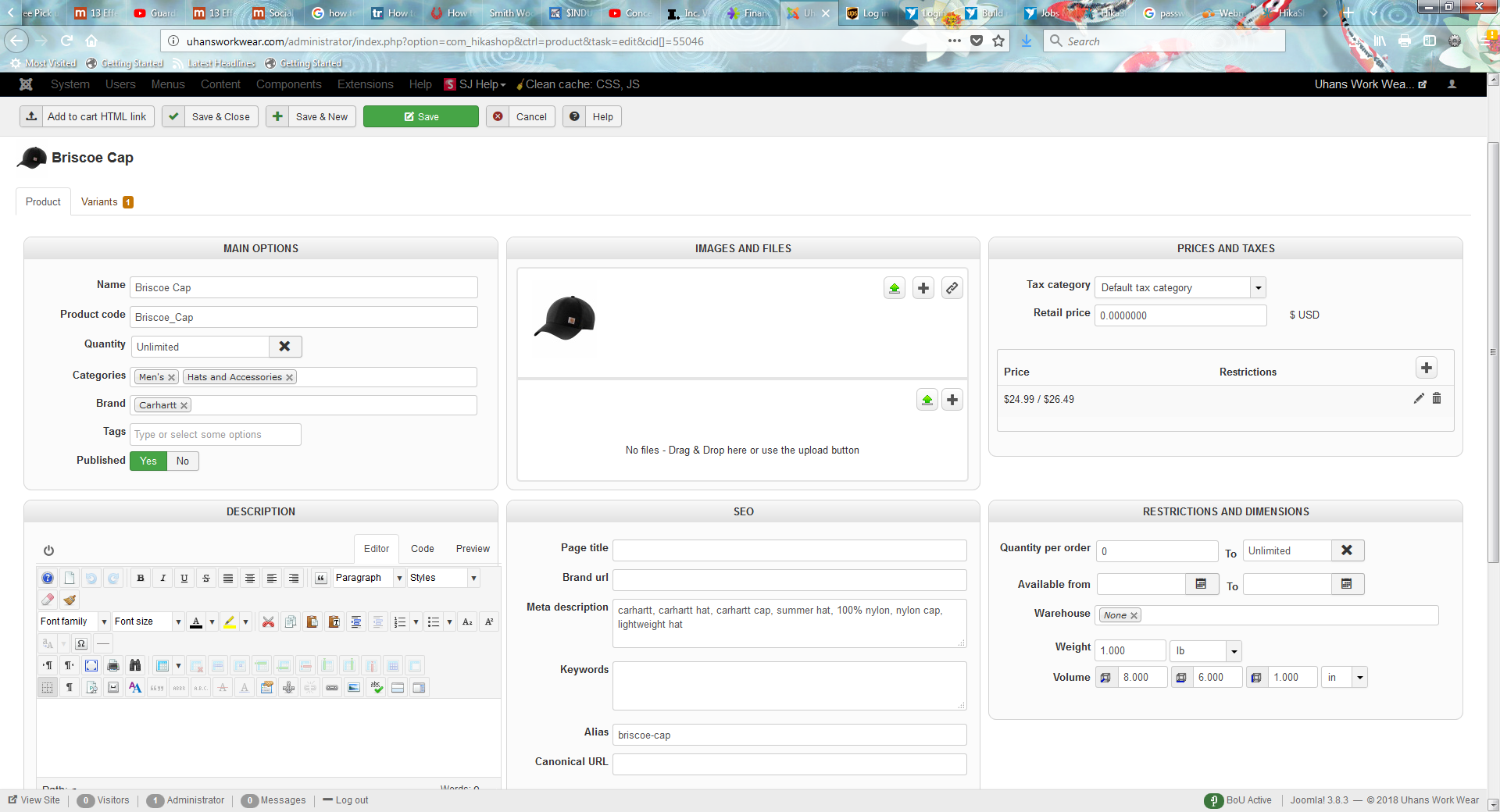

8 years 7 months ago #285999
Can you send us screenshots in which we can correctly check :
- Your shipping method configuration page
- How you configured your product used when testing your shipping plugin
- The shipping address used during your test.
So that we can reproduce and test it on our end ?
Thank you.
  • Posts: 74
  • Hikashop Essential
8 years 7 months ago #286034
Okay. Here's the screenshots you requested.

8 years 7 months ago #286382
The following error message was actually coming from the manual shipping method named "Free Shipping" with a "Minimum Price" set to $99.01 :
Also, your issue seems to be coming from your server, as the response from the UPS platform after sending our request is :
Access denied
You don't have permission to access "Rate" on this server.
You should probably contact your Hosting company about it.
