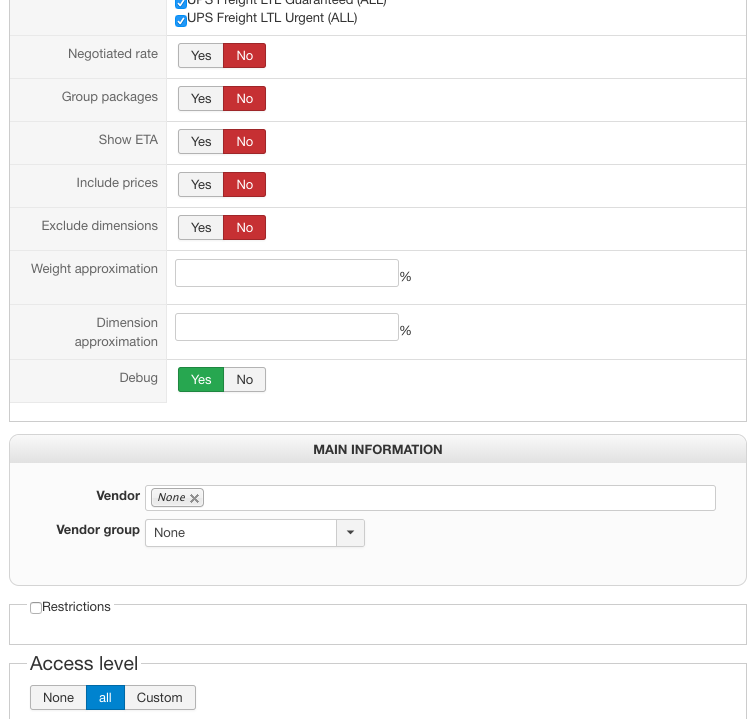

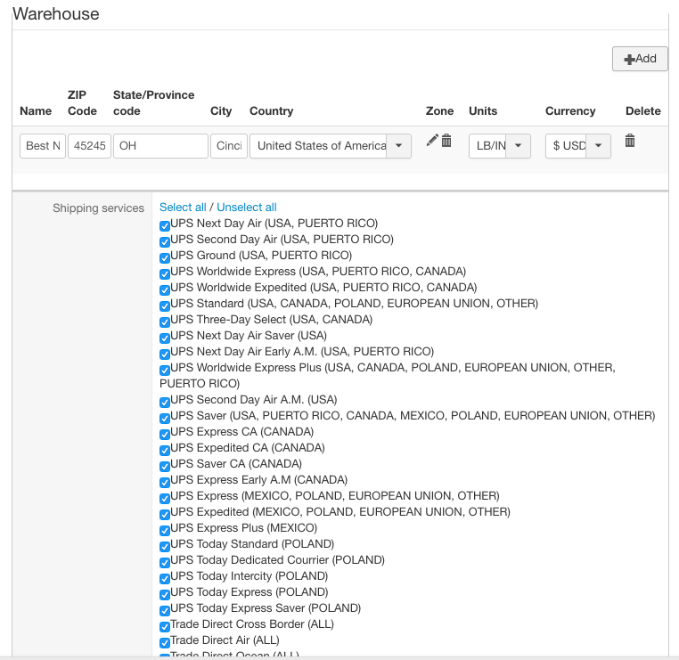

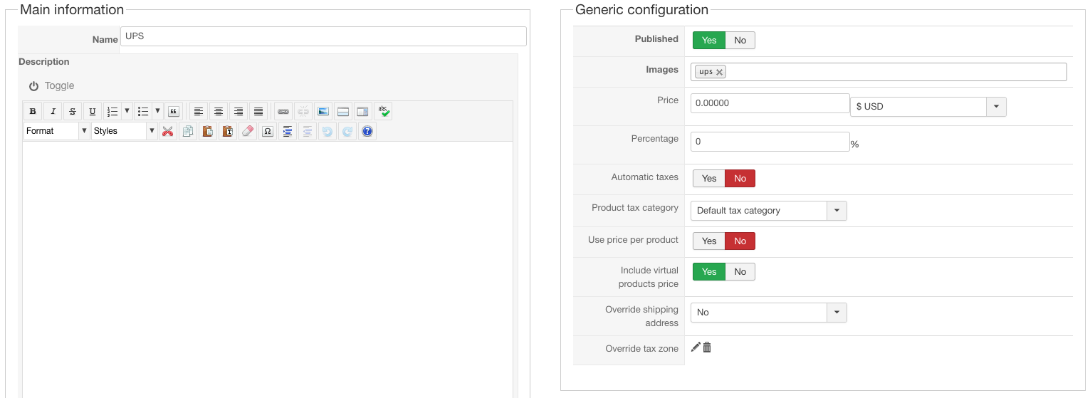

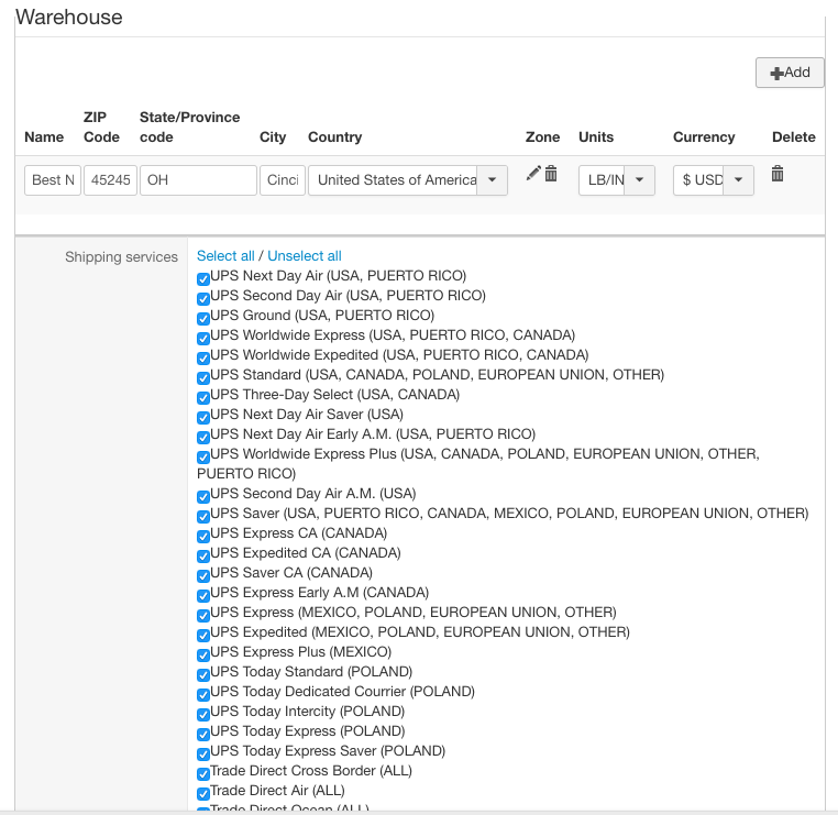

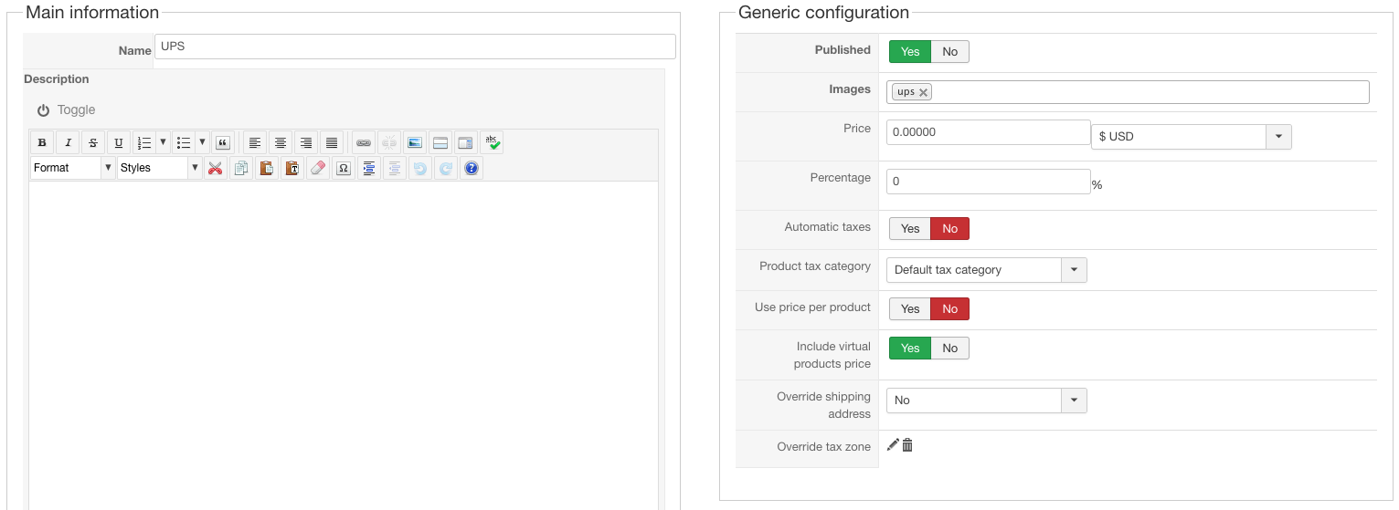

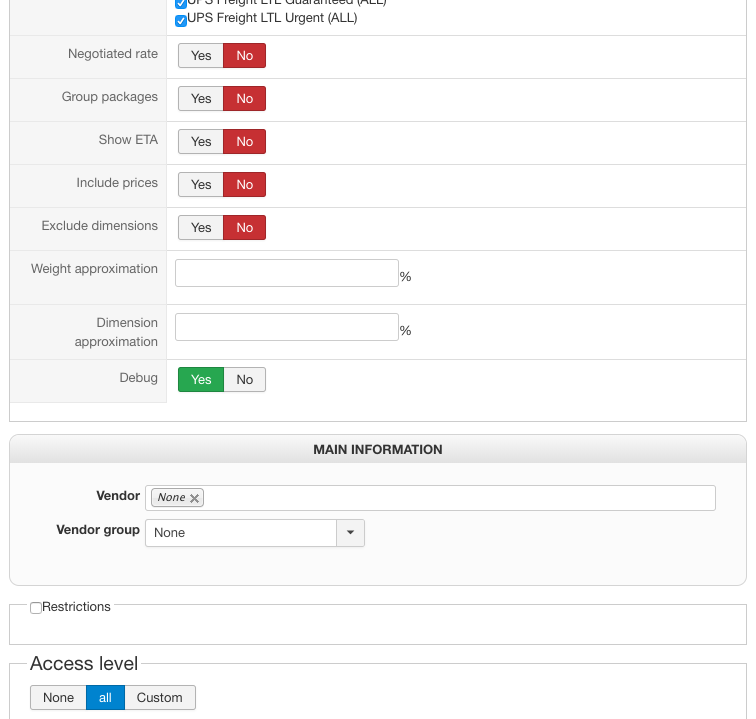

I have HiksShop and HikaMarket loaded on a site. I am using UPS for the shipping method, but when I check out, I get the note: "No shipping method found". See screen shots for plugin settings. I do have the UPS Access Key, UPS User ID, Password, and Shipper number entered in the shipping plugin. If I activate the manual shipping plugin, that shows up. I've checked all the items listed in your FAQ www.hikashop.com/support/faq#ship and haven't seen anything wrong. What am I missing? By the way, the site is in maintenance mode right now.

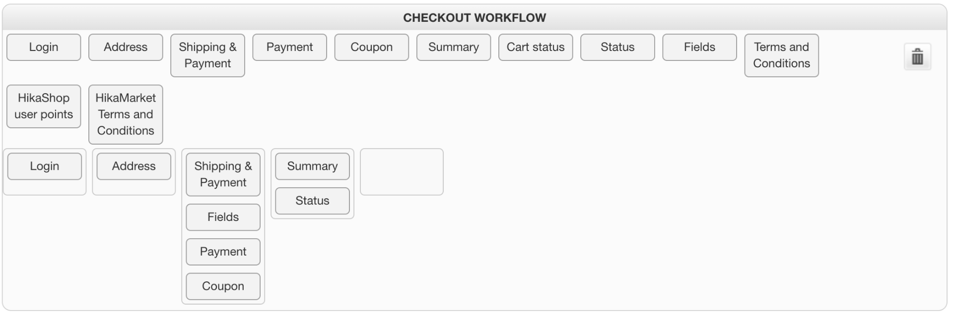

Your UPS shipping methods seems to be correctly configured, can you also show us how you configured :
- Options of the "Restriction" tab through your UPS shipping method configuration page.
- Dimensions and weight options of the product which was added to your cart during your test.

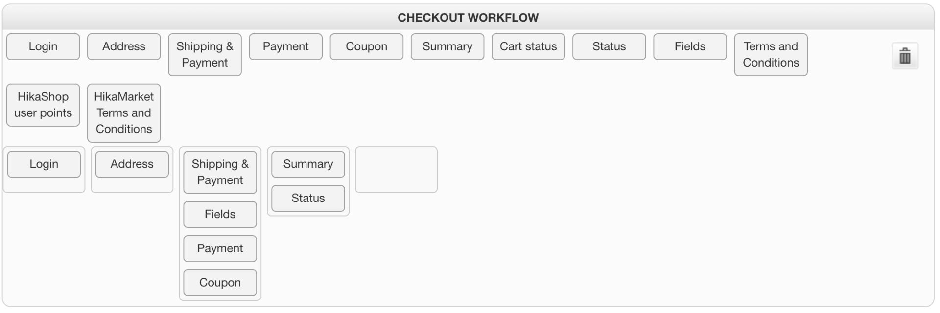

- Your checkout workflow via "Hikashop->System->Configuration->Checkout"
  • Posts: 109
8 years 6 months ago #289263

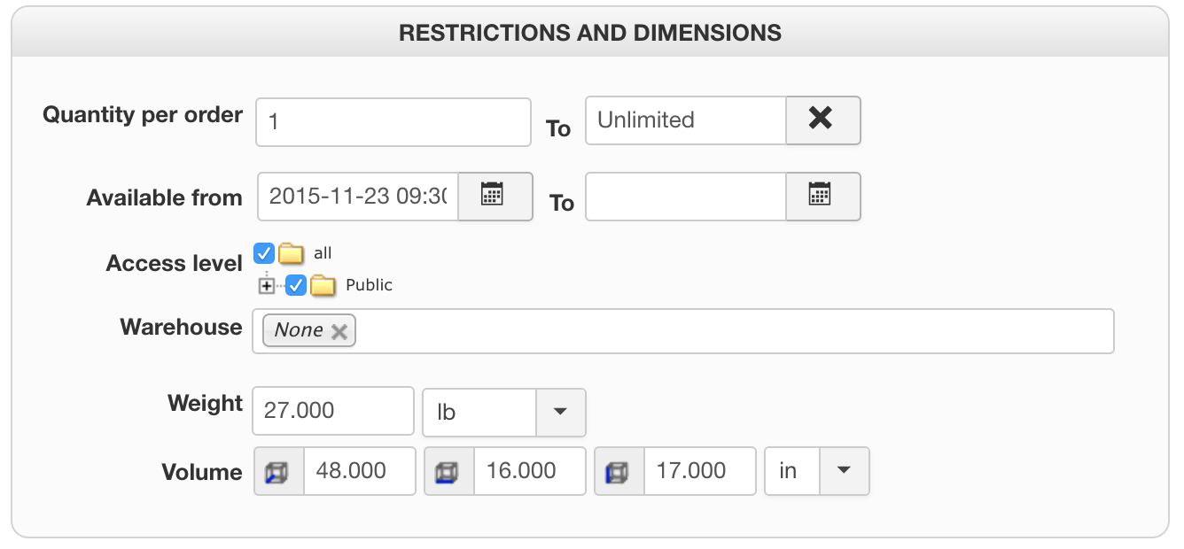

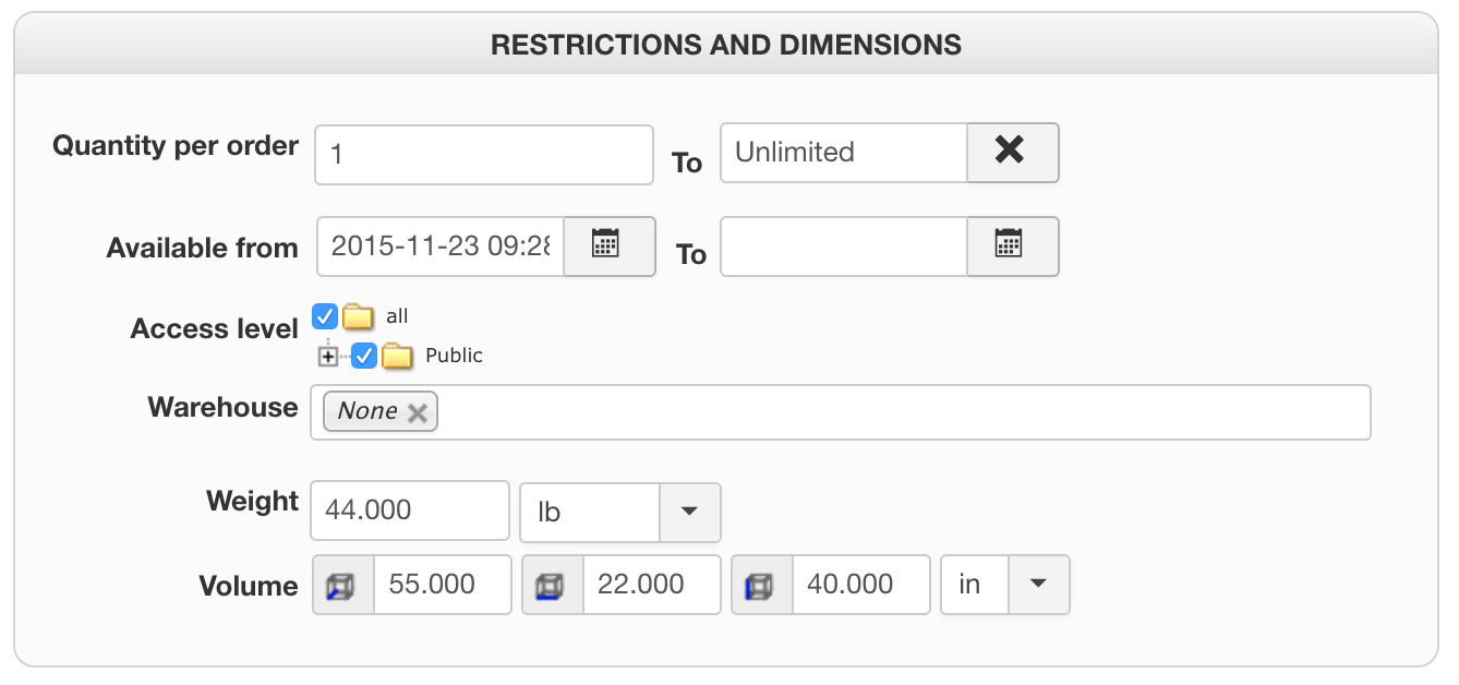

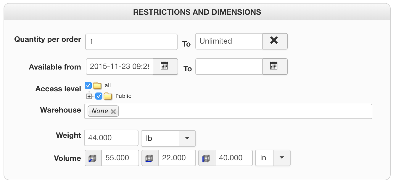

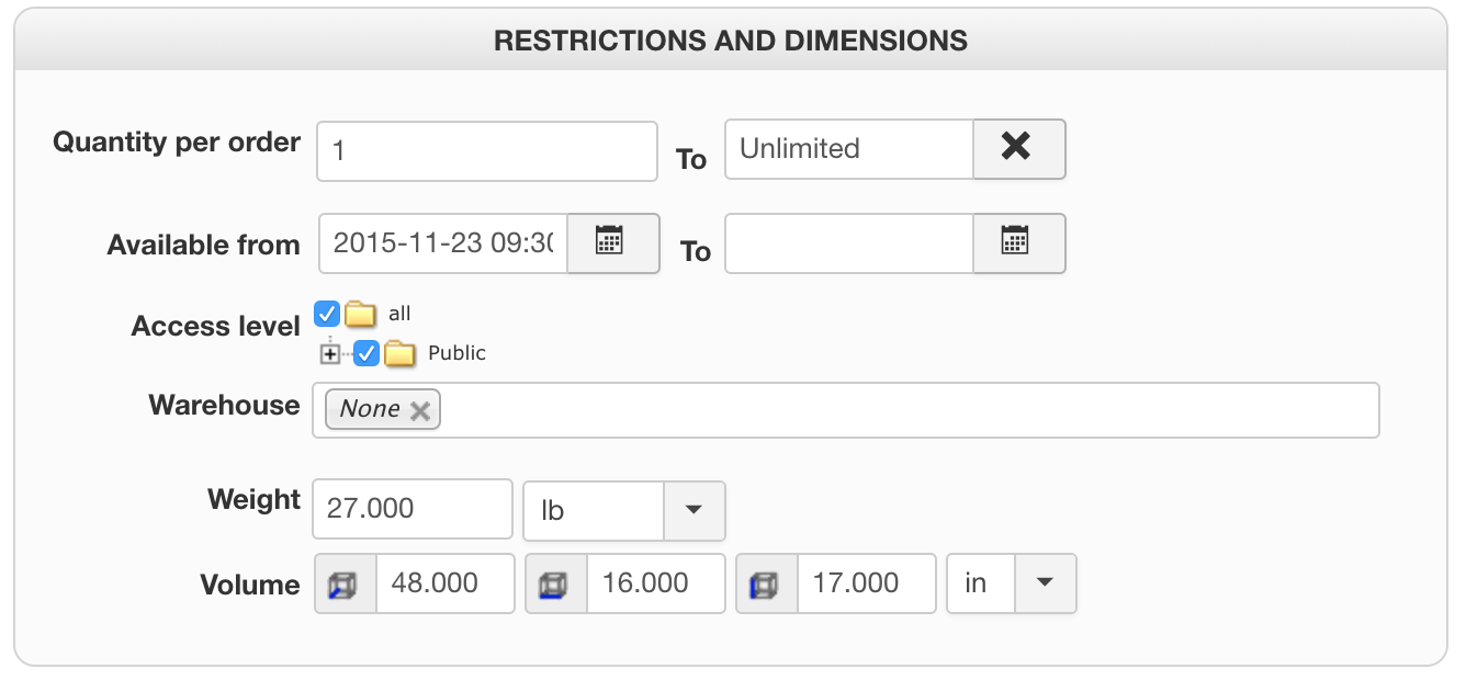

The restrictions box was on one of the screen shots i already provided which shows no restrictions set. I have tested with a few more products and found that some bring up UPS shipping and others don't. I am attaching the weight and dimensions of one that worked and one that didn't, as well as my work flow. So you know, in my work flow I have renamed the "Shipping" step to "Shipping & Payment". I can not see any meaningful difference in the products that work and the ones that don't. Thank you for helping with this!

Do you have variants or options for the products ?
Could it be that the products for which it doesn't work are too heavy or too voluminous for your UPS merchant account contract ?

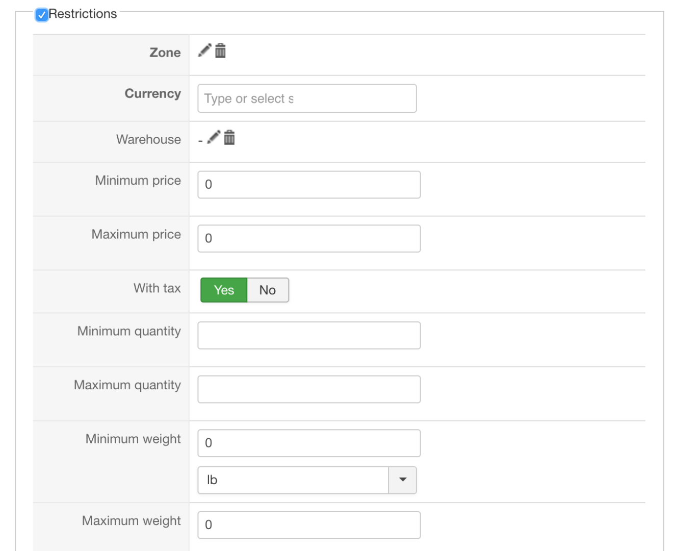

8 years 6 months ago #289370

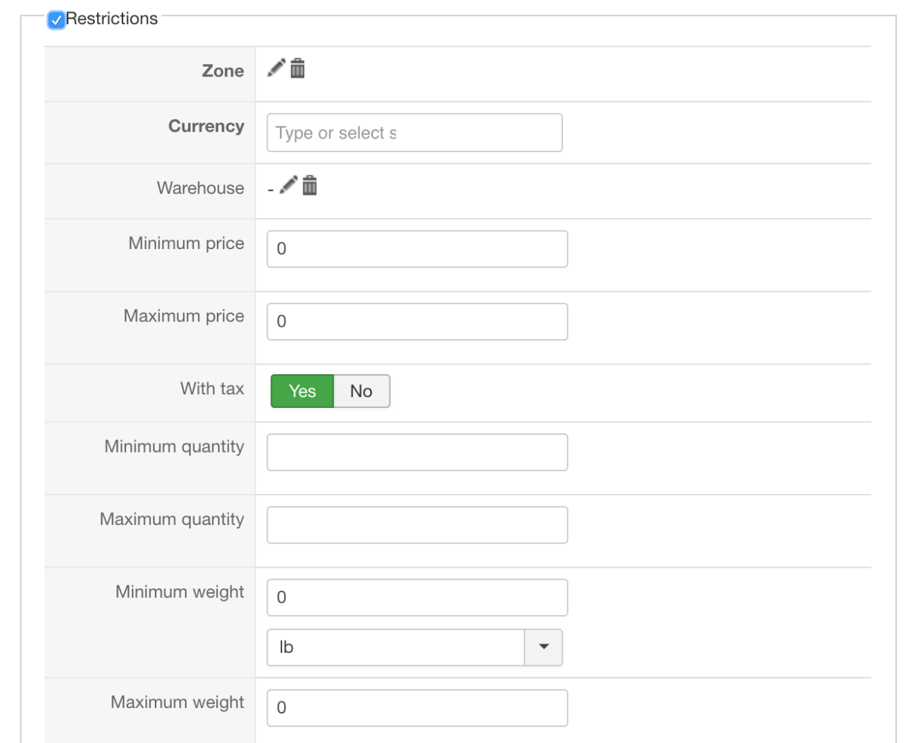

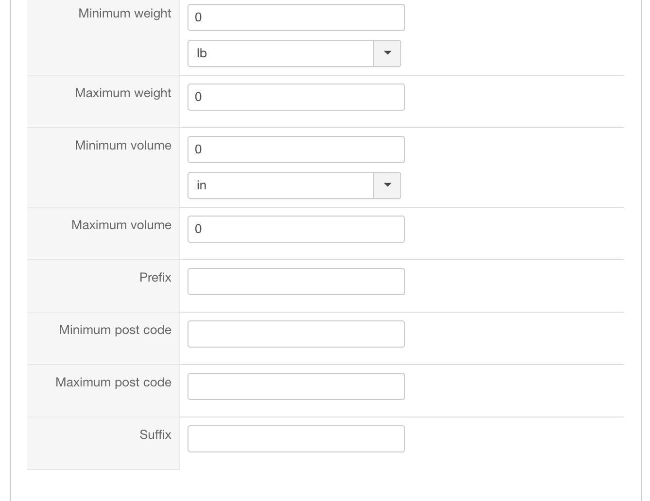

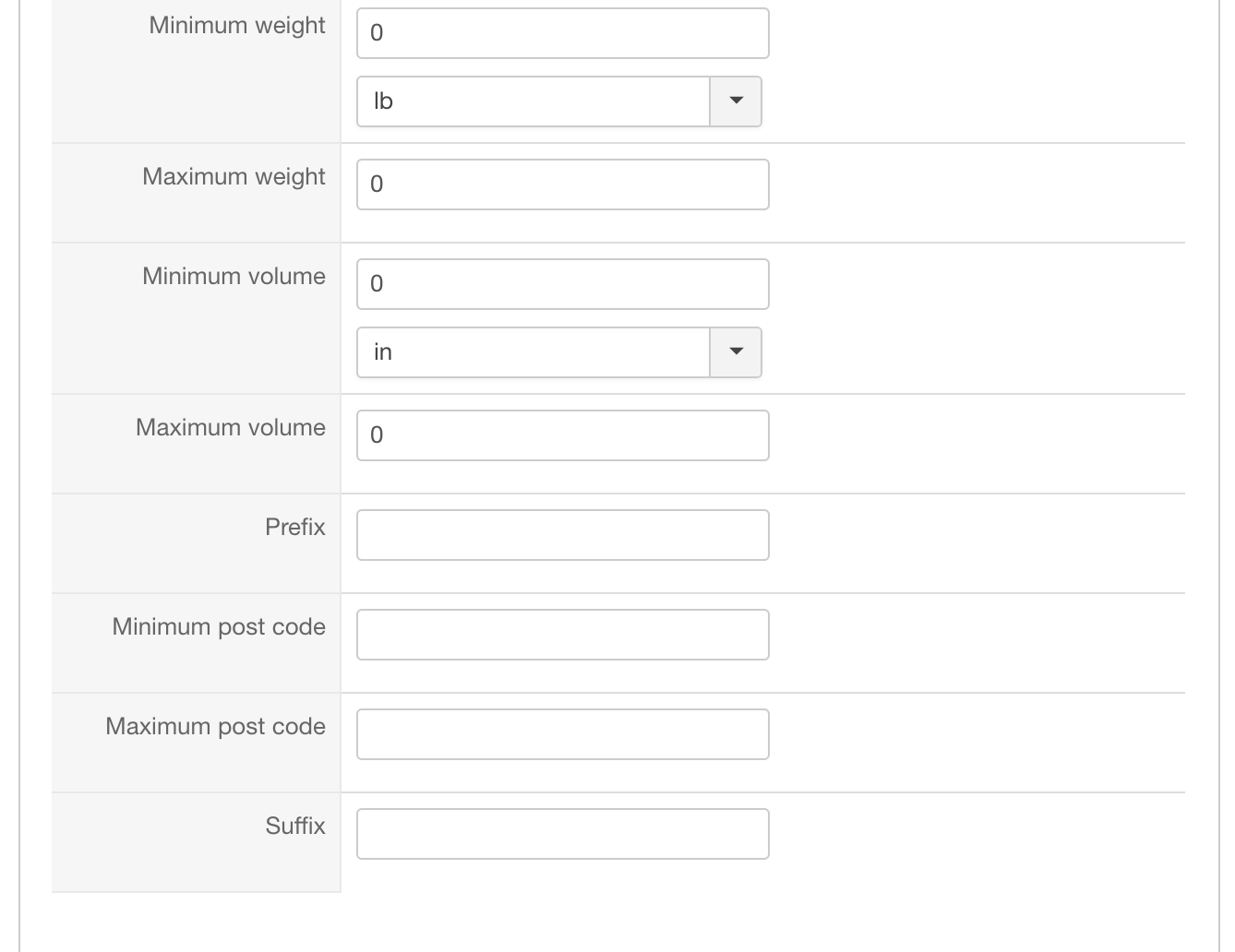

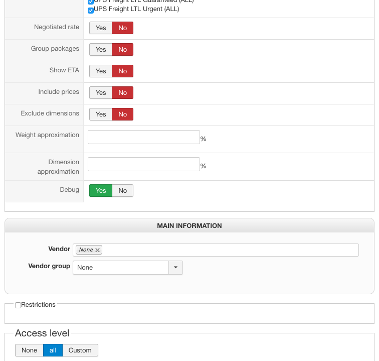

To be able to see shipping "Restriction" options, you'll have to click on the restriction checkbox. so can you check it and confirm that these options aren't used ?
Thank you.
  • Posts: 109
8 years 6 months ago #289493
Attached are screen shots of my restrictions for the UPS shipping method. I'm still trying to find out if there are any weight or dimension caps in the UPS account contract.

So with the limitations, some of the products are exceeding the limit. They use the formula Length + 2x Width + 2x Height. So, for example, 55 + (2 x 22) + (2 x 40) = 179”
Looks like if a product exceeds the limit, UPS won’t return a shipping cost.

We have already set these package size/weight restrictions through UPS shipping plugin's code, so it shouldn't send packages which will exceed these limits. The only problematic case will be if you have a product which exceed these limits in your cart.
Also turning the "Group packages" option to YES through your UPS configuration page will probably be better.

As its said on the documentation :
Group packages : If this option is activated, products will be grouped together. Otherwise, every product will have its own package (more expensive).

We just reproduced it on our end and information that are sent to the UPS platform seems to be correct and valid, the problem is coming from the product which have these dimensions : 55x22x40 in
The UPS platform is returning the following error message with that product :
<ErrorCode>111050</ErrorCode>
<ErrorDescription>Package exceeds the maximum size total constraints of 165 inches (length + girth, where girth is 2 x width plus 2 x height).</ErrorDescription>

We have found out that my client LTL account was not connected with his small package UPS account. That has now be corrected. Their website should be able to pull up small package rates and LTL rate. Small package rates still come up in testing, but LTL rates still do not. I have the debug turned on in the UPS plugin, but I don't see any debug info to refer to. I have also turned on the Joomla! debug but I don't see anything there regarding UPS. I'm using a Mac, so I have tried pushing fn + F12, but it doesn't produce any results either. I also switched to a default Joomla! template to make sure it was a template issue, but still I don't get any debug info. Where would I find the UPS debug info?
