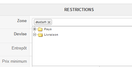

I've updated to version 4 and when I create a shipping method the restriction can only be applied to one country and it doesn't show the shipping zones I had created so I can't choose any of them. It shows an empty file "Livraison"
it shouldn't be empty as I've got 4 shipping zones working perfecly.
It was working fine with previous version of hikashop
Please, can you help
thank you

That was indeed a bug introduced with HikaShop 4's new interface.
We've added a patch for it.
Download again the install package of HikaShop 4 in the menu My account>My subscriptions and install it on your website and that will add the patch for that.
