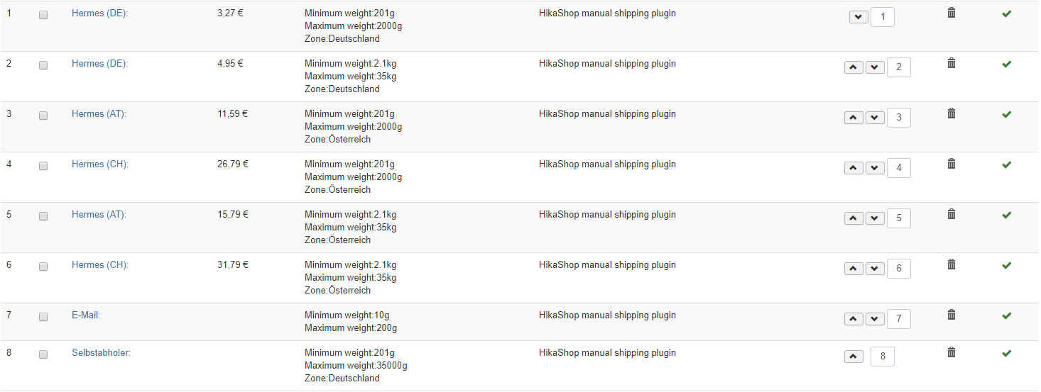

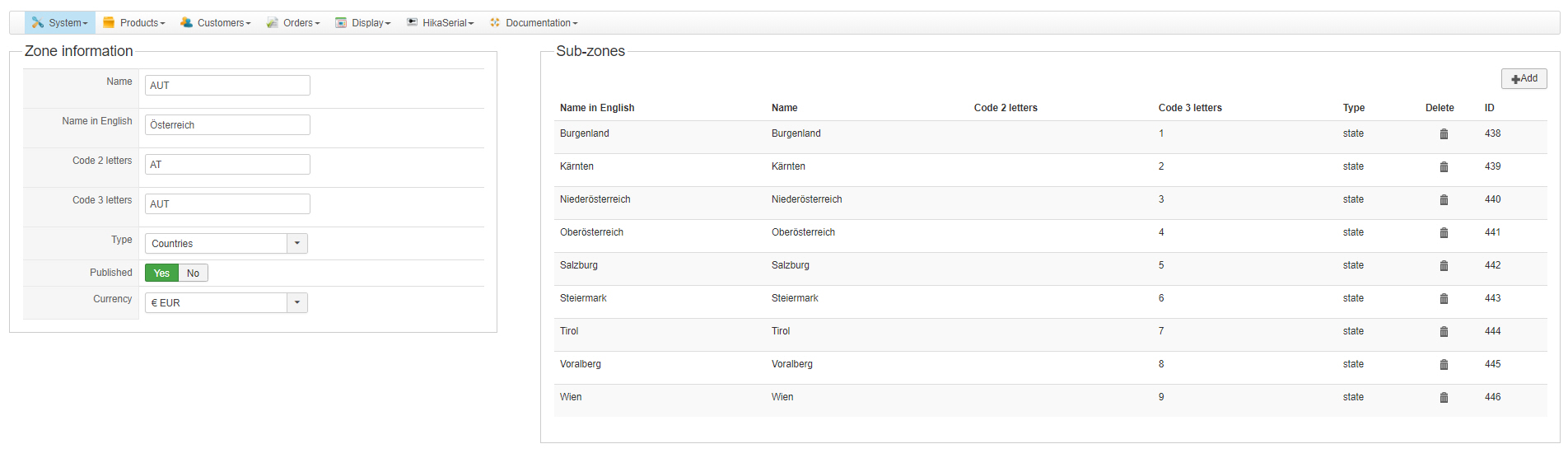

I have the same issue and the setting doesn't work in my shop. I had two different, manuel shipping options for Germany based on weight. That worked fine. Now I copied them and set in the first two the Zone to Germany, in the two new ones the Zone to Austria (same settings for weight, but differnet prices for shipping to Austria). Both countries are activated with the respective sub zones underneath.
If I go into the checkout with one product it shows me as a standard Germany as a country and also the 16 states in the dropdown. If I change Germany now to Austria and any state below, the shipping cost will stay those for Germany. They only change if a put another item in the basket (so based on wieght the hight shipping cost will be selected). But only for Germany. It looks like Austria will not be taken in consideration at all.

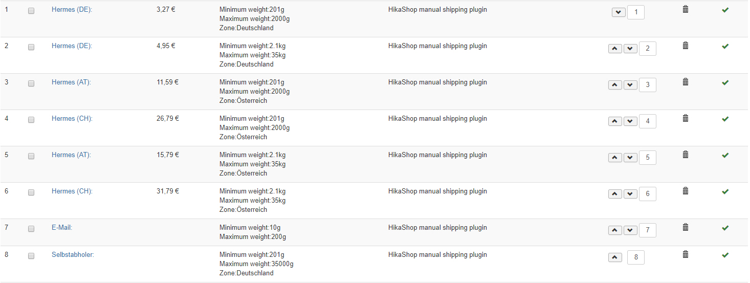

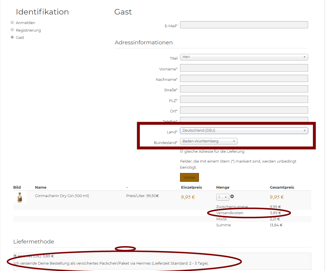

FAQ didn't help. What I did.
I have for Country Germany two Shipping Methods which are working perfectly based on the restrictions I did within the products and shipping methods. Based on the weight either the cheaper or the more expensive shipping method will be taken from the system. In the shipping methods I also restricted by Zone Germany.

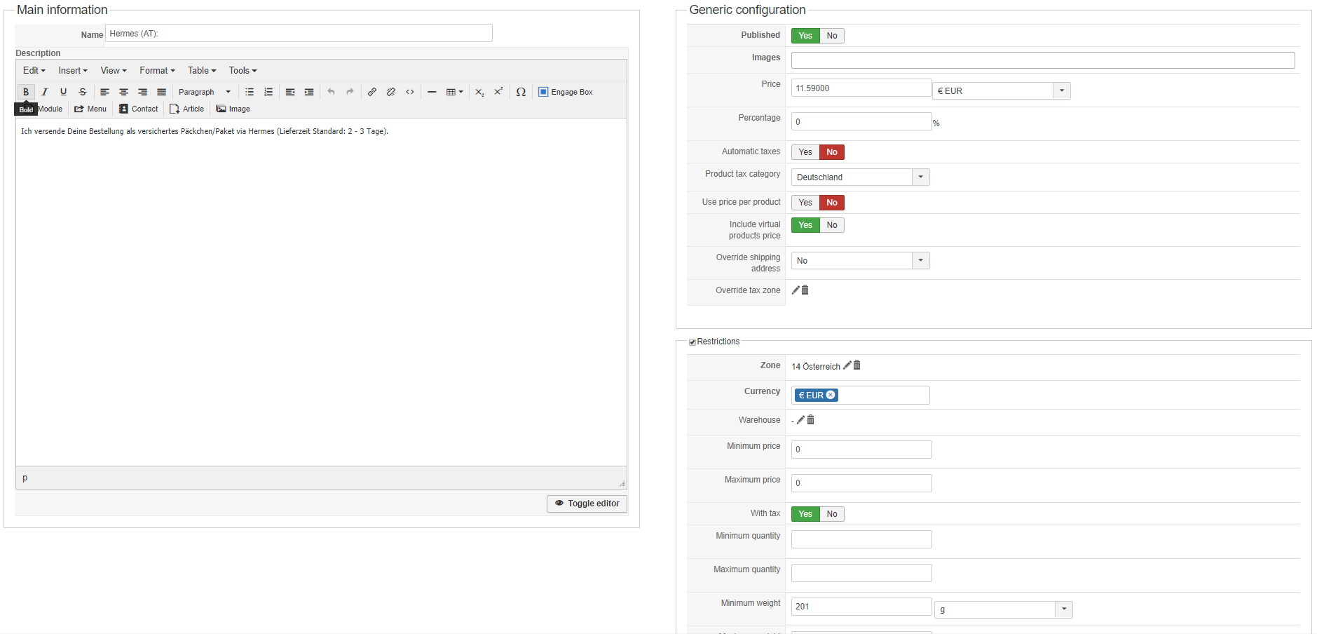

So I copied the shipping methods from Germany now to Austria and Switzerland with the difference, that I adjusted the price for it and also the zone restriction (two more (see screenshot):
The shiping methods are setup like this (for all 4):

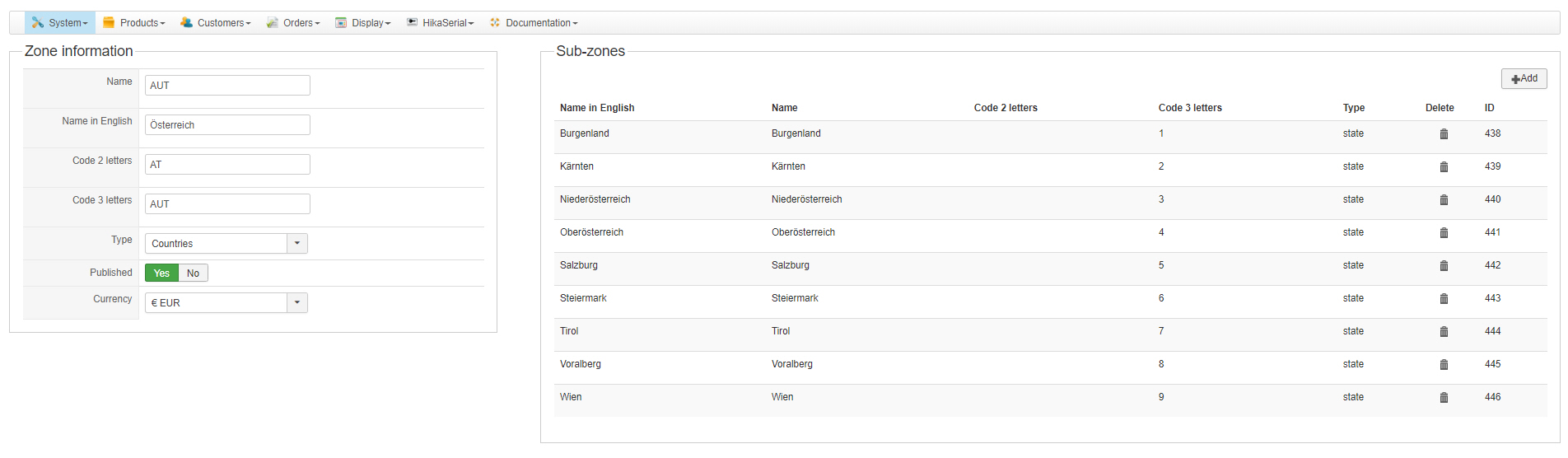

I additionally setup the zones and activated them (so I have only Germany, Austria and Switzerland as countries and the respective regions within this counties active) - they are also shown, when active, in the shopping cart at checkout (see next screenshots)

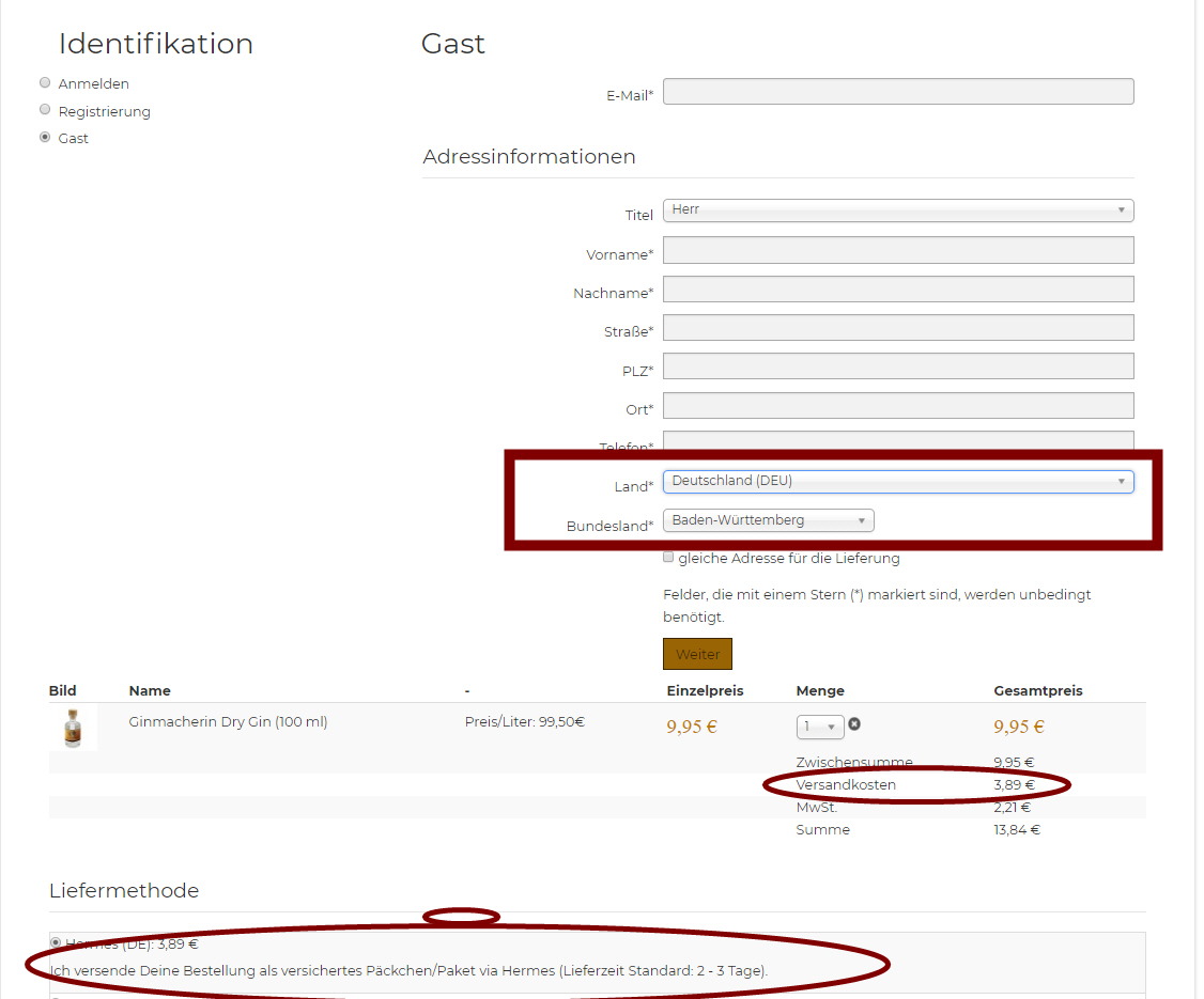

When I enter now the shopping cart and select GUEST as checkout, I can select all Countries (Germany, Austria, Switerland) and in the Dropdown below based on the country the regions. But when I select for example Austria as Country, the shipping cost stay extacly the same (Germany), nothing changes based on that selection.
What Do I miss here? Thanks for help.

The filtering of the shipping methods happens based on the address of the customer.
As long as you don't click on the "Weiter" button of the guest form, the address is not taken into account. Only then will the filtering of the shipping methods apply based on what country you selected in the address.
So in your case, you might want to change the checkout workflow ( in the checkout tab of the HikaShop configuration) to have two steps so that the shipping fee is not displayed before your pass the login/registration/guest view.

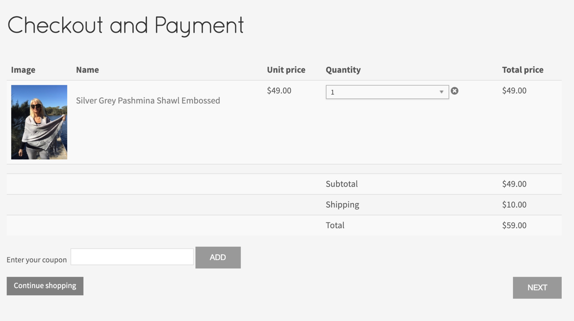

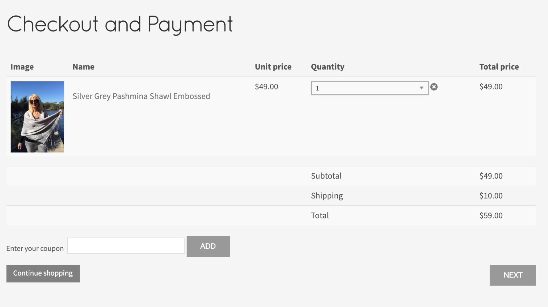

I experience a smiliar problem. I used to only sell to Australia, now I am opening up to New Zealand and UK.
I have now ordered the steps to show the cart first, then the address then the shipping costs. However, the shipping costs are displayed in the first view of the cart - see screenshot:

If you access the checkout while logged in, it will automatically use the address you already have to pre select the shipping method. So the shipping fee you see will already be the ones that should apply to you.
If you access the checkout while not yet logged, then it will use the "main tax zone" setting of your HikaShop configuration as the current zone to pre-select the shipping method. So if you don't want any shipping method to appear at that point for non logged in users, you could select a main tax zone without any shipping methods available and that should not it.
Note that because of the caching done, you'll have to try after clearing your browser's cache and logging in and out.
