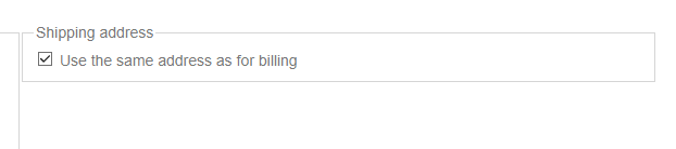

  • Posts: 40
6 years 10 months ago #312322
there was some server issue, so you may not have been able to access website, but its working at the moment,
still here are the screenshots..
in this screenshot, you see i have set different shipping address as default, prntscr.com/pmoo5q
but when login to frontend, and going forward to checkout, it is defaulting to "Use same as billing address" with checked, which i do not want, people complaining about it, even if they set different shipping address, they have to uncheck everytime the checkbox you see in screenshot attached and select shipping address.
So need to make so that if there is default shipping address set by people, then check box should not be checked and default shipping address should be automatically selected.
let me know if that can be done,
Thank you.

6 years 10 months ago #312326
Looking at your website, I can see that you're using the legacy checkout. That checkout dates from several years ago, before we were even thinking about splitting the billing and shipping addresses into different types of adresses with the possibility of having a different default one for each type.
I would recommend to turn off the "checkout legacy" setting in your HikaShop configuration in order to use the new checkout system.
It should then work better.
