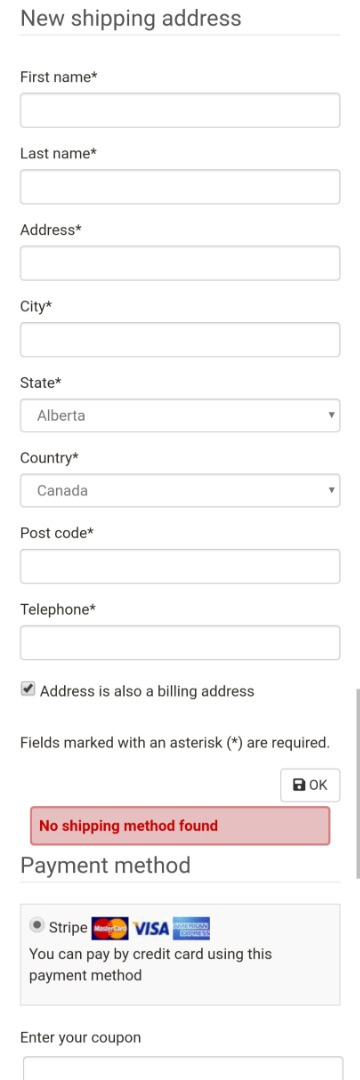

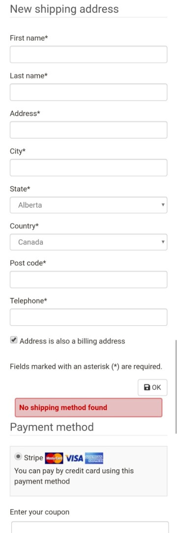

  • Posts: 27
5 years 10 months ago #323419
I used my personal address in the attached form
  • Posts: 26366
  • Thank you received: 4069
5 years 10 months ago #323422
In the screenshot you provide, there is no address and HikaShop propose you to create one.
Please understand that the CanadaPost Advanced plugin required a logged user and a valid shipping address.
If you do not want to share your address, please try with a random address in Canada (like an official building, etc).
Also, the postcode should not contain space.
