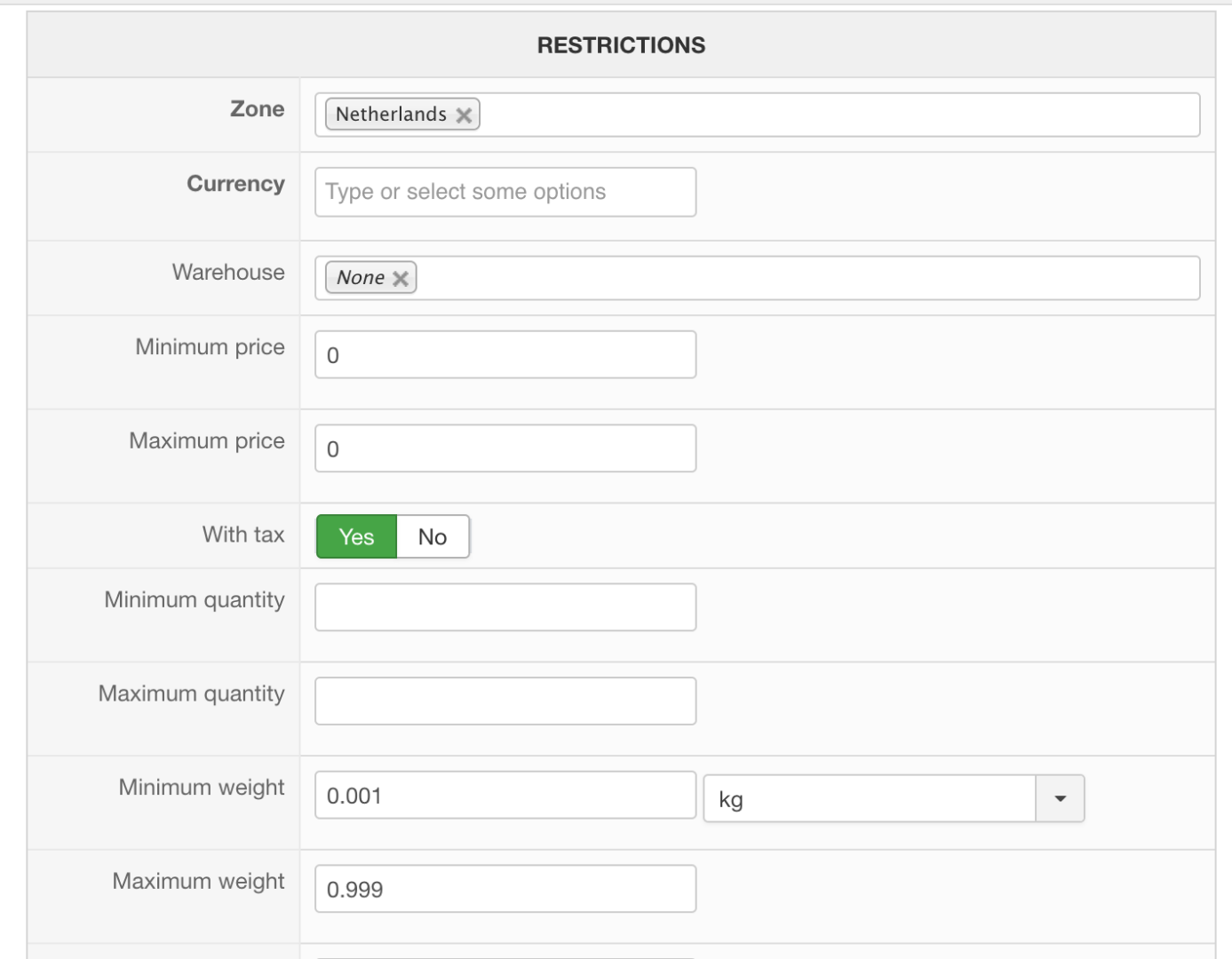

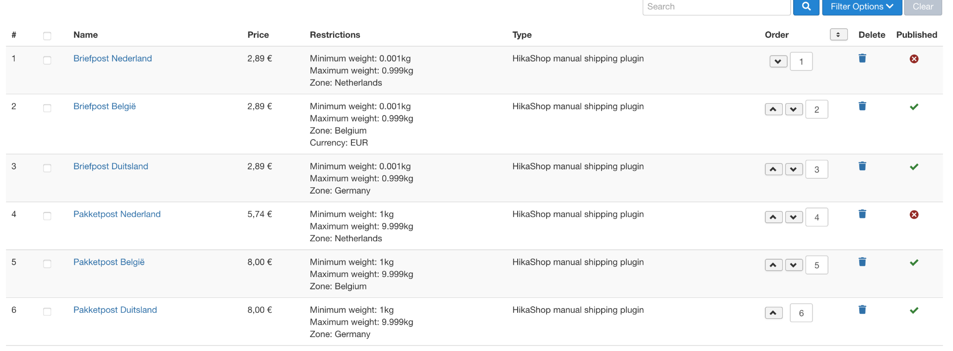

6 shipping methods: letter post (0.001 to 0.999 kg) and parcel post (1 to 10 kg) each with a restriction for zones mentioned below)
3 shipping zones (Germany, Belgium and Netherlands) with the same countries as sub-zone.
Activated 'Force shipping regardless of weight'
Unfortunately only the 2 variants for The Netherlands are working. What can be the issue here?

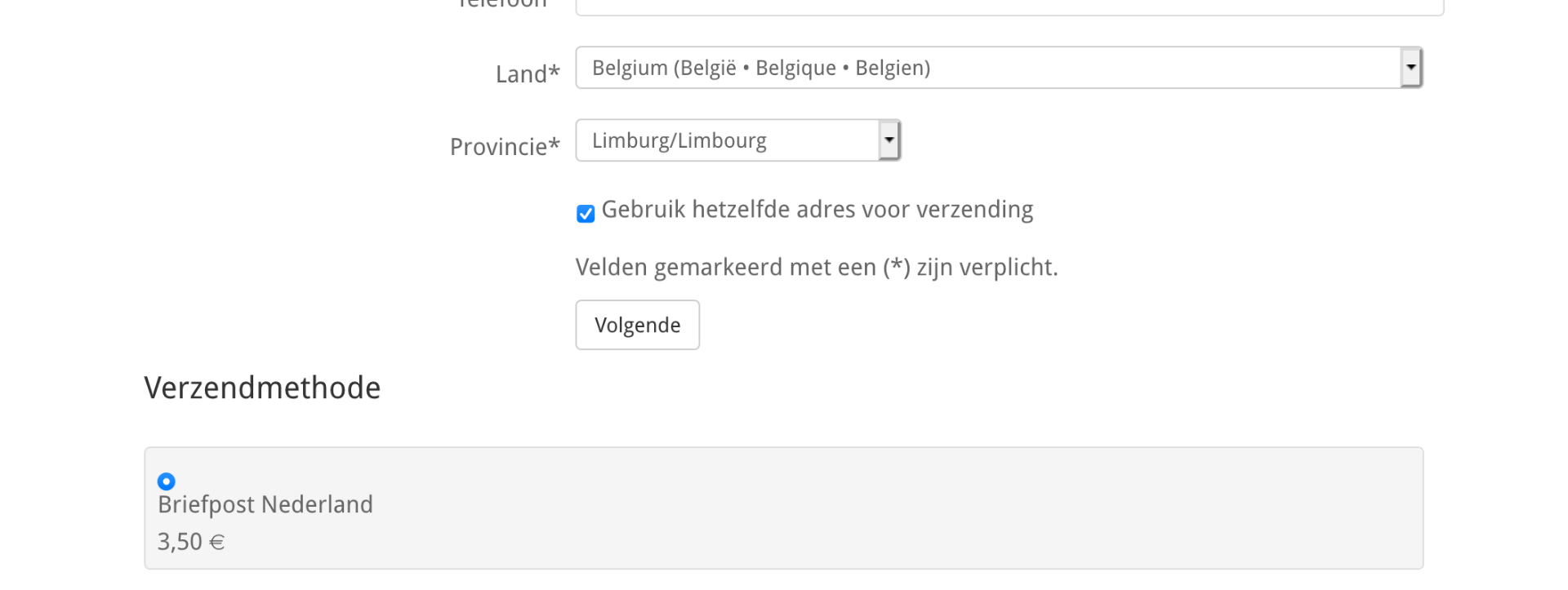

Well first, note that the shipping methods area will only refresh after you validate your address.
So on your screenshot of the checkout, since you didn't yet click on the "next" button, the shipping methods still think that your zone is the one you configured in the "main tax zone" setting of the HikaShop configuration.
Once you click on the next button on the screenshot, it will validate the address and update the shipping method area and it should hopefully be what you expect.

Thanks very much, it's working ;-) I was expecting to change the shipping and payment method as soon as changed the country and never clicked the next button!
