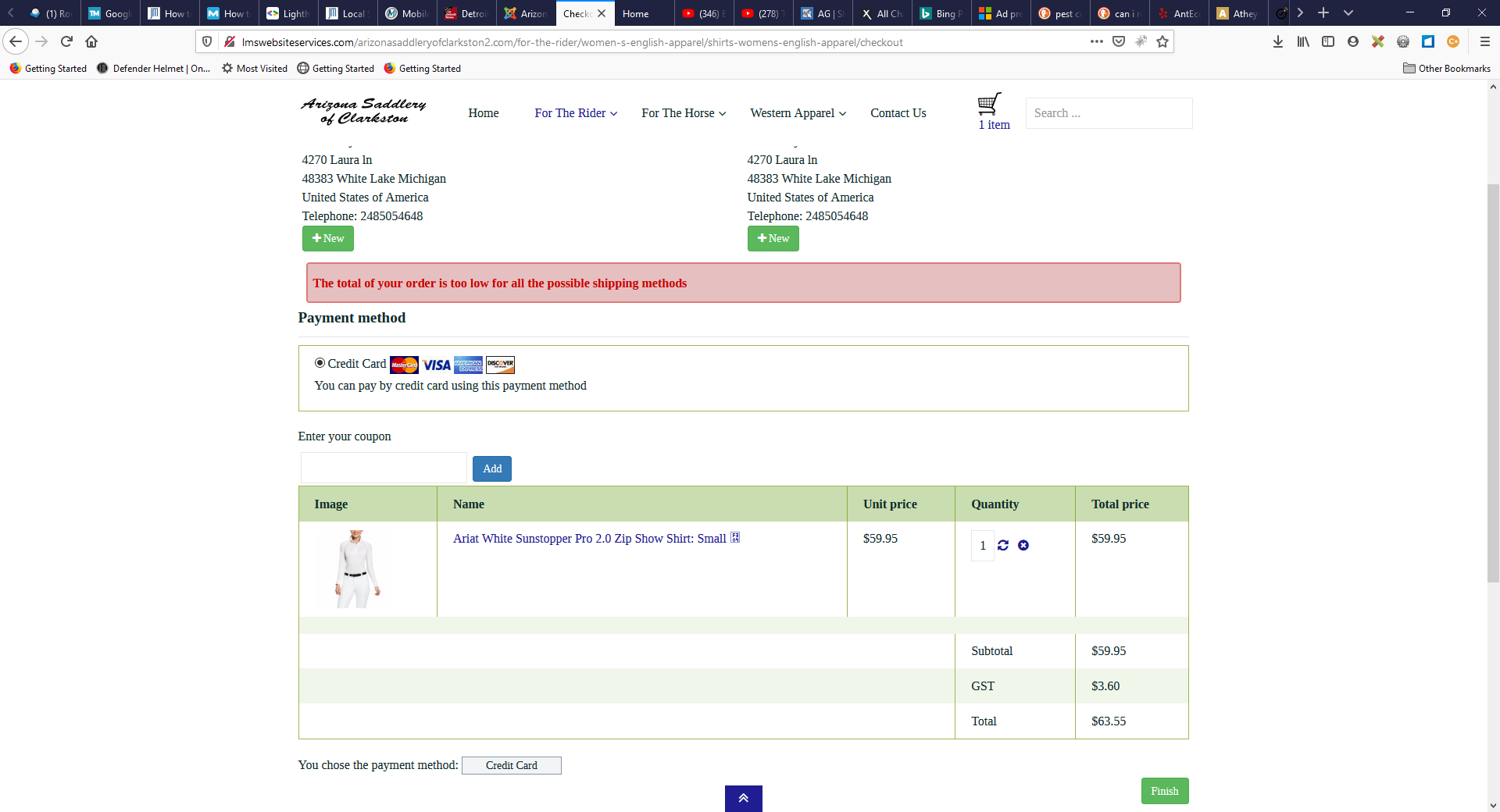

I have two shipping methods. A UPS shipping method for all orders less than $100 and a manual shipping method for any order over $100.01. The manual shipping method seems to work but I get error "The total of your order is too low for all the possible shipping methods" when I try to check out with an order for less than $100.

That error message is displayed because :
- The UPS platform didn't returned any rate for your order
- The manual shipping method should be available for your order if you increase its price.
So your issue is mainly linked to the fact that the UPS platform didn't returned any rate. You should check your UPS plugin configuration page and also check that your product have a weight / dimensions configured.

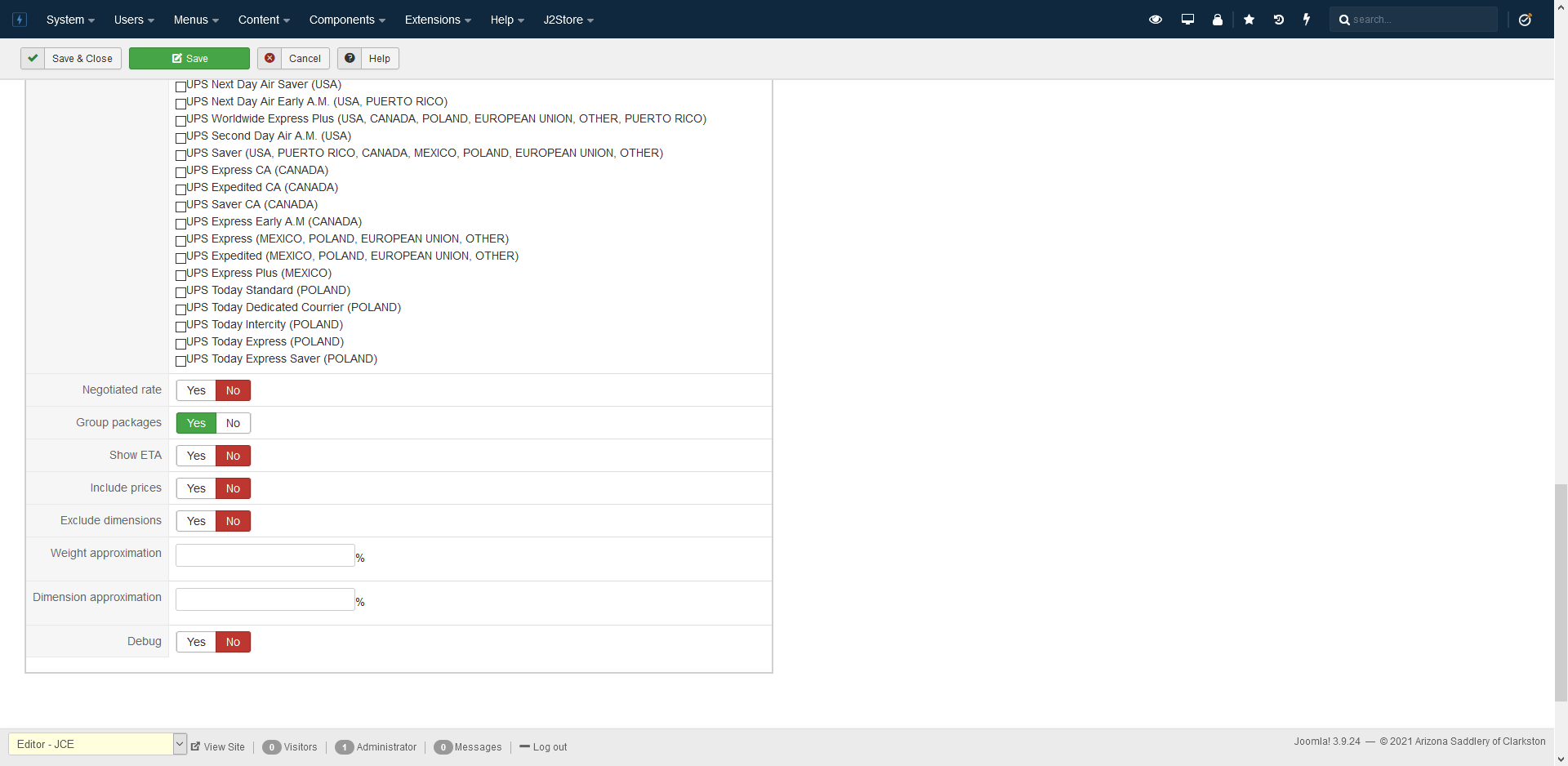

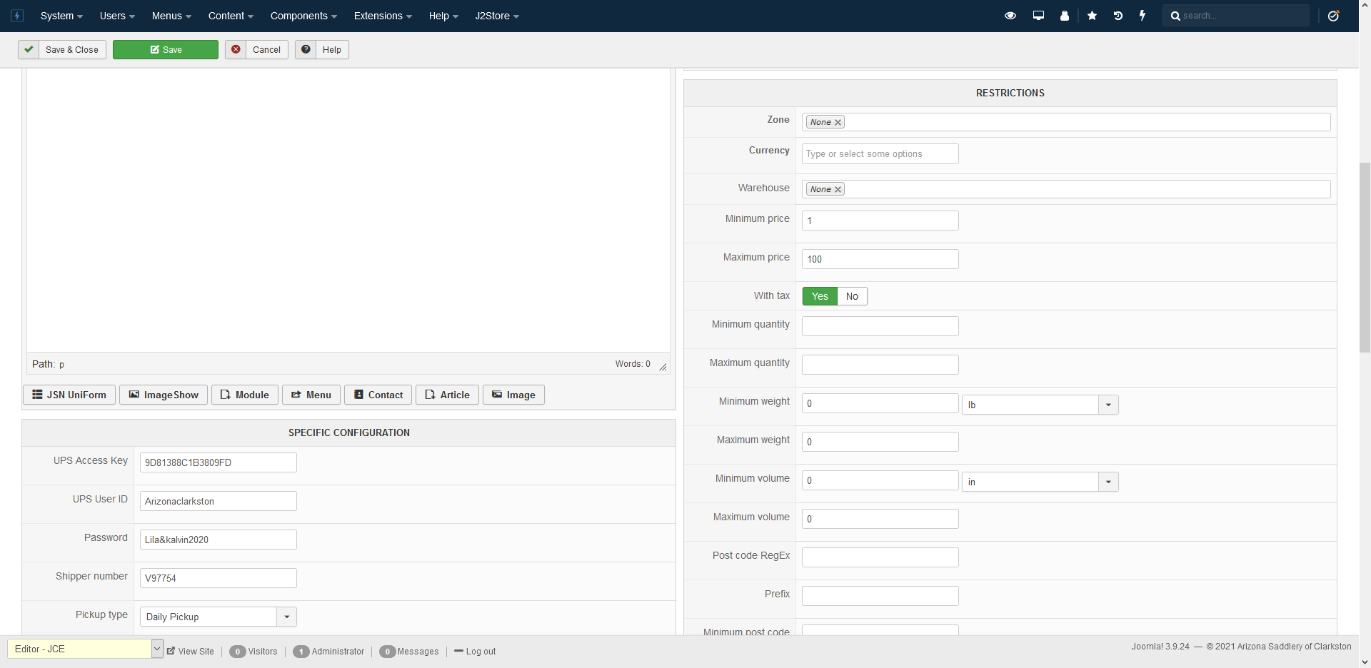

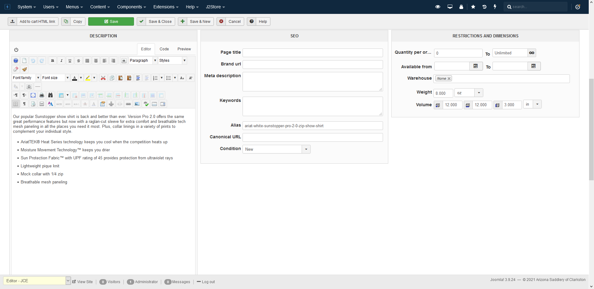

We can't really tell you without more information if it's coming from the UPS platform, can you show us some screenshots of how you configured your :
- shipping method
- products dimension / weight that were on your cart during your test

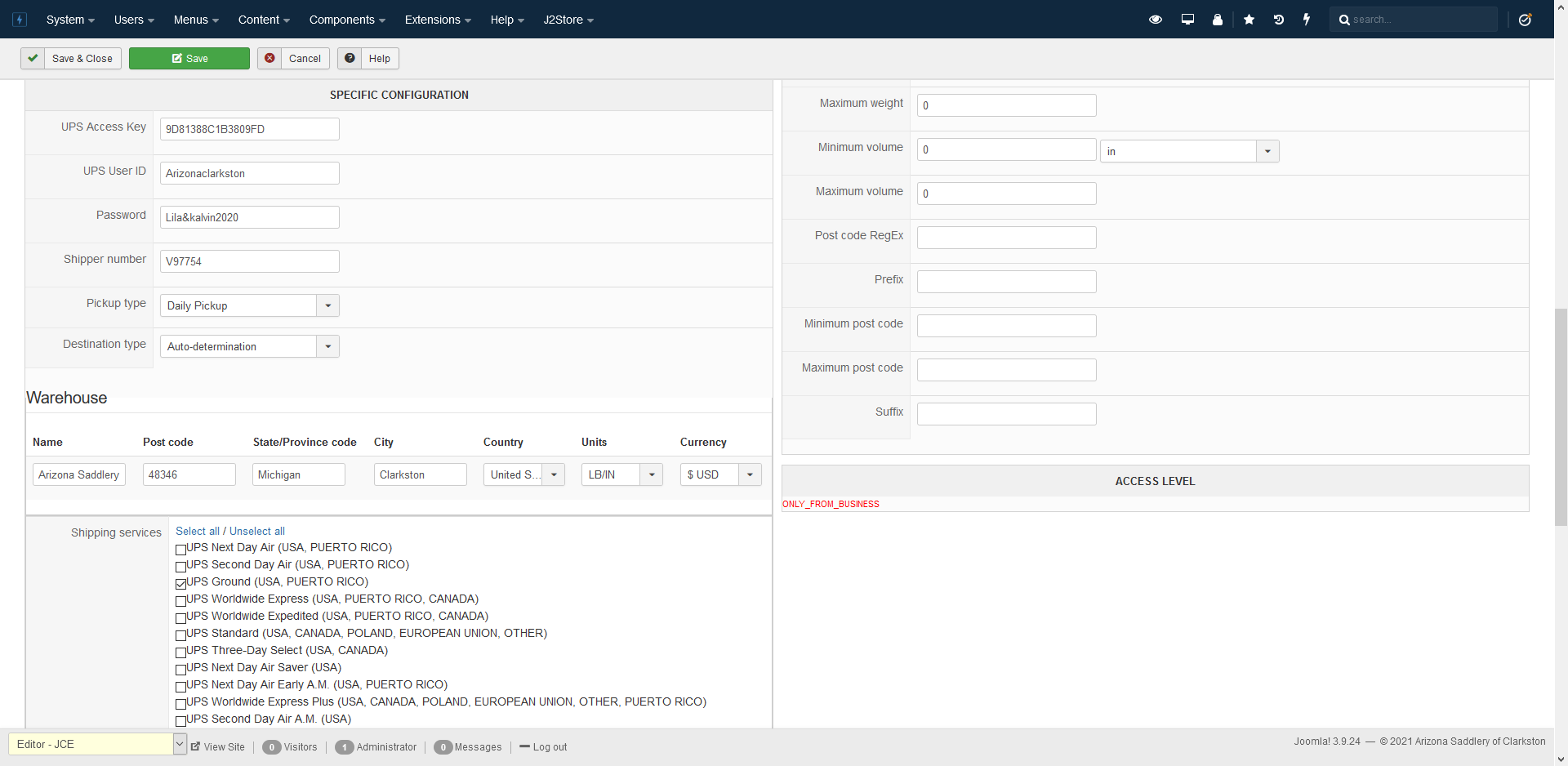

I think your issue is coming from the way you have configured the "State / province code" option through your UPS configuration page.
You should replace Michigan by MI and test it again.

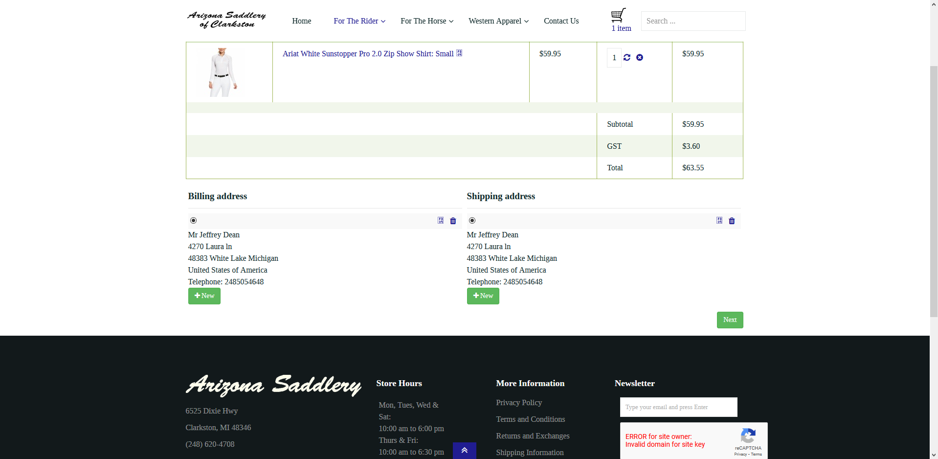

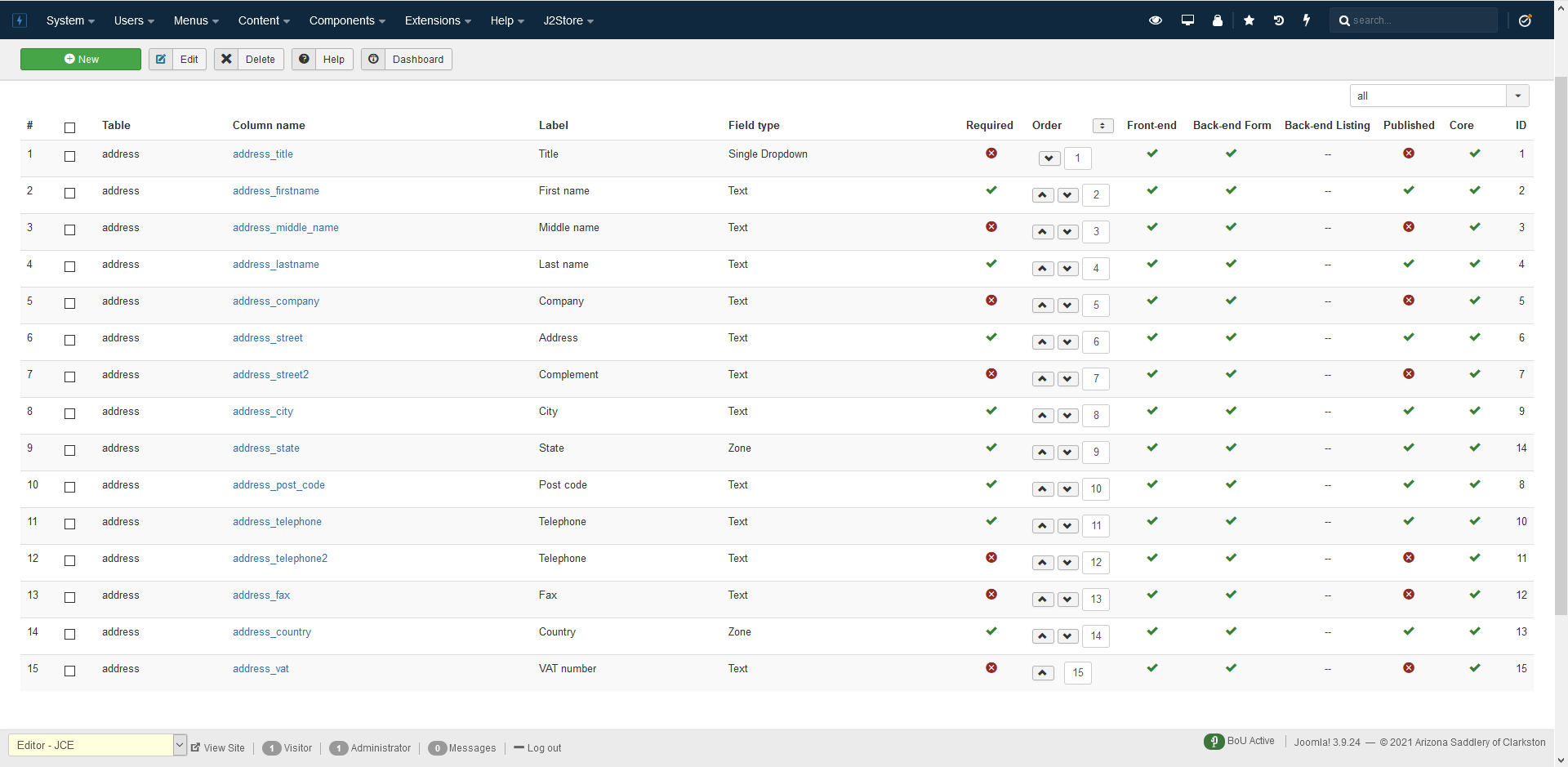

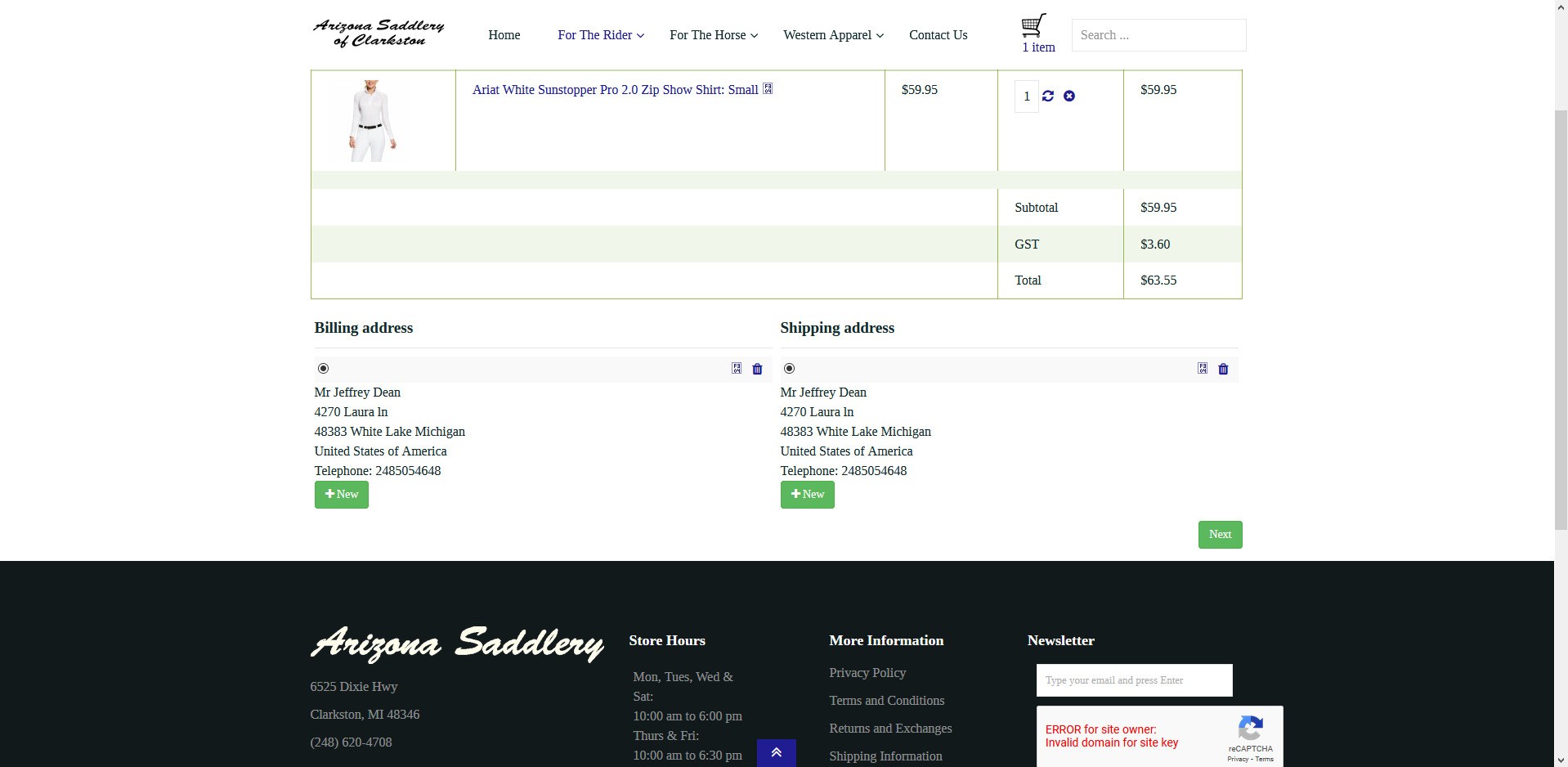

Ok. That didn't work. Look at this image, what about the fact that the zip code is showing up before the city and state? I went into display > custom fields and changed the order and it doesn't seem to affect the front end at checkout. Could that be the problem?
I changed the address_title to unpublished and it does disappear but the order doesn't change....

5 years 7 months ago #328685
Ok, I found the address format area and changed to to show City State Zip Code in that order and it still shows "The total of your order is too low for all the possible shipping methods". So now I'm not sure what else to try.....

Okay, I found the issue. Finally. I didn't realize there was a United States Minor Outlying Islands and a United States of America. I just realized I had set the warehouse as United States Minor Outlying Islands instead of United States of America. So that was throwing off the UPS API probably. Anyway, it seems to be working now so thanks for all of your help. Your suggestion that Michigan should be MI sent me on the path to double check all of my warehouse settings. Thanks again....
