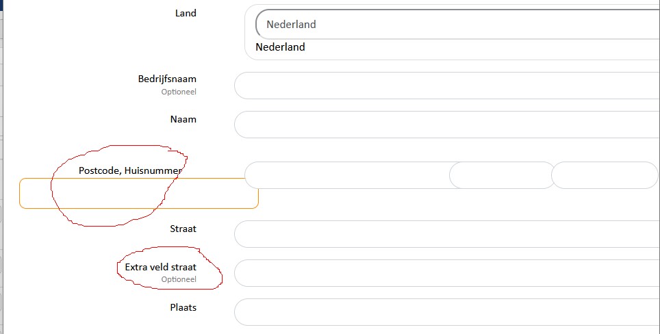

I've updated an outdated 2020 version of the Myparcel label and track plugin. Now we use version 1.1.4
In our address configuration street and house number have two seperate fields. The house number is in field address_street2.
To make that work in the old plugin we added custom code to myparcel.php like Nicolas suggested in the forum. That worked fine.
After the update this hack is unnecessary since Hikashop added a house number field in the settings of the plugin.
But now the house number shows twice in the labels! The number is displayed in the same line as the street name and once more in a new line.
See screen prints.
Please advise.

3 years 8 months ago #348319
You should:
- create a new custom field of the table "address" to store the house number
- change the "address format" setting in the HikaShop configuration to add the corresponding tag
- run an address mass action to copy the address_street2 to that new custom field for all the existing addresses
- run an address mass action to empty the address_street2 field
- change the settings of the MyParcel plugin to use that new field instead of the address_street2 field for the house number.
- optionnally, you can deactivate the address_street2 field or rename it to "additional information" or something like that so that the customers can provide extra information on the address.
