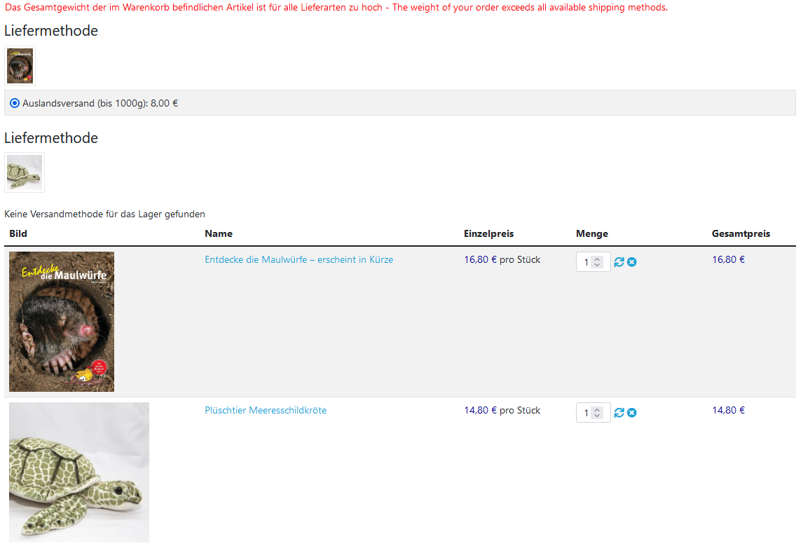

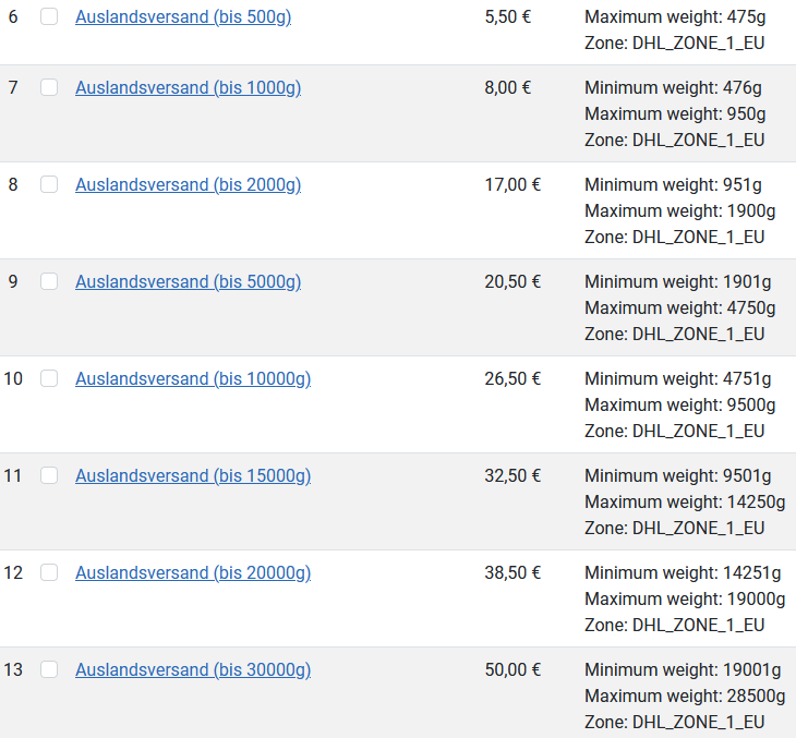

3 years 4 months ago #351040
Still wrestling with selling two different categories of products. I've given up on having different shipping methods for different kinds of products.
However, now this weird behavior occurs:
1. Put a product of category A in the cart
2. Put a product of category B in the cart
3. Go to checkout
4. Hika will say that the order weight exceeds the available shipping methods for the second product in the cart (regardless of actual weight)

  • Posts: 86177
  • Thank you received: 14212
3 years 4 months ago #351050
When HikaShop get the list of available shipping methods for a warehouse, it goes through the shipping methods one by one and each time a shipping method is not available, it stores the error message to display it to the customer.
So after going through all the shipping methods and finding no suitable ones, it probably has several different error messages but in order to not confuse the user, it only displays the first one.
So what you need to do is to temporarily disable the other shipping methods and only leave enabled the shipping method you think should appear for that warehouse and you'll get the adequate error message.
Note however that checking your screenshots, I think the issue is linked to warehouses.
In your screenshot of the checkout, what is displayed clearly indicates that the products are in two different warehouses.
But in your screenshot of the shipping methods listing, none of them are assigned to any warehouse.
I suppose that you might have just deleted the warehouses, thinking it would be ok.
You need to also run a mass action on the product data with an action "update the values" on the column "product_warehouse_id" to set that value to 0 for the products which you don't want to use a warehouse. Otherwise, the id of the warehouse is still in the database, even if the warehouse is deleted and the system will still group the products based on that.

3 years 4 months ago #351068
my impression was that setting no warehouse restriction on my shipping methods would imply that it can be used for products of any warehouse. This seems to be the case for the first item in the cart (It has a warehouse set, but correctly selects the shipping method which has no restriction set). It's only the second position in the cart that doesn't want to select the method (Remember that if I switch the order around, it's the other product that doesn't find a suitable method.
It feels like Hika disables all other shipping methods with the same warehouse value once one of them is selected for a product.
The problem does indeed resolve if I remove the warehouse value for the products in question. However, this is not an option, since we need to distinguish between those product categories for our national sales where our shipping expenses for category A are almost triple that of category B.
Is there no way to have shipping methods that apply to all warehouses? If leaving the warehouse restriction field blank is not supposed to accomplish this, maybe the field could be allowed to include more than one Warehouse?
