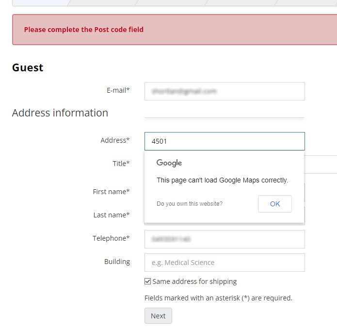

2 years 7 months ago #356737
when we use the auto-address look-up function it comes up with an error message, "google can't load maps correctly. Do you own this website?"
We're not sure if this is a know problem or something we have caused. Any ideas on how to troubleshoot this? We are using v5 of Hika.
Ian and Stu

2 years 7 months ago #356755
I can't checked your website as it is blocked for France were we are based.
However, I suspect it's because the APIs necessary have not been enabled in your Google Maps account.
I would recommend installing this extension on your browser and trying again:
chromewebstore.google.com/detail/google-...nkgeejmlkfeheihlehne
It should hopefully display to you what the problem is.
Otherwise, you can also open the console of your browser while reproducing the issue. The Google Maps javascript should display information about what the problem is in there.
