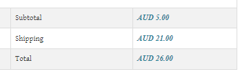

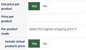

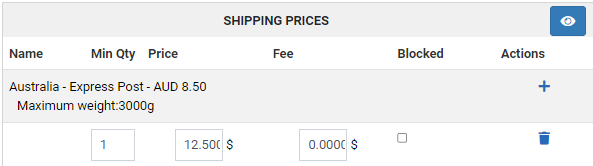

Unfortunately I am still experiencing an issue - after activating the setting for "Select the Highest Shipping Price"
My shipping method price is set at 8.50
When I add an item which has a higher shipping price defined at the product - the shipping is calculated at the 8.50 + the Product shipping of 12.50 and shows the value as 21.00
Any ideas where my mistake is ?
I am using HikaShop Business 5.1.1 [2409191121]

1 year 11 months ago #363370
I don't see a problem with your screenshots.
As I said 9 months ago:
Without the code change, HikaShop would use the sum of the shipping price of each product in the cart. With that change, it will only use the highest.
So, if you have a shipping method with a price of 5€, and that you have two products in the cart, one with a shipping price of 1€ and one with a shipping price of 2€, the total shipping cost will be calculated at 5+2=7€ instead of 5+2+1=8€.
There is no option where the base shipping price of the shipping method is ignored.
If you don't want that, then just set a base shipping price of 0 in the shipping method, and set that shipping price in each product for which there is is no extra cost than what you had as a base shipping price.
