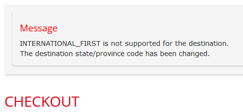

Issue 2:
When using the shipping option "FedEx International First" there is no problem so long as the shipping address is serviceable by this option.
In all other cases a warning message appears in the Joomla/Hikashop message area.
Even though everything essentially works at it should, this extra warning message has the tendency to confuse customers and can be removed or suppressed as it serves no purpose.
As a workaround I created a separate instance of the FedEx plug-in with restriction to only the appropriate destination countries.(in a specially created shipping zone)
Please refer to the attached PNG for the content of the message.
As far as I can deduct, this message comes straight from FedEx

2 years 4 months ago #360469
Thank you for your feedback on both issues.
I've made patches for these on our end. Download again the install package of the 5.0.4 on our website and install it on yours to get the patches.
