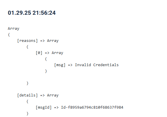

  • Posts: 4
1 year 7 months ago #365447
Thank you :-) :-) :-) It seems from the logs that something is wrong with the credentials......I'm investigating

1 year 6 months ago #366099
I did really many tests and together with DHL support from Germany, and I came out with these results.
Maybe this plugin was developed for another country (?), but to work in Germany it needs:
two additional fields for the authentication
API url is different from the pre-configured
Product codes are also different from the pre-configured
Here in short what is needed for the authentication and the correct API url:
