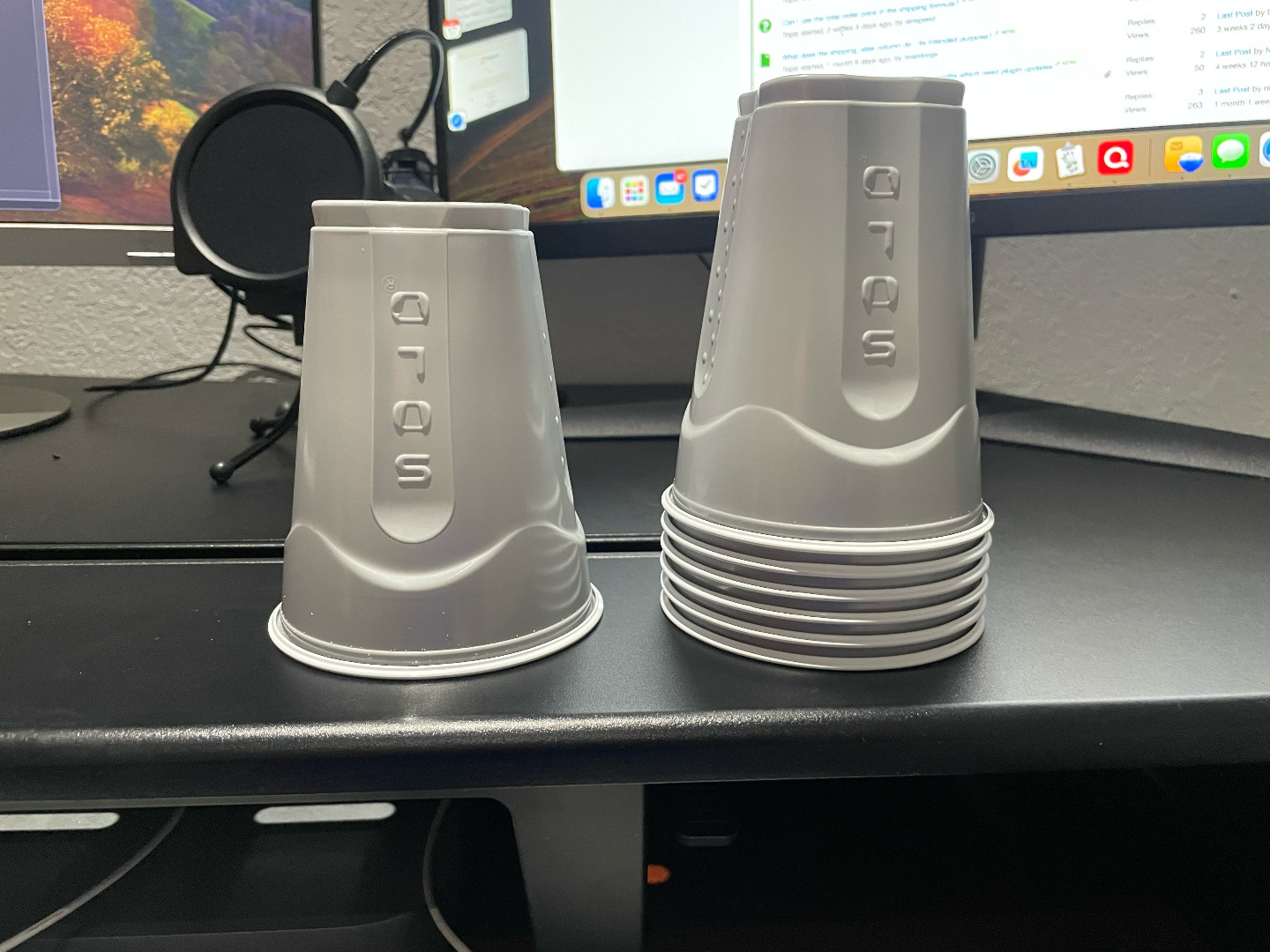

Is there a way to vary shipping dimensions based on the quantity of product ordered ?
my client sells traffic cones. For shipping purposes they are stackable. (see solo cup photo attached)
for shipping purposes the first cone might be 15"x15"x48".
because they are stackable the shipping height for 2 cones might only be 4" higher. ....15"x15"x52".
a third cone.....another 4"..... 15"x15"x56"
is there a way in hikashop to enter dimensions by product quantity to account for this packing technique ?
