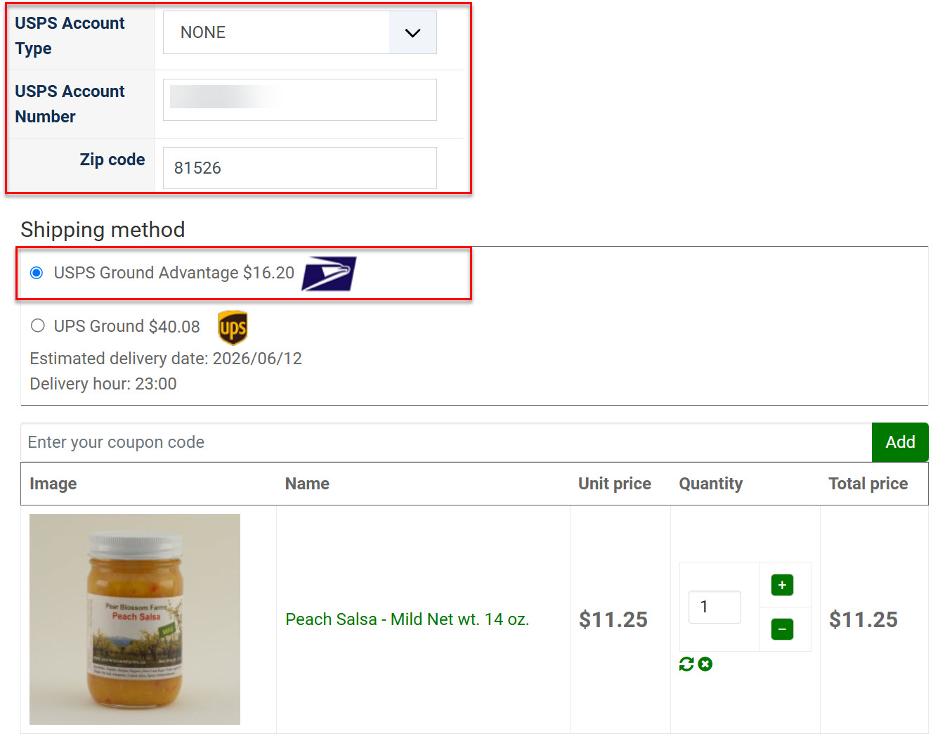

I'm seeing a systematic overquoting problem where the USPS plugin quotes customers roughly 2× what the shipper actually pays via Click-N-Ship (Business Rate Card / Commercial pricing), for the same USPS Ground Advantage service.
USPS Plugin Setup:
  • Origin ZIP: 81326 (Durango, CO area)
  • Service selected in plugin: USPS Ground Advantage only
  • Price Type: Commercial
  • Group Packages: Yes
  • Packaging weight: 0 oz, Weight approximation: 0%
  • Product dimensions entered per unit (e.g., a single jar: 4" × 3" × 3", 1.02 lb)
The problem — likely dimensional weight:
Product dimensions are entered per individual unit in HikaShop. For a multi-unit order (e.g., 12 jars), I believe the plugin packs N items using those per-unit dimensions and selects the smallest box from the configured box list that fits them.
Our box sizes:
  • Small: 12" × 10" × 12" (1,440 ci) — used for orders under 11 lbs
  • Medium: 16" × 14" × 16" (3,584 ci) — used for orders 11–32 lbs
The USPS dimensional weight threshold is 1,728 cubic inches (volume ÷ 166 = billed weight). Our Small box (1,440 ci) stays under the threshold — no dimensional weight, billed at actual weight. Our Medium box (3,584 ci) is well above it — dimensional weight = 3,584 ÷ 166 = 21.6 lb billed weight, even if the actual package weighs only 8–9 lbs.
Cross-referenced with real shipment data:
I exported 60 days of Click-N-Ship history (37 labels, all USPS Ground Advantage). Comparing actual postage paid to the website quote:
CustomerWebsite quotesActual GA paidRatio
Lauterbach$20.28$12.391.64×
Drake$35.37$14.092.51×
Hummel$33.10$8.483.90×
Kolb$25.24$10.742.35×
Steakley$16.81$13.831.22×
The "close" orders (ratio ~1.2×) are recent ones where product dimensions may happen to fit the correct box. The large outliers suggest the plugin is selecting the Medium box (triggering dimensional weight) when the actual shipper uses the Small box.
My questions:
  1. How does the plugin calculate which box to select for a multi-unit order? Does it sum per-unit volumes and find the smallest fitting box, or use a different algorithm?
  2. Does the plugin compute and send a dimensional weight to the USPS API when the selected box exceeds 1,728 ci? Or does it always send actual weight?
  3. Is there a way to set a fixed box size per product (rather than having the plugin compute from per-unit dimensions) so it always requests the rate for the box the shipper actually uses?
  4. Is the plugin currently using the new USPS API? I saw a March 2025 forum thread where Nicolas mentioned a new plugin was being developed to replace the old Web Tools API (retired January 25, 2026). We're now in May 2026 — is there an updated plugin I should install?
Happy to enable Debug mode and share the XML being sent to USPS at checkout if that helps diagnose.
Thank you.

2 months 3 weeks ago #372098
Thank you for the detailed explanation — very helpful. Here is the concrete example you asked for, plus a follow-up question about upgrading.
Concrete order: Kolb (Order E2D1K94, 2026-05-10)
Product in cart:
  • Name: Dad's Green Jalapeño Sauce Case - 12 bottles
  • SKU: PBFR-12-SAU-GRN-R
  • HikaShop stored dimensions: 16.000 × 12.000 × 9.000 in (volume = exactly 1,728 ci)
  • HikaShop stored weight: 8.640 lb
  • Quantity ordered: 1
Destination ZIP: 83702 (Boise, ID)
Origin ZIP: 81326 (Bayfield/Durango, CO)
HikaShop quote at checkout: $25.24 (USPS Ground Advantage)
Actual paid via Click-N-Ship Business Rate Card: $10.74 (USPS Ground Advantage)
Ratio: 2.35×
Plugin settings at time of order:
  • Group packages: Yes
  • Weight approximation: 0%
  • Has nonstandard characteristics: OFF
The edge-case question:
The product dimensions (16 × 12 × 9) produce a volume of exactly 1,728 ci — the precise USPS DIM weight threshold. When the plugin sends these dimensions to the USPS API, does USPS apply dimensional weight at exactly 1,728 ci (i.e., does it use ≥ 1,728 or > 1,728)? If DIM weight is triggered: 1,728 ÷ 166 = 10.41 lb billed weight vs 8.64 lb actual. That alone is a modest ~20% difference and would not explain the 2.35× overquote. So something else is inflating the rate further — possibly a zone or price-type discrepancy in what the API returns. The Debug output would presumably show this — happy to provide it if that helps.
Note: these product dimensions are the actual case dimensions (the product is sold as a 12-bottle case), so the stored dimensions already reflect what goes on the scale. The stacking logic for quantity=1 is irrelevant here.

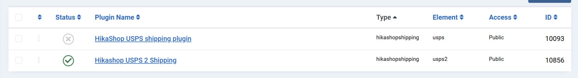

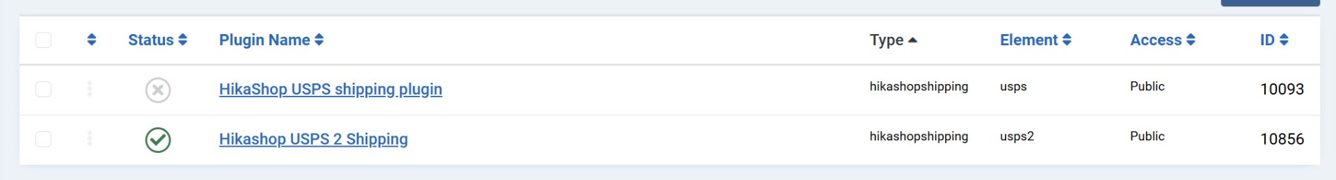

Edit: I should clarify the plugin setup. I have two USPS plugins installed: the original built-in one (element: usps, ID 10093 in my installation) which is disabled, and the new marketplace plugin (element: usps2, ID 10856) which is active — purchased in February 2026. All quotes, including the Kolb example above, are coming from the new marketplace plugin running on the current USPS API.

2 months 3 weeks ago #372103
Thank you for the very detailed example. It actually points straight at the cause, and it is not the packing or dimensional weight.
On the dimensional weight edge case first, so it is out of the way: for Ground Advantage, USPS only applies dimensional weight to parcels that measure more than one cubic foot (more than 1,728 cubic inches), and only for zones 5 to 9. Your case is exactly 1,728 ci, which is the threshold, not above it, so dimensional weight does not trigger at all here. The package is rated on its actual 8.64 lb. So DIM weight is not what is inflating your quote.
The real cause is the price tier the plugin is asking USPS for. The new plugin has a "Price type" setting with three values: Retail, Commercial and Contract. You have it set to Commercial, so the USPS API returns the published Commercial Base price. The rate you actually pay through Click-N-Ship Business (your Business Rate Card) is not the published Commercial price, it is account specific negotiated pricing, which USPS exposes through the API only under the Contract price type, and only when you identify your account.
So the fix to try is:
- In the USPS plugin settings, set "Price type" to Contract.
- Fill in "Account type" with the type that matches your USPS account (EPS, PERMIT or METER, EPS being the usual one for a Click-N-Ship / online account).
- Fill in "Account number" with your USPS account number.
With those set, the plugin sends your account details to USPS and the API returns your account's contract pricing instead of the generic Commercial price. That is what should bring the quotes down to what you actually pay on the label. If your Business Rate Card is tied to that account, Contract is the price type that surfaces it.
To verify exactly what each price type returns for a given order, enable Debug mode in the plugin and place a test order through checkout. The payment log file in the HikaShop configuration page will show the request sent to USPS and the prices returned, so you can compare Commercial vs Contract side by side for the same parcel.
On your example numbers, a $25.24 Commercial quote versus $10.74 Business Rate Card is exactly the kind of gap you would expect between published Commercial and account contract pricing, so this is very likely the whole story.

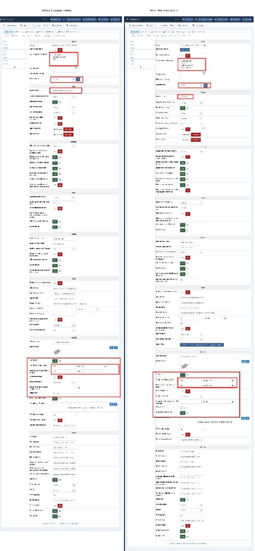

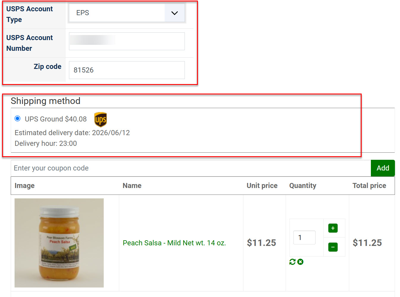

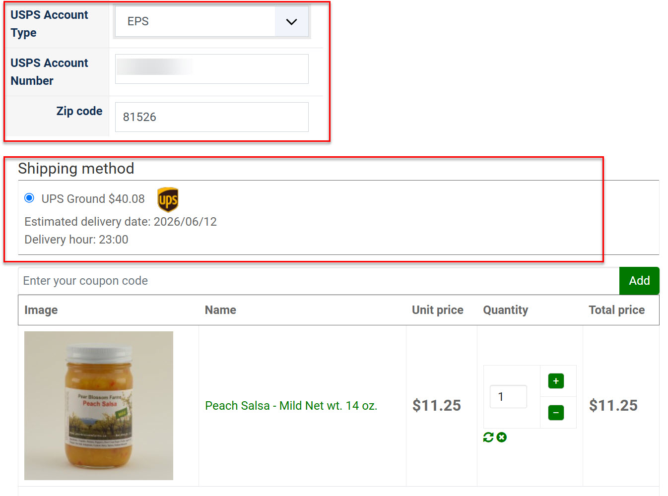

  • Posts: 214
  • Thank you received: 7

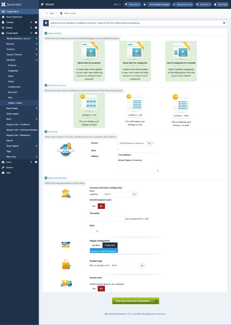

2 months 3 weeks ago #372123

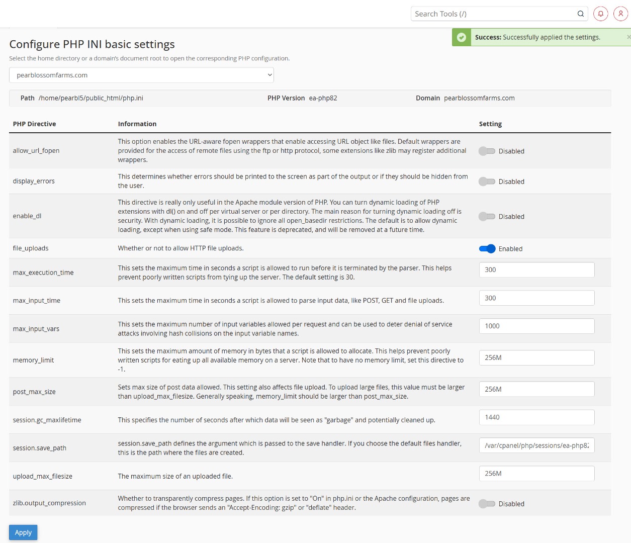

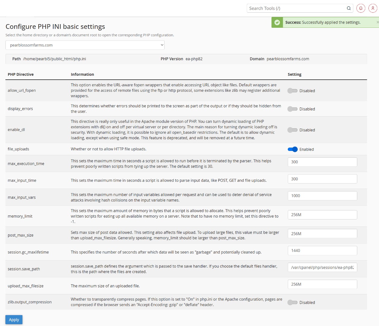

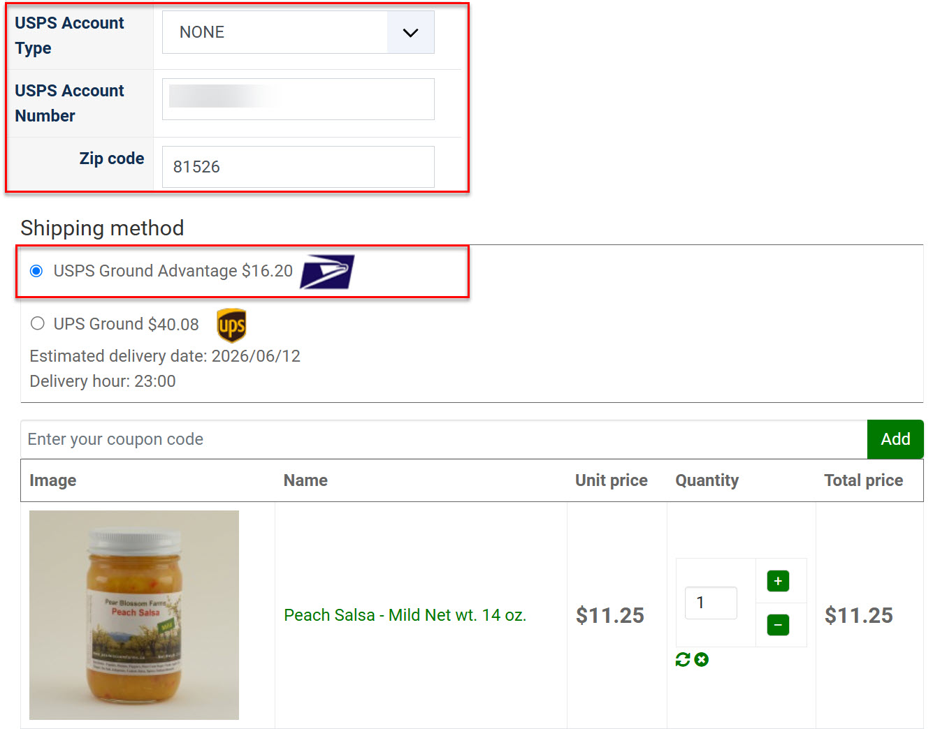

I have edited the USPS plugin according to your guidelines. I am about to test it, but in the meantime I also tried a final upgrade of Hikashop pro on a clone of the website.

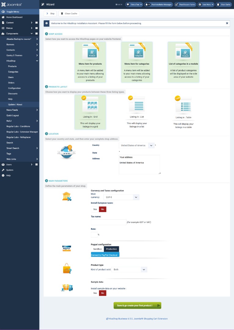

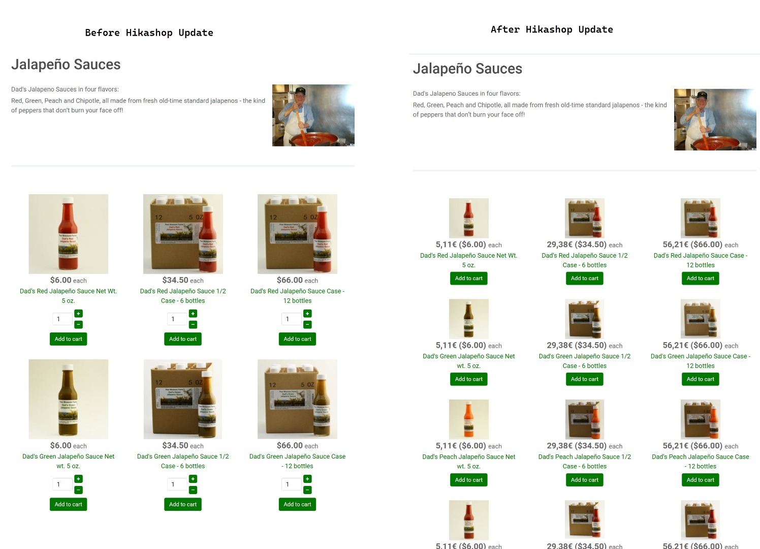

Update on the upgrade question:
I tested the 6.1.0 → 6.4.1 update on a cloned subdirectory with the following PHP settings (screenshot attached):
  • max_execution_time: 300
  • max_input_time: 300
  • memory_limit: 256M
  • PHP version: ea-php82
PHP Configuration
The installation wizard did not appear this time, which is progress (I attached the one that appeared the first time around for reference).

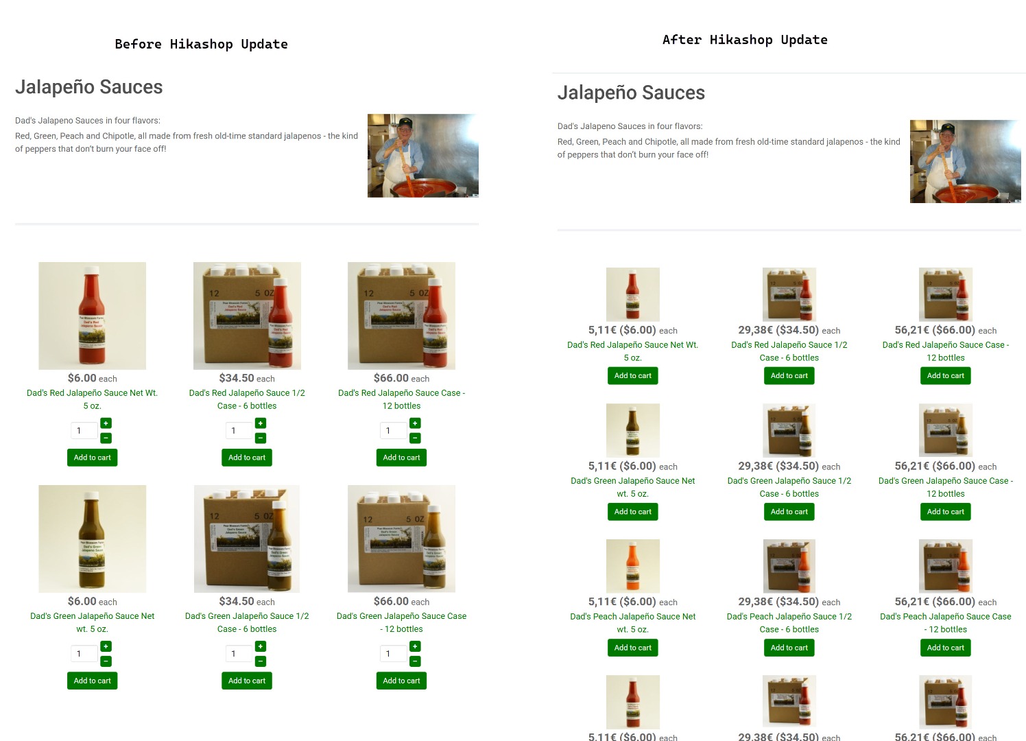

However, the same configuration fields were reset:
  • Currency: reverted to EUR (was USD)
  • Store address: cleared
  • Tax zone: reverted to Europe
  • Image thumbnail dimensions: reset to 100px (were 200px)
Image file links were preserved — products still show their images, which is an improvement over previous attempts.

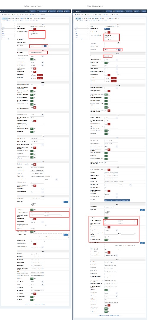

Since the wizard did not run, the reset appears to be coming from the update process itself reinserting default values into the hikashop_config table, rather than from the wizard overwriting it. Is that correct? Is there a specific step or setting that controls whether the update rewrites config table defaults, and is there a way to prevent it?
Screenshots of before/after configuration attached.
Front End Comparison (Before > After)
Configuration Fields reset (before > After)

2 months 3 weeks ago #372125
There is no such step or setting because this is not supposed to happen and it doesn't happen for anyone else when updating their HikaShop.
What's likely is that you have a problem with the hikashop_config table which leads to the update system behaving in an unexpected manner.
Try clicking on the "Check database" button on the configuration page of HikaShop. Does it says anything about the hikashop_config table ?

I am just about to perform the SQL fix you outlined (I came down with the flu and I haven't had time to get around to it).
The last thing I did before the SQL was to change the USPS account type from NONE to EPS.
When I changed it to EPS, the USPS plugin stopped showing in checkout, as you can see in the screenshots I uploaded.
Frankly, I am still very ill and I cannot remember where I got the USPS account for the "USPS Account Number". Is it possible that I haven't configured the account properly or that the number is wrong?
I am going to go fix the SQL right now and I'll post back when I am done and I no longer see an error in the backend.

Follow-up: Clone test results — config table fix + 6.x update
Following the guidance in this thread, I ran a full test on a subdirectory clone before touching the live site. Here is a detailed summary of what was done and the current state.
Starting state of the clone
  • HikaShop version: Business 6.1.0
  • Joomla version: 4.4.14
  • PHP: ea-php82, max_execution_time: 300, memory_limit: 256M
  • Database: separate clone DB (same table prefix: ajx70_)
  • Active shipping plugin: HikaShop USPS 2 Shipping (usps2, v1.5.6, purchased Feb 2026, extension_id: 10856)
  • Old built-in USPS plugin (usps, extension_id: 10093): present but disabled

Step 2 — HikaShop update (applied before the SQL fix)
The HikaShop update was installed via Joomla Extension Manager on the clone. The SQL fix in Step 1 was applied afterward to the already-updated database.
Manifest cache for the bundled USPS plugin after update:
{"name":"HikaShop USPS shipping plugin","version":"6.5.0","creationDate":"01 06 2026"}
Config values immediately after update:
  • Currency: reset from USD to EUR
  • Store address: cleared (was 3076 C Road, Palmdale CO 81526)
  • Tax zone: reset to Europe
  • Image thumbnail dimensions: 200px → 100px
  • Product image links: preserved (improvement over a previous test)
Note: since the update ran before the SQL fix, we cannot conclude from this test whether the primary key fix would have prevented the config reset. A fresh clone test — with the primary key added before running the update — would be needed to answer that. What we can say is that the update installer is writing default values that overwrite existing settings.

I queried the extensions table to check plugin state:
SELECT extension_id, name, type, element, enabled, manifest_cache
FROM ajx70_extensions
WHERE element LIKE '%usps%';
Results:
  • extension_id 10093 | HikaShop USPS shipping plugin | usps | disabled | version 6.5.0 (updated with HikaShop)
  • extension_id 10856 | HikaShop USPS 2 Shipping | usps2 | enabled | version 1.5.6 (not updated — marketplace plugin)
The shipping record in ajx70_hikashop_shipping is intact (record exists, params present, published: 1). The error is not caused by a missing record.

Thank you, that is an excellent write-up, and it lets me answer precisely. The short version is that everything you saw traces back to the missing primary key, and your P.S. plan is the right one.
1. Config values being reset by the update
The update installer is not overwriting your settings on purpose. HikaShop saves the configuration with a single REPLACE INTO query on the hikashop_config table, and REPLACE relies on the primary key on config_namekey to decide whether to update the existing row or insert a new one. When HikaShop reads the configuration back, it indexes the rows by config_namekey and, if a key appears more than once, the last row returned by MySQL wins.
With the primary key missing, REPLACE had nothing to match on, so it behaved like a plain INSERT: every save and every update appended a brand new row, including the default values written during the update. On the next read, the newest row (the default) won. That is the single cause of both the 35,162 duplicate rows and the settings looking wiped (USD to EUR, address, tax zone) after each update.
So you do not need to re-enter the values after every update. Once the primary key is back in place, REPLACE updates the one existing row per setting, and the values stick across updates. The resets you observed happened during the update you ran before the key was added, which is expected. The clean way to confirm the fix is exactly your P.S. plan (see the end).
