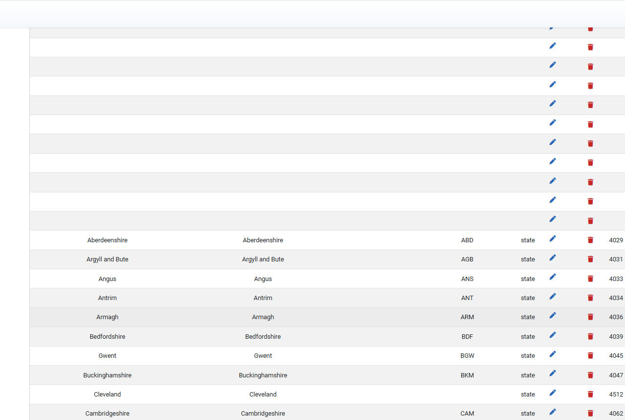

Hi, In my main shipping Zone list, there over over 50 blanks which I cannot get rid of? how can I get rid of them? deleting does not seem to work?

Thank you for your feedback on this. We looked into it a made a fix for it. Download the install package of HikaShop on our website and install it on yours in order to get the patch.

Hi, That cleared them out thanks.
