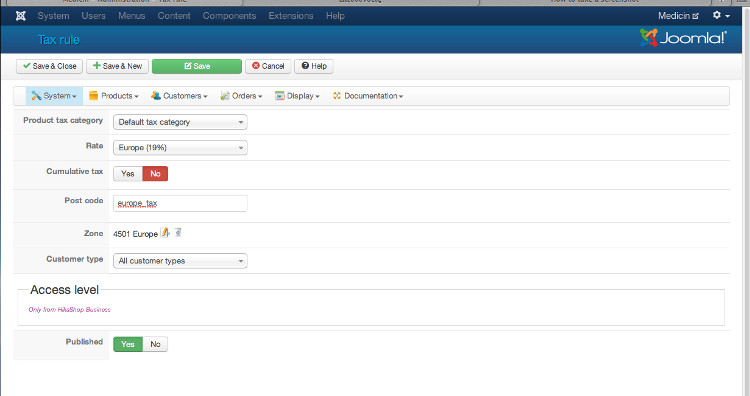

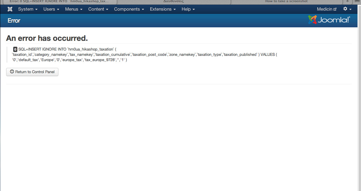

I can't create tax rules. When I tried, an error message appeared (after the click on the save button):
SQL=INSERT IGNORE INTO `hm0ua_hikashop_taxation` ( `taxation_id`,`category_namekey`,`tax_namekey`,`taxation_cumulative`,`taxation_post_code`,`zone_namekey`,`taxation_type`,`taxation_published` ) VALUES ( '0','default_tax','Europe','0','europe_tax','tax_europe_9728','','1' )
Hikashop version: 2.2.3 essential
Joomla version: 3.2.1

12 years 7 months ago #138160
It's the same problem. You updated HikaShop and a column in the database could not be added properly. Please follow the documentation here to add it manually and it will work:
www.hikashop.com/support/documentation/6...lity-issues.html#SQL
