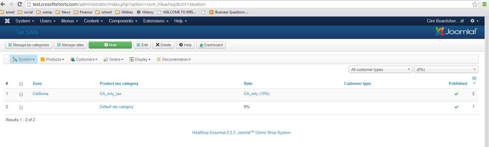

12 years 4 months ago #148618
Mohamed Thelji,
Thank you for your reply. I've already done that and it does not seem to work. please view the screenshot attached.
Am I missing something else?
Thanks,
Todd
Last edit: 12 years 4 months ago by benrud.
  • Posts: 86050
  • Thank you received: 14178
12 years 4 months ago #148649
In your tax rule, you selected the product tax category called "CA_only_tax". This means that the tax will only apply to the products in the tax category "CA_only_tax". I suppose that all your products are in the tax category called "default tax category" which is why you don't see the tax on your products.
