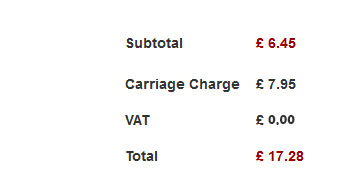

I have a shop up and running which was originally for UK only. However the client is now intending to supply the Chanell Islands & Eire. They do not pay VAT and this has been set up as 0%.
The issue I need to overcome is that with 0% the VAT/TAX line disappears from the cart. On the first attachement it shows a price with VAT the second has no VAT and I would like to show it as VAT: 0.00. Currently that line is missing if zero rate VAT is applied

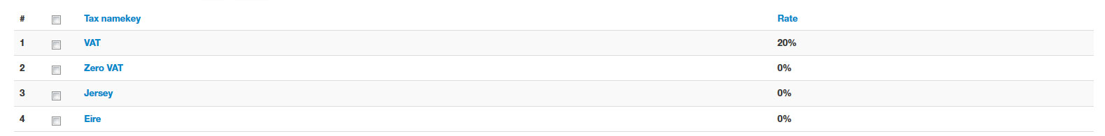

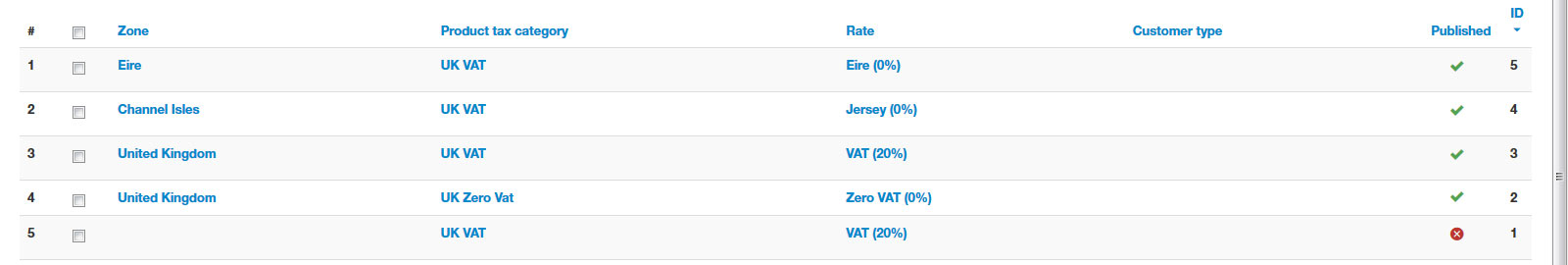

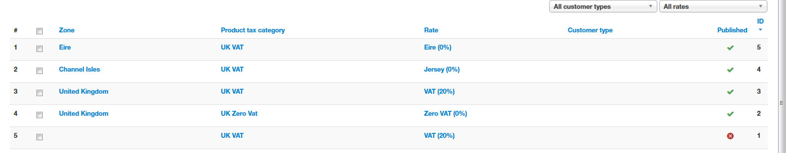

I have attached a couple of screenshots. One is for Tax rates and the other for Tax Rules. I am pretty sure these have been set up correctly!
The Channel Islands and Eire do not pay VAT on goods brought from the UK so the rate has been set as 0% as you will see from the attachments. As per my original post the Tax/VAT line is not shown on the cart/checkout page. I would like it to show as per the attachment tax display 2
Dave
11 years 11 months ago #173026
I just made the changes as explained, there was just two missing php tags in the given code.
So it seems to be working as expected. ;)
ps: I edited the previously given code with the correct php tags.

the Channel Islands and Eire are set up to work with the UK product tax category. This is how Im understand it to work. I have attached 2 screenshots. More than happy to activate admin access so that you can conifirm these have been set up correctly?
Dave
11 years 11 months ago #175127
This seems to be set up correctly.
As the tax rate is 0% so we go in the else condition I gave you earlier and the 0 VAT should be displayed, I tried on my end and it seems to be working fine.
