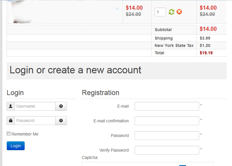

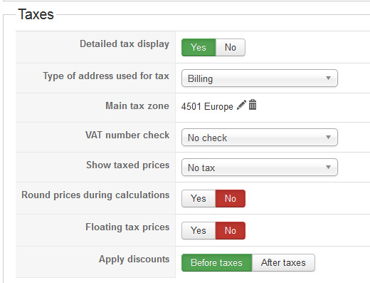

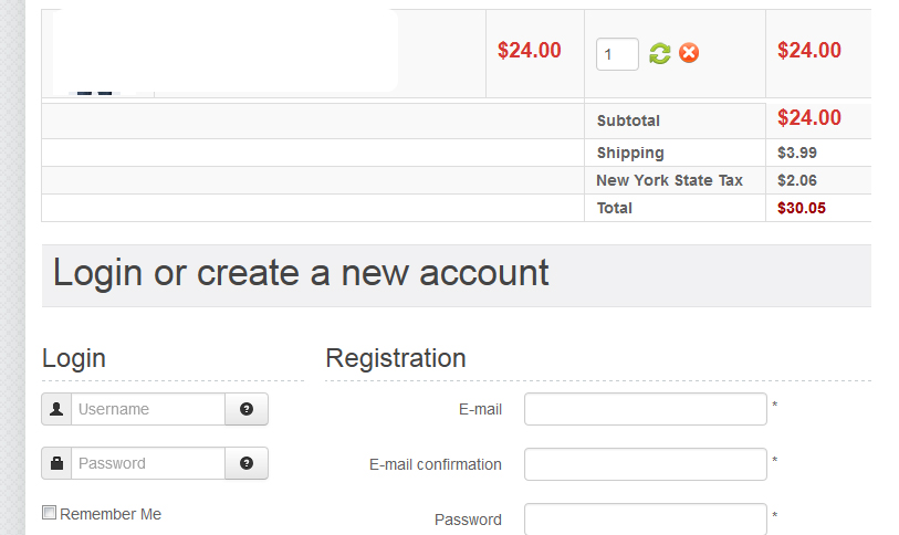

It looks like it works properly with the address... but that is not the main issue.
My problem is that it automatically shows added NY State taxes on everything. If you are in another state for which taxes should not be charged it looks like you have to pay additional taxes... very bad for business.
To test it I made the main tax zone Europe closed the browser, ran ccleaner, cleared cookies on fire fox and the results are the same. At checkout before any info is imputed is already adding NY state taxes.

Hi, it is working properly now, it had to be the cache. I put everything on just one category and fixed the main tax zone like you suggested. Thank you
