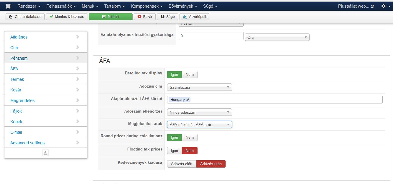

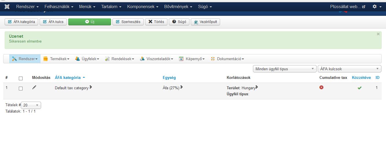

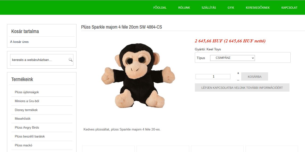

  • Posts: 10
11 years 5 months ago #193405
This is the problem (attachments)
The price excluding VAT

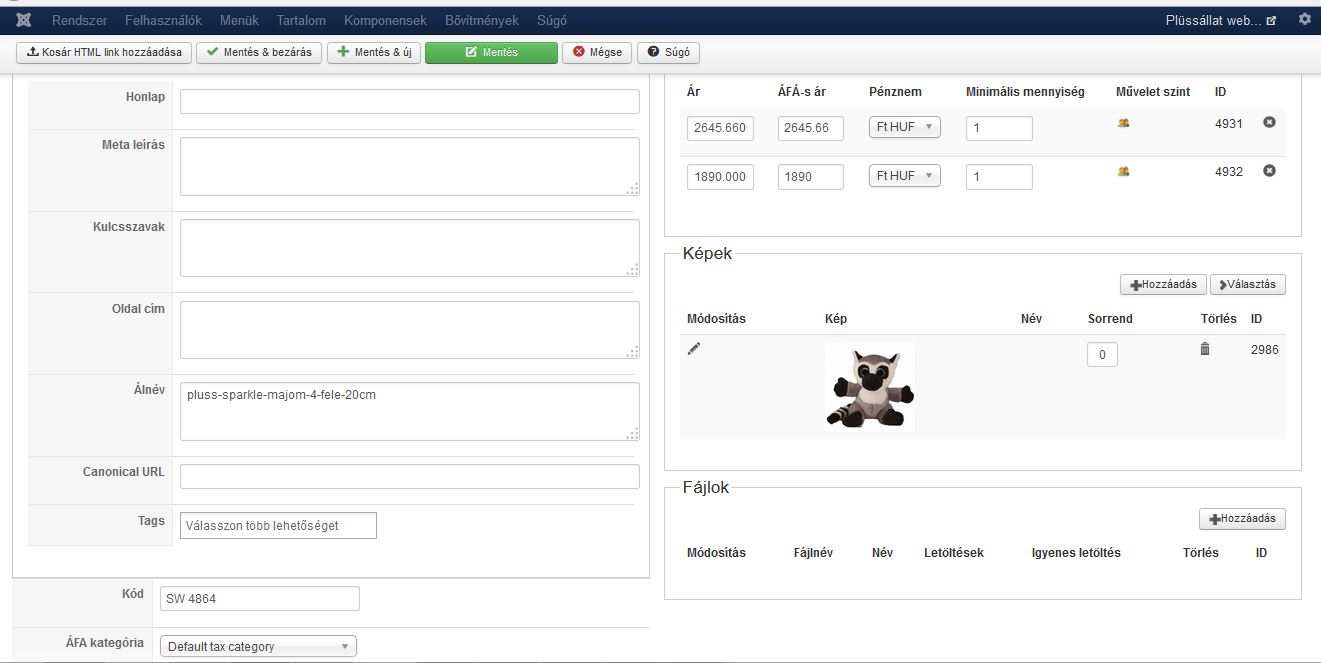

  • Posts: 86050
  • Thank you received: 14178
11 years 5 months ago #194584
Make sure that you select a tax category in your products. And make sure that you delete the "customer type" selection of your tax rule.
It will then work properly.
I've done it for you for that product and it is working:
