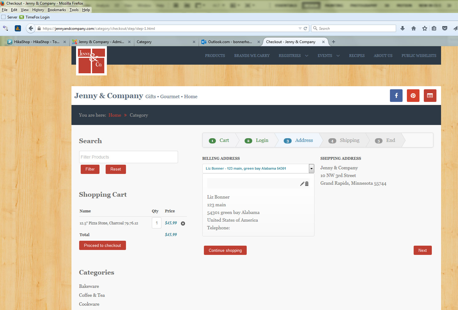

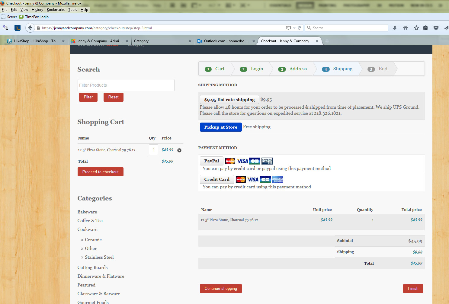

1. If I checkout with a Minnesota shipping address, tax is applied correctly. If I checkout using pickup, tax is not applied. Pickup is in Minnesota.
2. If I checkout using an billing address in Alabama, it does not give me the choice to use pickup. I have set the config to using type of address for tax : shipping.

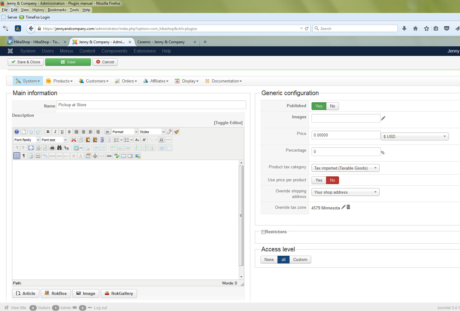

In that case, you want to select minnesota in the "override tax zone" setting of your shipping method.

That did not work, still no tax applied.
Please see attachments. Note that I have also tried the Restrictions.
If a user chooses Pickup, they need to be taxed. Because the shipping address is Minnesota.

I've checked your website and it came from the zones you used. You had created a minnesota tax zone.
I've replaced it in both your tax rule and your shipping method by the minnesota state zone and it's working.

No, in the "zone" setting of your tax rule and in the "override tax zone" setting of your shipping method, you had selected a tax zone called minnesota, instead of selecting directly the minnesota state zone.
