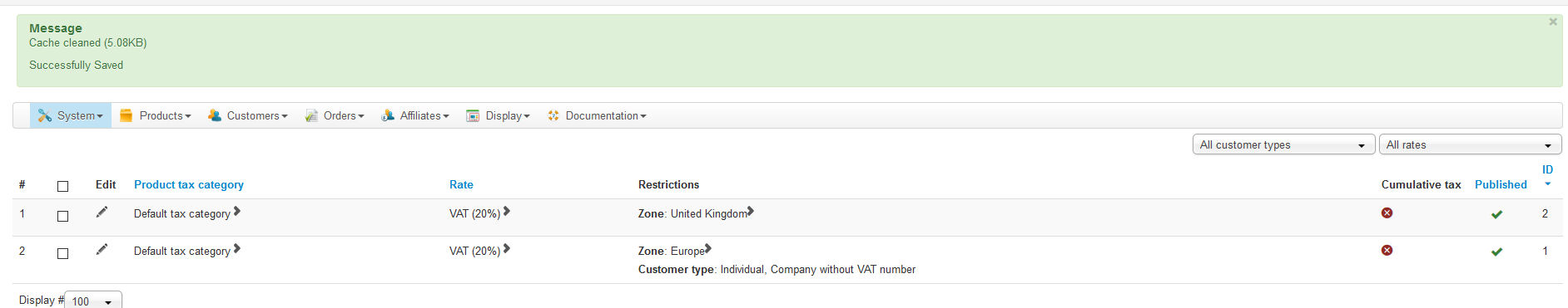

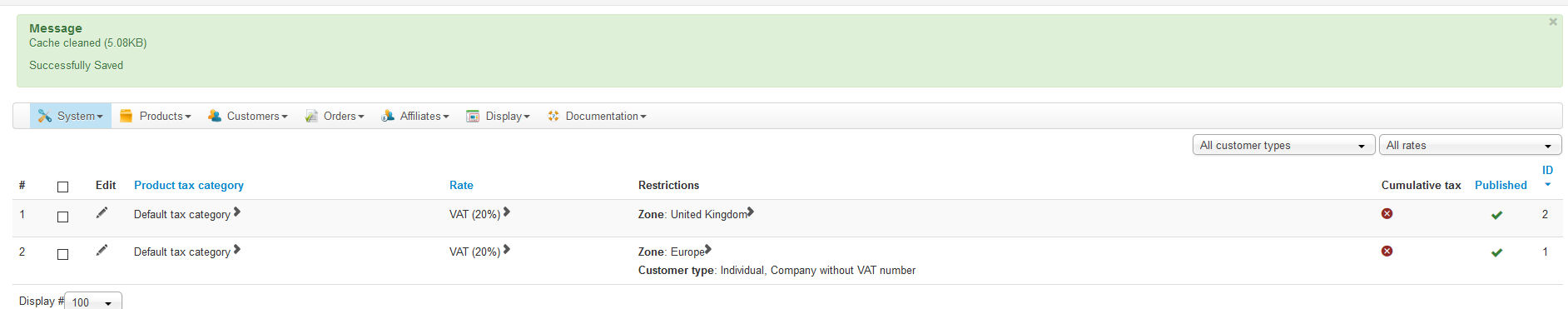

Hi, I am struggling to make this work correctly for European VAT registered businesses. I have tried various options bases on the previous thread without success.
The end goal is;
All UK pays 20% VAT
EU individuals & businesses pay 20% VAT
EU VAT registered businesses with a valid VAT number pay 0% VAT
I have followed the previous thread but exchanged Italy for UK but cannot get Hikashop to add or remove the VAT as required for the Europe? is there another setting I am missing somewhere?
thanks
  • Posts: 86113
  • Thank you received: 14210
10 years 10 months ago #218834
No, it should be quite simple, with just two tax rules:
- one for the UK country zone with your 20% tax rate for the default tax category
- one for the Europe tax zone (remove the UK from it) only for the type of clients individual and company without vat number, again, with your 20% tax rate for the default tax category
Then, make sure that the address_company and address_vat fields are activated and that the products as assigned to the default tax category and that should be it.

Yes that is one of the ways I have tried to get this to work as I would have expected this to be the preferred method. The problem appears to be that 'individuals' in the Europe zone allow purchases to be tax free which is incorrect, the only way I can get the cart to charge VAT for individuals in Europe is to select 'all customer types'

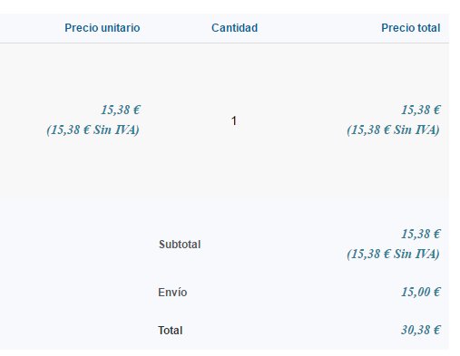

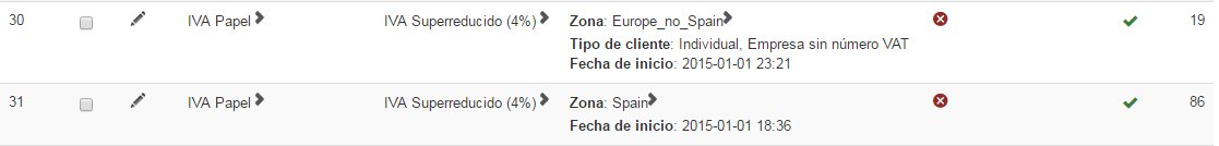

Hi Nicholas, I have the same problem.

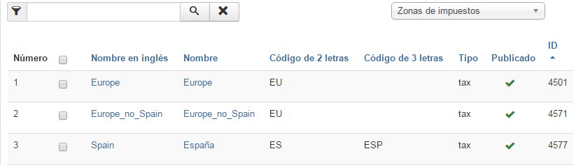

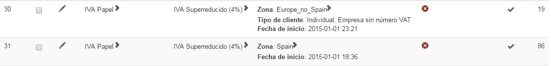

My configuration:
Address used for taxes: Billing Address
2 Taxes: Same Category, Same Tax rate, 2 diferent zones:
  1. Europe no Spain: Individuals, Companies without VAT number
  2. Spain: All customer types
But when I use a French or Italian billing address at checkout, VAT don't apply.
Where can I look my "default customer type" configuration? because I can't find it at Hikashop Configuration
Thanks in advice

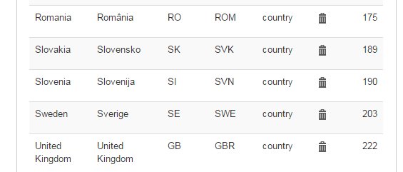

If it works fine for Spain but not France, it's likely that the problem comes from the way you setup the Europe_no_spain zone.
Make sure that it is of the type "tax zone" and that it contains the countris you want as "sub zones".

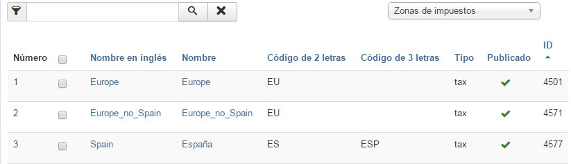

  • Posts: 79
10 years 5 months ago #234824
I have done my "Europe_no_Spain" zone by copying your "Europe" Tax zone and removing Spain from subzones list.
Even, I created a new Spain Tax zone by copying Spain country zone to apply only to spanish customers, but VAT still doesn't apply to customers of rest of Europe
